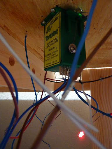

I installed the first Tortoise switch today. As ever after some digging around on Google I found how to power route the frog and have the switch control the LED too.
I'm still waiting for the Cobalt switches I ordered to arrive, it's been 11 days now... anyway, I have another 2 Tortoise so I will be getting those installed tomorrow, hopefully now I've done one, the others will be easier.
As you can see I need to tidy up my wiring too. I can see now why nobody likes doing work under the benches...

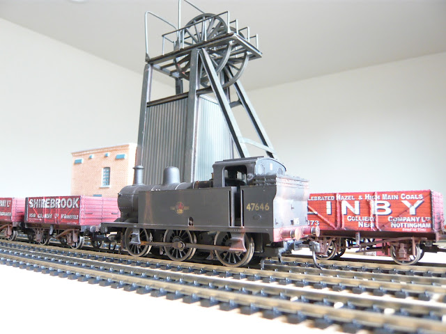

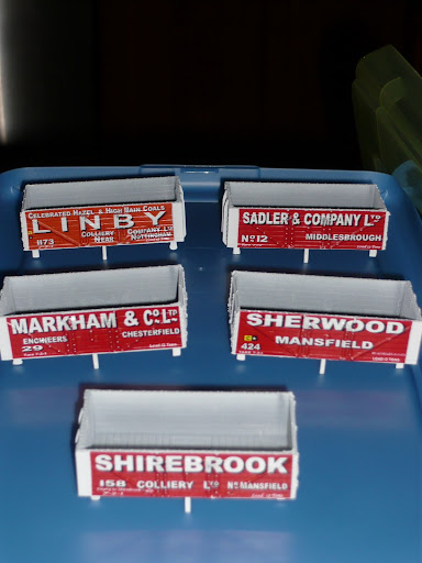

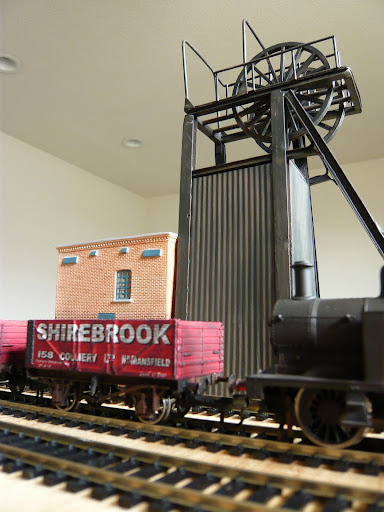

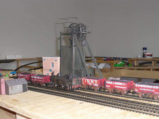

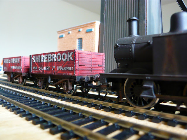

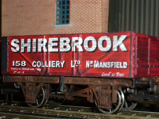

I got off work early today, which was nice, so I spent a couple of hours finishing the coal wagons I got from Dapol.
I ordered 5 transfer sets from Robbies Rolling Stock from the East Midlands selection of collieries around Notts/Derbyshire
I only buggered up one side and I managed to hide that with the weathering powder... wink.gif

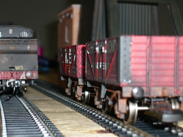

Once I painted the wagon bodies I gave the chassis (multiple) a dose of AIM weathering powder in Light Rust and Dark Earth. I assembled the wagons minus the wheels and sealed it all with a gentle coat of Testors Dullcote.
The end result is shown below, the flash has a tendency to over saturate the colours, so if it looks a bit too orange, the real thing doesn't look bad.
Any comments? Anything I've missed?

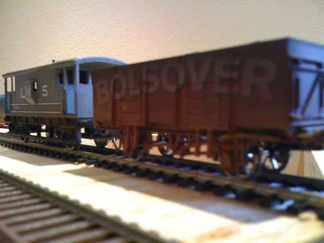

I also applied some Robbies Rolling Stock transfers to some Dapol 7 Plank wagons.
As you can see I need to now paint the rest of the wagon body.
I was quite impressed how they came out.

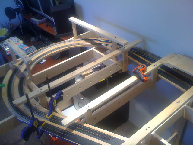

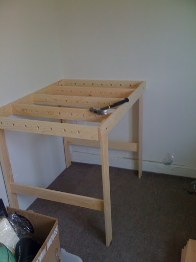

The baseboard (benchwork for USA) I cheated somewhat. I purchased some modular units from Sievers Benchwork here in the USA. They really are fantastic, it would have taken me months and months to achieve about 50% of the quality of these units and I really don't have the time or facilities to carry, saw, plane & drill yards and yards of wood.
The plywood for the sub-roadbed and major areas is 3/4" and the risers are a mix of 1x2" and 1x4"
This is a picture of the first 4x3ft module assembled.
and this is what the completed 9x9ft benchwork looks like, you can also see the start of the hidden return loops on the bottom. You can see the benchwork is pre-drilled to make running cables really easy.

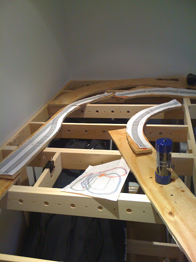

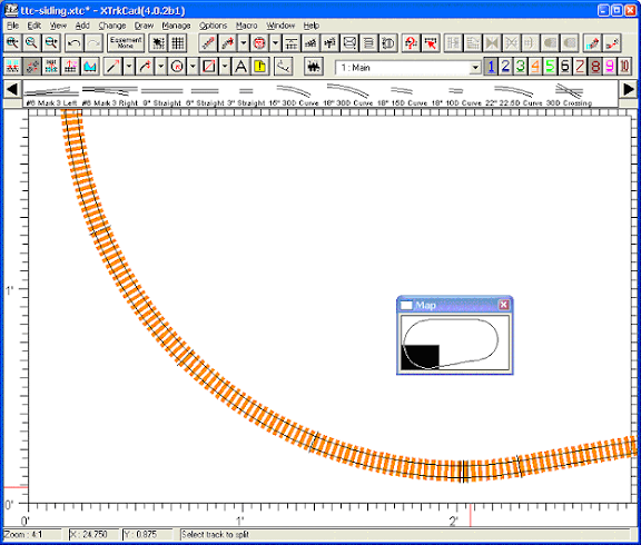

In this next photo you can see the scale print outs I used to help me cutting out the plywood. The program I used was the excellent FREE XtrackCAD which is an Opensource application that will run on PC and MAC.
There is a bit of a learning curve, but I like the way you can print out your finished plan 1:1 so you can fix to your baseboard and cut. That saved me a lot of time with measuring and marking.
Here is a screen shot of XtrakCAD

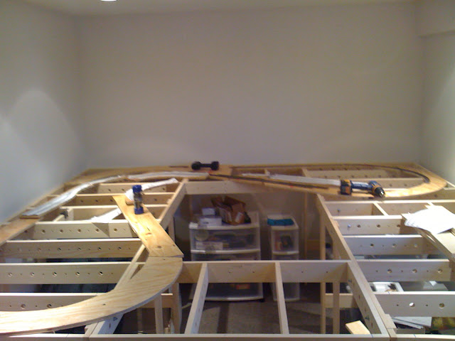

I continued cutting up sheets of 8x4ft plywood and in the end I used 4 sheets. I probably could have got away with 3, but as I've said before this is all new to me so a few mistakes are allowed. biggrin.gif
I had to wrestle with a fair few bad sheets in Home Depot, the quality control doesn't seem to be very consistent. Perhaps for my next layout I will go for a better quality... anyway, it's all in place now after several days worth of measuring, cutting and fitting and a few boxes of screws. I'm very glad I bought an electric screwdriver.

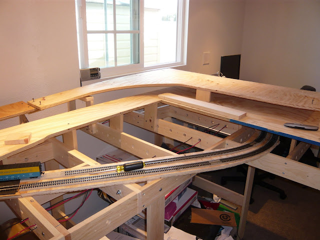

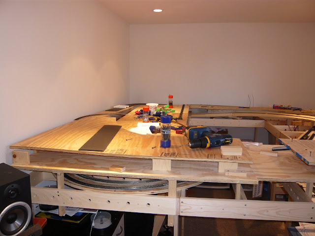

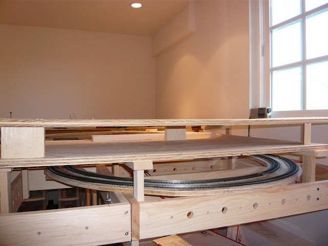

You can see the 3 levels in this picture here.
The hidden return loops and staging on the bottom, the middle section on this side of the layout will be in a tunnel, the goods yard and MPD off to the left and the yet to be built colliery section off to the right.
The very top section on this side is where the station is going to be. There is just enough room to fit a Duchess with 5 coaches, more would have been nice but there you go, I needed to use the rest of my garage for conventional garage stuff.
As you can see there is still a gap I need to fill in.

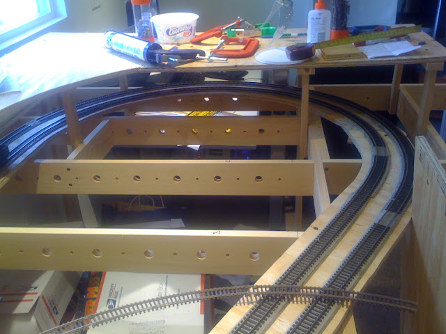

This picture below shows the view from the operators area. You can see the UP return loop and staging also the first section of track I laid. I tried out several types of underlay (roadbed as it's called here.) There is a product here called Homabed made from recycled newspaper. It had good sound deadening qualities, but some of this was negated once it and the track was glued in place.
I've also tried the Woodland Scenics trackbed product. It was easy to install, sounds good and is cheaper, so that is what I will be continuing with. The Homabed is grey in this picture and the Woodland Scenics stuff is black.
They both have a good angled edge to give a good representation of a shoulder when ballasted.

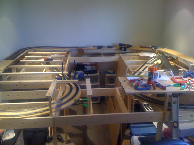

Here are some more construction shots showing various stages of the build.

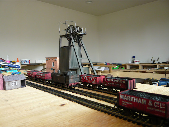

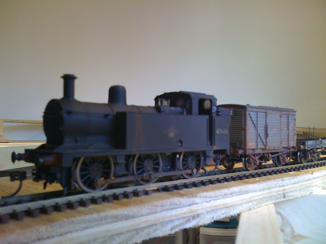

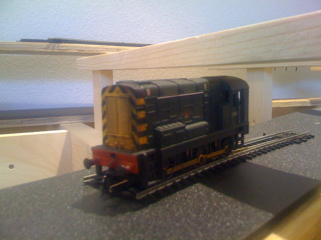

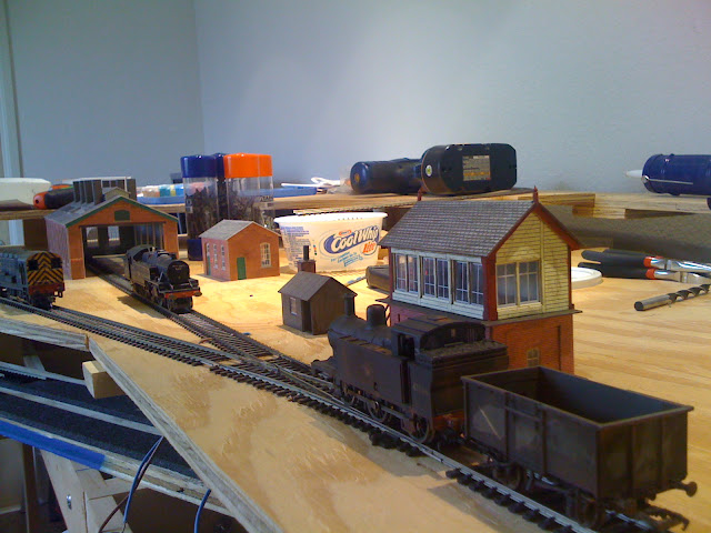

Here are a selection of pictures showing my attempts at weathering some of my models:
Class 08 showing tight clearance in the hidden loop
Jinty with mixed goods

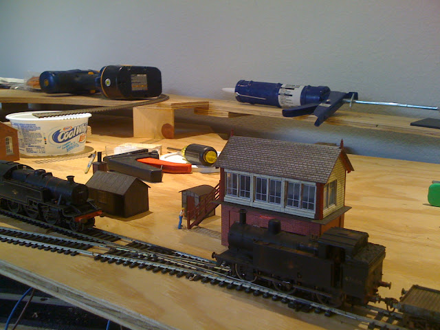

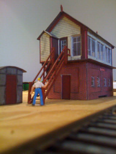

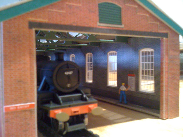

Here you can see the Metcalfe signal box that I have painted the woodwork into a Midland red and dirtied it up a bit. Since taking this I've added guard rails and rain gutters/downpipes.
Another pic showing the weathered Jinty and the signal box.
I need to tone down this blokes trousers and yellow hair !!!
This one shows the engine shed before weathering and painting. There's that bloke again reading the notice board.

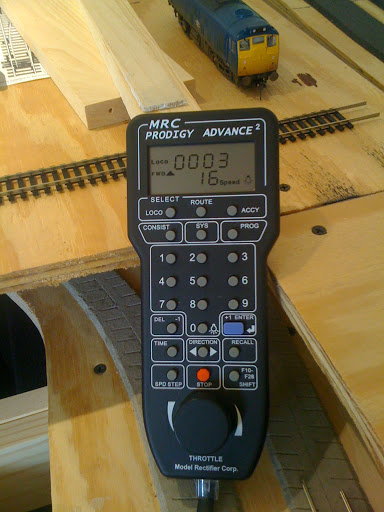

Lastly this is the DCC system I'm using, it's sold as the Gaugemaster Prodigy Advance in the UK. I'm still learning how it all works.
