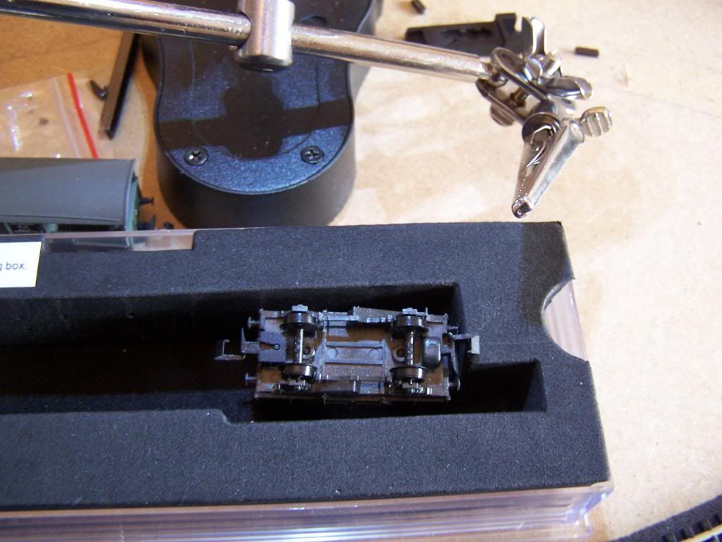

First under the knife was a Peco wagon kit, purchased so I could practice without destroying anything cherished or expensive. The conversion pack includes a jig to ensure correct alignment, which works well with a fixed wheelbase wagon. I didn't photograph the conversion but here's the result:

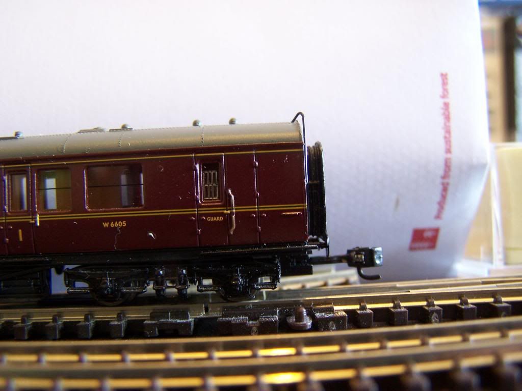

Converting the van went so well I decided to have a go at a Dapol Collett coach. The jig wasn't quite as helpful this time but it looked like the NEM mounting box would directly replace the existing coupling.
This was my first attempt, slightly too high but not so much as to impair operation:

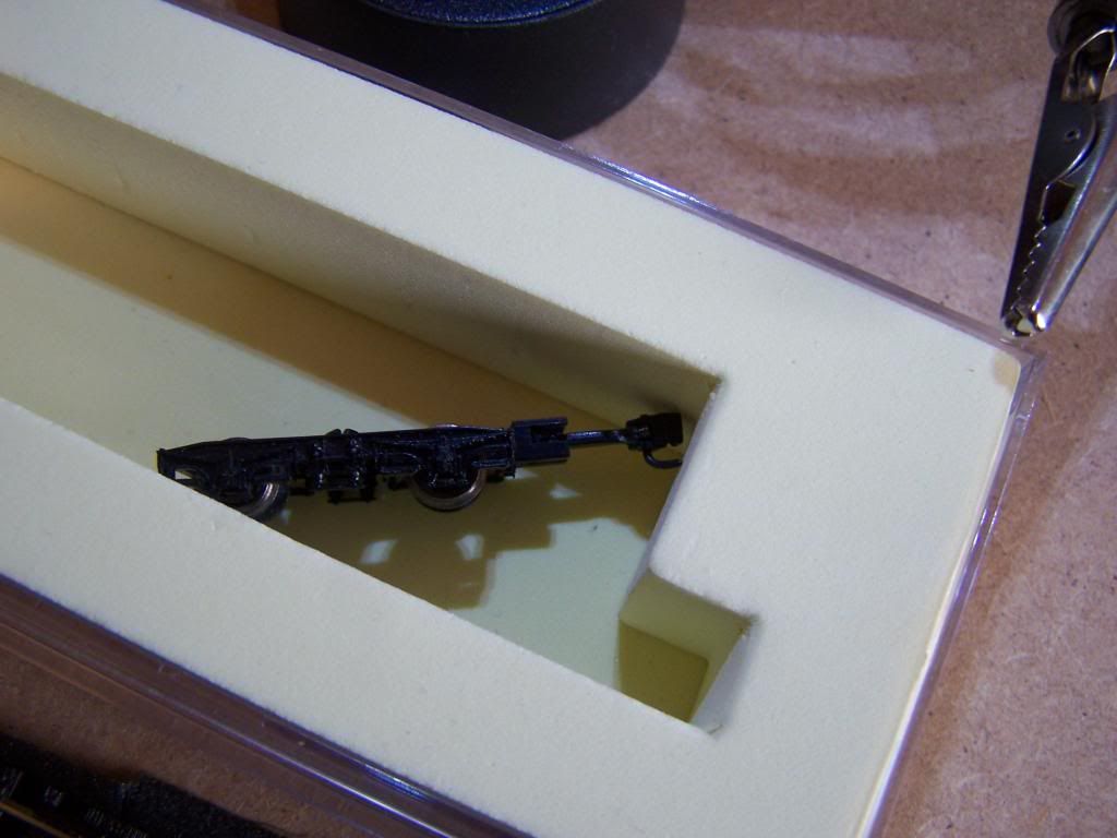

The conversion process went something like this:
The bogie, removed from the coach, axles removed along with the brass spring that supports the Rapido coupling.

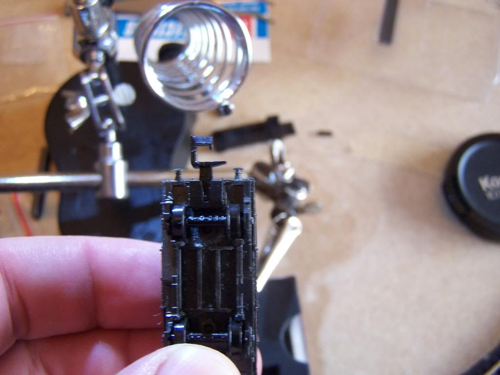

The existing coupling sliced off
The area made as flat, level and square as possible
