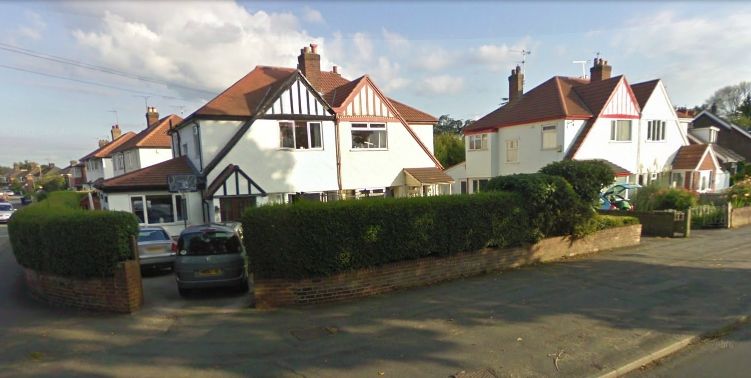

I have been continuing to look around at the various houses I pass, and have decided the roof will be Red Tiles (Basically a Red-Oxide Colour) as these are quite common on houses that seem to be from the same period as this one.
Incidently, there are some Semi-detached houses in Upton that are very much the same as the Metcalfe semi kits.
Some of the "Metcalfe" Houses in Upton, Chester.
OK, so a bit Off Topic, but they are houses!
