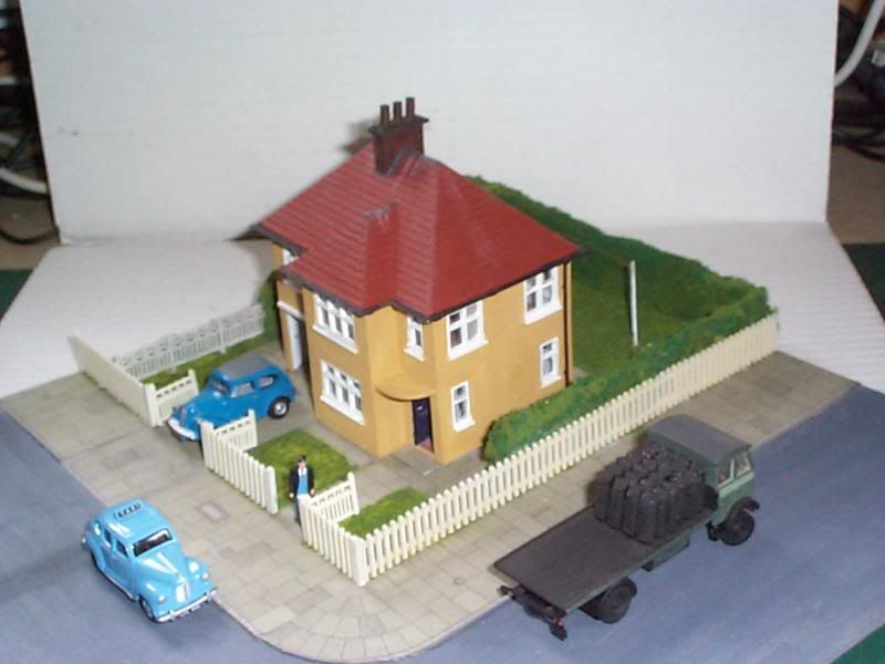

More Photos...
The hedges are "Green Scouring Pad" cut into strips, and covered with Green "Turf" scatter and some Woodland Scenics"Foilage".
White PVA stays sticky for a long time. UHU sets quicker. I have used both here...
Superquick Paving. (Old stock.)
Airfix Station Fencing (Old pre-used.) With Square Section Evergreen Styrene Posts.
The gates and dividing fence came from a job lot of parts, unknown manufacturer, along with the possibly Ratio detailing pack of chimneys, guttering, down-piopes, etc.
The washing line is Slaters Plastic rod uprights, and thinner "rod" for the line. (Needs some washing next...)
The grass is a mixture of Green "Turf" and a lighter green fibrous scatter.
The Coal Lorry is the Cooper Craft AEC Flatbed kit with Merit/PECO Coal Sacks.
The cars are both Oxford Diecast.
The figure is from the Bachmann Scenecraft "Train Crew" pack.
The base is Cereal Packet, painted with acrylics.
The render is painted with an mix of Acrylics. Black, White, and Yellow Ochre.

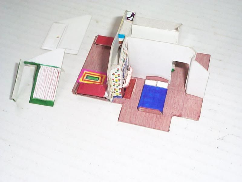

More photos.
The first floor is progressing well, with the bathroom. master bedroom, and two small bedrooms allocated.
The master bedroom now has a fireplace, with a clock on the mantlepiece, and a (now thought to be dangerous, so do not do this at home...) mirror. The flowery wallpaper shows that Mrs. has some say over the decorating!
The ground floor is still awaiting work. The front door will have to be re-hung to open the other way, towards the outside wall.

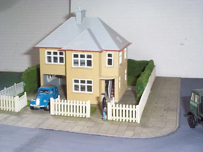

The outside.
I have added cills over the back door, and the garage door. (Rain Strips?)
TV aerial and waste pipes stil to be sorted.
The roof tiles. I have been looking very hard at houses, and noticed that some have shaped tiles on the roof "corners", with ridge tiles on the ridges (!). Some have ridge tiles over the "corner" joins, and some have half round over these joints.
The roof as supplied only has ridge tiles on the ridges, so mine therefore has the shaped tiles on the "corners".
The bathroom window has the lower panes "obscured"...
