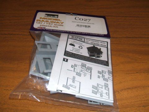

What most of us should now have:
An unopened Dapol kit.
Having opened the bag, this is what we find:
All the bits, bearing in mind the age of the tooling, the parts are still quite crisp and not warped. Plenty of glazing included, but not included in this shot.
And the final photo for now, the windows.....
More on these later.

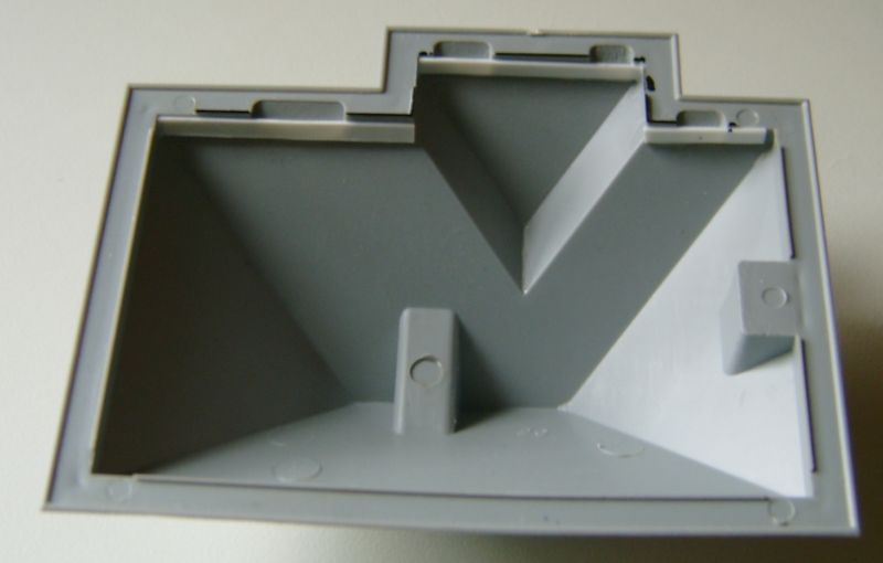

As promised a couple of pics to easily solve the roof gaps, cut a strip of 20/30 thou plasticard 3mm wide & glue the strips to the rear of the gaps ........ mark the locating lugs as i have done in black removing these carefully will make sanding things flush a bit easier, the other three sides provide enough of a guide to fit the roof.
A few blobs of Humbrol Model Filler & it's ready for sanding
There is a nick in the roof edge that needs a smidge of filler as well, the cause of the nick in the roof being broken away from the sprue at the factory.
