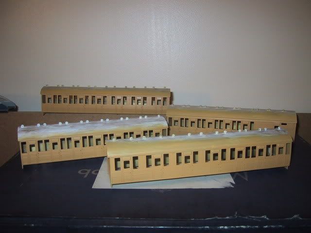

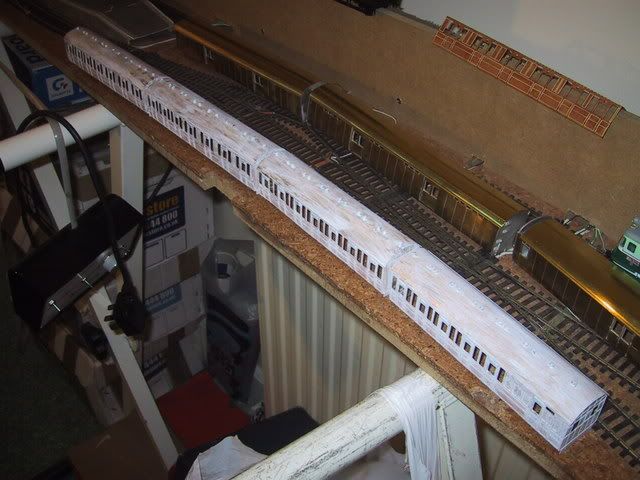

I got the quad art roofs on perminantly and all the vents on friday and saturday morning.
I etch primed it on saturday and tried to spray the teak basecoat last night but the paint had gone bad and its got to wait for some new stuff.
Here is a couple of pics of the fionished shells in primer. of it in primer.

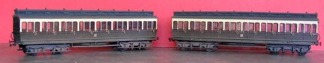

I just got a picture of 2 coaches i partially built.
I didnt do the roofs and when i got them they were 5 sided boxes with super glue all over the place. the chassis were not straight and the underframe detail was non existant.
they are slaters 4mm kits in plastic, lost wax brass and etched brass and whitemetal.
all i did was put them together and rescue them. i didnt paint or transfer or weather them.

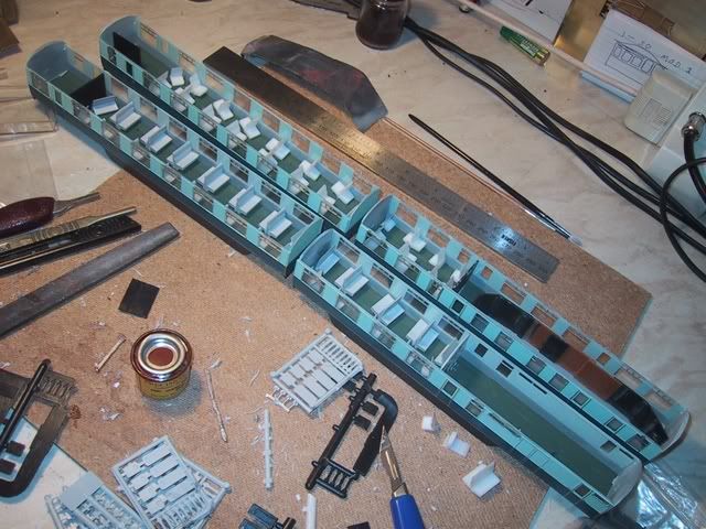

I am waiting for paint to finish the quad so I did some work on my corrie last night. i have not touched this model in almost a year so it was good to get it out and see what needed doing to finish it.
It was one of my first paint jobs with an airbrush so the paint work is not great. i painted the floors green. and cut the seats the right length and glued them together. i have not installed them yet as they still need to be painted.
I put the partitions in last night and they still need painting in grey.
My humbrol paints are getting a bit thin on the ground. come on hornby!! we are getting desperate!!
I am building these for myself so i want to put people in them. i will get some unpainted presier people when i see them.
i noticed that they are riding too low on the bogies. so i will have to sort that out at some point.

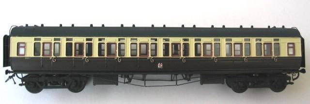

OK i found the beaver tail. i was also sent 2 pictures of a coach i built that has just come back from the painters. its another slaters.
this time a GWR toplight.
The chassis truss was a right pig and i still dont think it looks quite right but it was the best i could do.
Compartment side
Corridor side

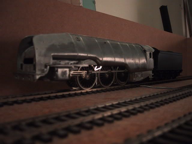

Over the last few days i have been waiting for the paint to do the teak coaches and the TPO's so i have done some work on my M1
I have done the loco brake gear and the pickups. it now runs under its own power without me running along behind with pieces of wire!
The tender is shorting because i didnt file the axels down far enough. i will have to sort that at some point.
The actual body is just about ready for spraying. i want to get some of the new markits sprung buffers rather than use the cast ones that come with the kit.
Excuse the bad lighting it was very late last night and i couldnt be bothered to mess about with the lighting.
I am going to try the new threaded crankpins on the centre axel. i got them at the weekend and they need the hole in the coupling rods opening out slightly. thats the next task as well as painting the chassis.
I am not really happy witht he finecast whitemetal front bogie and i think i will swap it for the comet version.

Well i have had a couple of days working on the quad art.
I got the paint and sprayed the undercoat.
and then got stuck into the teaking. these pictures really dont do it justice. it looks far better in real life.
Now i have to do the other side and the ends!

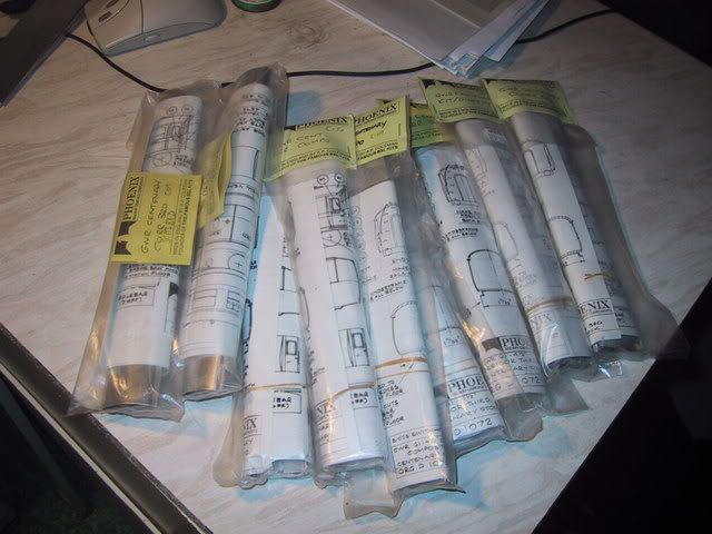

Last night i took a look at a 10 kit set for a full cornish riviera express that arrived a couple of weeks ago.
They are phoenix kits and so the doors needed scribing (i understand newer kits have this already done) it was no big deal and i had it done in about an hour.
I might have a go at sticking a couple together over the next couple of days.
Because they are phoenix coaches, they have punched aluminium sides and have to be stuck together rather than soldered.
it will be the first time i have attempted this. Working neatly with epoxy is not my strong point!
I took some picturea last night of the cornish set.
The 10 kits as they arrived
The typical contents of each kit. there is underframe but no underframe detail like bogies trussing boxes etc..
these are the older phoenix kits. the newer ones have the doors ready scribed but the older ones dont. this is how they came.
