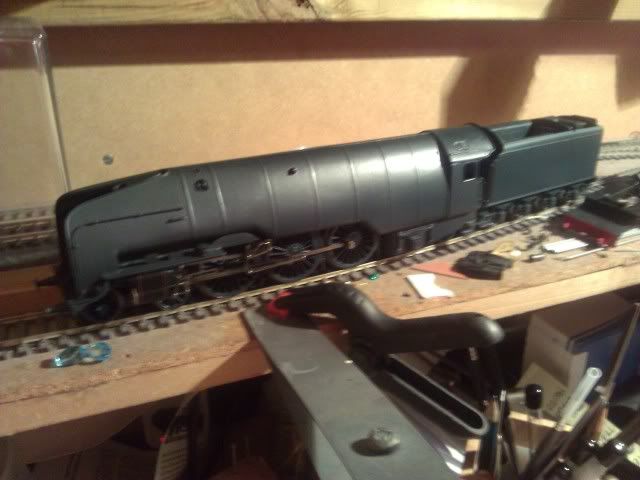

My W1 got anothe coat last night
1 more on the cab roof and the painting will be all done.
That W1 looks superb. Nice job.

The cylinders will be grey. I am also going to try and get some drain cocks from Hornby.
Its had a coat of gloss varnish which means it now looks like a naff piece of tinplate but alas that's the process of decals!

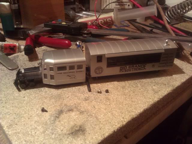

First little job was to investigate the poor running of a D&RGW galloping goose
I discovered 2 problems. the first being that the whole thing only picked up of 4 tiny wheels.
I have added a wire from the rear bogie to the motor bogie so it now picks up of 6 wheels. still not great but with a DCC concepts stay alove it should be ok.
Second problem was far more serious. I noticed a slight clicking sound and decided to investigate.
Serious problem!!
I am planning an order to NWSL so I will try and get a replacement.
Oah the wonders of old brass locos!

I varnished a few things. the C&S 2-6-0, The W1 and a couple of stanier coaches.
No big issues. I forgot to varnish the rear of the tender and the headlight on the C&S. I may cheat and do it with a brush!
I did all the main decals.
The whole loco has lit up! it looks fantastic!
The funny thing is that now its in black, when i line it up with the horrible blue one, the blue one dosent look horrible any more!
I will still remove the artwork but I am definatly going to leave it in blue.

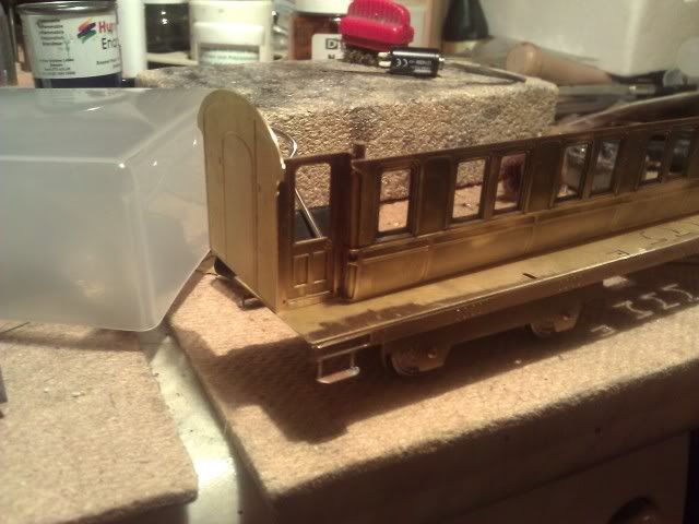

Mike Dunn popped over for the evening to work on his coaches.
Note the dangerous levels of concentration!
Also... I think he is starting to get the tool bug!

But seriously ... many thanks to Peter and his good lady for their hospitality last night
The coaches are coming on ... I didn't make too many mistakes (two window frames got pulled, but as there were about 30-35 of them, I'm not unhappy there - Peter showed me where I went wrong (I think both were on the first side I did with the resistance iron ?) & I improved after that), but I can see where I need to do better (still not very good on the laminations - too much solder
I think I can see the end of these two coaches, I think, so I'd better get saving for the triplet !
I'd better not mention the tools to SWMBO ... I'm in enough trouble
. The resistance iron (once I used it enough to start understanding it) is fun, but pricey ... If I could use it for more aspects, I think I'd get one, but I don't think I can justify it at present, so will stick with my basic iron. I can get the rotary bits for my Dremel (must get the company name off Peter - he did say & I forgot it
), as I can use them on other aspects too ...
