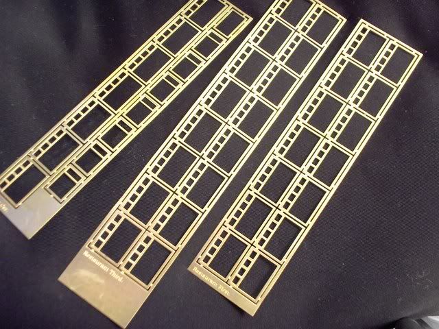

The bollections for the silver jubilee arrived!!
They were promptly fitted. They went on well. This job would have been much easier if i had a resistance soldering iron but i dont so i had to do it the old fasioned way. This is one of those jobs where the resistance irons really stand out.
i have also put the bollections on the resteraunt third sides but it was getting very late and i had an early start this morning. I hope to get at least 2 of the SJ triplet on their bogies tonight.

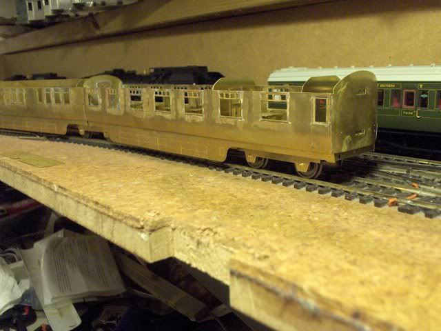

I have completed the brasswork on 2/3 of the triplet and its looking good.
I had plans to do an etched brass roof for it but i now have the roof and it just isnt going to work. On some coaches it ooks really good but on this one it didnt. the cantrail was all wrong and the roof had to come down untill it was resting on the top of the window bollections and there was soo little brass left to solder.
Anyway, the extruded aluminium roofs that are fairly readily available (MJT/Comet etc..) fit perfectly and i was ging to get several at ally pally, but none of the stands that would have had the item were present.
I had it going round the clubs test track last night and it was running very nicely. it is quite cclose coupled though and i think i may have to draw and include some longer coupling eyes. this was only last night and i havent really thought about it since.
Here are some pictures i took last night before taking it to the club. please note that its only on accomodation bogies i had lying around my bench.
The next step is to sort the roofs and to make the corrections to the artwork. one thing i have noted is that with the aluminium roof the internal partitions in the kitchine car are too tall and foul the roof. this will also need to be sorted.

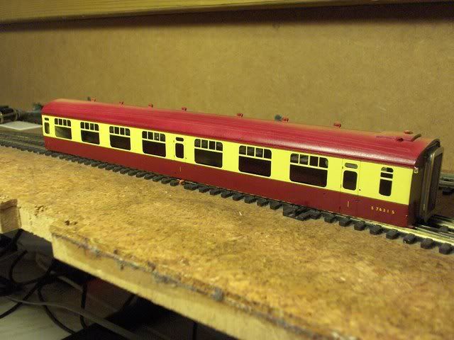

As for the rest of my bench. i have been doing a bullied coach for a friend. This is awaiting the transfers from fox and a squirt of gloss varnish. I am very pleased with the paint so far.

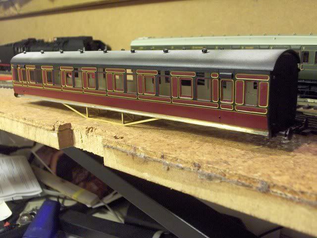

Here is an LMS P3 kitching car (of the top of my head i think it was D1982)
And another LMS coach. this time a P1. i am so pleased with the lining!!

Progress has been slow on the jubileee kits because of the other things i have been doing, but they are going together nicely. there are lots of alterations to do but they are not difficult ones, just time consuming.
The full consist was (drum roll please!)
Brake first - Semi open first (twin)
Resteraunt first - Kitchine car - Third resteraunt (triplet)
Corridor third - Brake third (twin) - this twin was later aumented with another third to make it a triplet.
By far the most complex bit is the kitchine triplet. that is why i have been working on that one.

I lined the other half of the LMS coach last night.

Its actually a P1.
The sides are from 247. the ends are some very old ones that actually dont fit properly (they were designed for a wodden roof but i will fill the gap with something), its sitting on a comet chassis and i havent bought any bogies for it yet! the bogie bosses i have used are the 247 ones as i dont like the comet ones.
The lining is done with a bob moore lining pen. i tend to differ with other coach builders on this. they put all 3 lines on the beading where my yellow lines are sitting on the panel. they say theirs is better, but really we are all wrong, it should sit on the corner of the beading which is really not practical. who who is to say that their artistic licence is any better than mine!??

I have done alot of work on the lms coach. it how has its transfers and is looking even more beautifull than it was before! i am still not quite sure what to do with the roof. the real thing was 2 tone which i think looks unnatractive. i think i will just do mine a simple grey.
I have also been doing work on the Bullied coach that is a comission from a friend. after some help from members of this forum i got the correct transfers from fox for the lining. i am really pleased with the finish on it. i am sure the customer will be pleased. i am hopeing to have this one finished for Chatham.

I want to get the Bullied done for railex. I was aiming for Chatham but its comming along nicely and I think I can get it done for railex. The sides have been painted and transfered and lined and lettered. and varnished. They need another coat of satin varninsh but I need to paint the ends first.
The interior is also comming along nicely. the corridor partition was a bit of a pain. it is only spaced for 3rd class coaches so for this first i had to seperate the parts and put little spacers in. the finished result is ok. this will be painted just as soon as i can figure out which colour it is supposed to be.

I did the transfers on the LMS P1. I got some HMRS transfers at ally pally and the letters and numbers were great. Unfortunatly the colours were not lined up properly and the emblems are unusable. The yellow disc is not lined up with the lettering. a real shame. I am hopeing to get them swapped.
