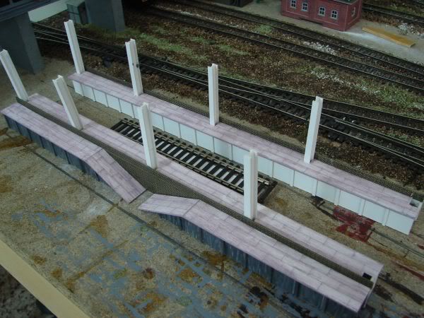

Some of you will already have seen some of these models but because I am so keen on using card as a modelling medium and think that it a much under rated material I like to spread the word among as many people as possible. Especially the young who may not have so much cash to spend and who would like to see what can be done with very little effort and cost. If any interest is shown then I will continue with various models but if not then that is perfectly understandable and the subject will just fade away.
Enough of the blurb and here is the start of a diesel locomotive washing facility. I am not a scale modeller of prototype material as I like designing my own models once I get a general idea of what's needed.
This first photograph shows that model is going to have two tracks, a layby outside the facility, for interior cleaning, and the main track inside. Here you can see that the card platforms are installed and work has started on the support girders. The short length of track is just there for measurement purposes.
