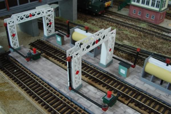

Now we have the pipe delivery system in place taking oil from the inside track and delivering it to both fuel tanks.
Here's an overhead shot of the unit before the extra pipework is fitted so that fuel can be off loaded from both tracks.

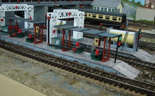

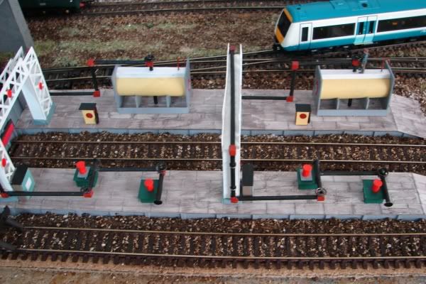

Now you can see in this picture that the unit is now capable of offloading from rail tankers from either track after the addition of further pipework. The monitoring equipment is now in it's correct place and the delivery pumps, complete with hoses, for fuelling locomotives, are also in position.
That's good news Jeff. You can't beat perseverance to get you to your objective and the effort really is worthwhile.

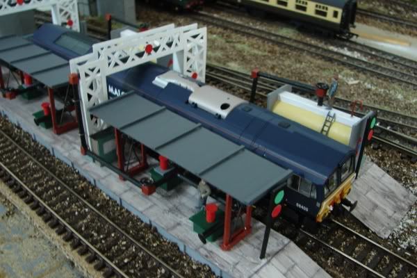

Here's a shot of the Class66 having a go and the warning signs have been added. As a unit it is now fully functional but with more detail still to be added.
I have now added canopies to the oil off loading points. The chap who actually fills the engines up will have to get wet as two more canopies hide too much detail.

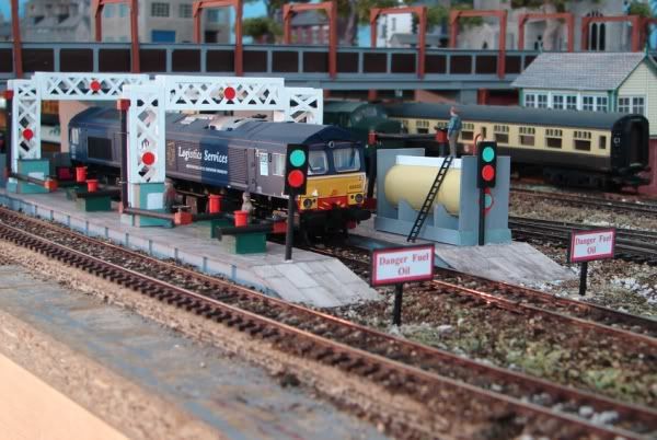

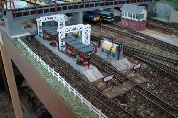

Showing that the biggest of Barchester's locomotives fits snugly into the new unit. It is completed now except for the ballasting, bit of grass edging and some white fencing, just finished 12 yards of that so there's no shortage, oh, and a timber cross track walkway for the staff.
This is the final product with everything in place that was mentioned in the previous post. After a few hours effort, absolute minimum cost and a lot of satisfaction I have another model that is unique to Barchester. Not to everyones liking of course, and don't even mention being correct to scale but for me it's a question of making it look right for the part it has to play on Barchester and that's the starting point for everything I build.

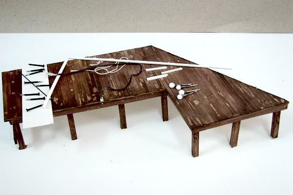

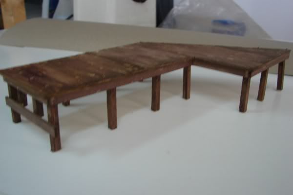

In this picture you can see the plain top of the jetty which has been scribed for planking and then coloured with wood dye. The 'legs' are short lengths of square timber.
This is the next stage in the construction where most of the bits and pieces to help complete the model are gathered together. Hand rail and supports, ropes, posts for life savers etc.

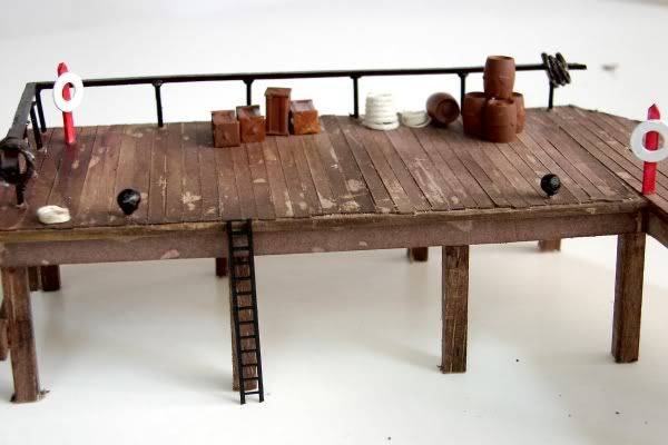

Here you can see that the jetty has had all the bits added to it from the previous photograph plus a few drums and crates. There is much more to add once the model has been installed on the layout and a friend has given me a plastic kit of a crane which should be suitable for the jetty. I am not a lover of plastic kits, much preferring to make my own stuff and having looked at the bits and pieces that make up the kit I cannot see a problem with making them from card.

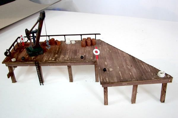

Here we have the new plastic crane fitted to the jetty so now the whole thing can be positioned in it's permanent home in the larger of the two canal basins on Barchester. Notice how effective the use of simple materials can be, bits of card, nails, string etc.

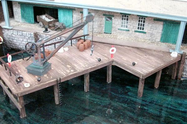

Finally here is the jetty installed in the canal basin. It still awaits more bits, people, fisherman etc but other than that this is how it looks. A very simple thing to make, an excellent starting point for anyone wanting to venture into the world of card construction.
With regard to the first post all the girder work is made from card and was painted in situ as I don't really like handling things after they are painted, especially when acrylic paints have been used. The platforms are scribed card, grooved, then given a wash of dirty water (water that has been used for cleaning brushes) and then wiped with a rag.
The jetty has been laid with individual planks of card, on top of a card base, and then the whole thing painted with a wood dye.

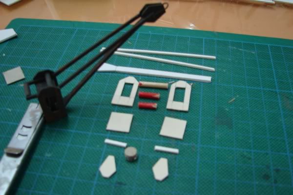

Further to my remarks a couple or three posts back about making cranes from card, as Barchester needed at least two more of them, here is a picture of how I went about it. On the left is a partially constructed crane and on the right the cut out bits for the identical second one. No problems so far. Components are all card, paper and short lengths of kebab sticks.
