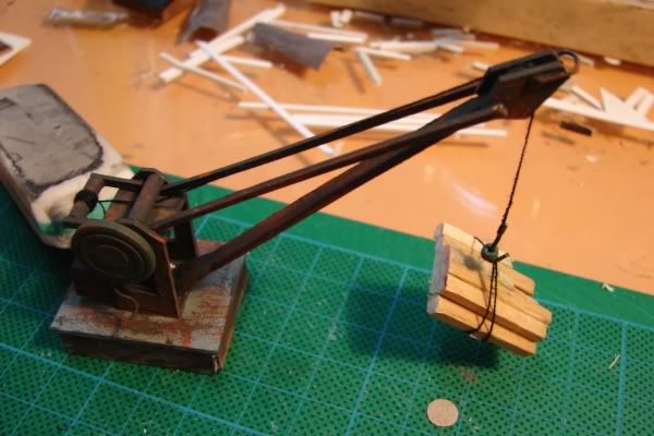

One of the pair of cranes almost completed and under test in the Barchester workshops.

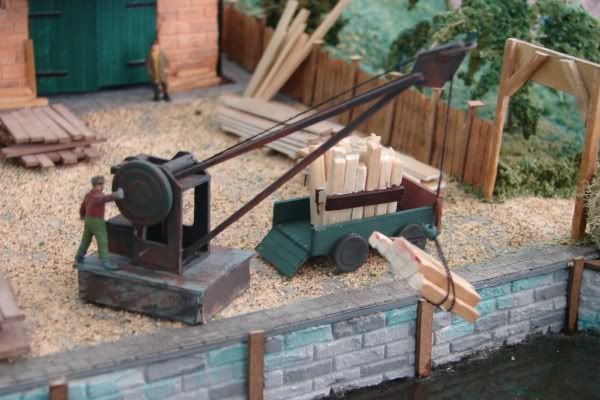

One of the two new cranes in service in the Barchester timber yard.

Here is a picture of the second crane in action in the Goods Yard. Again everything here is of card or paper except for the milk churns.

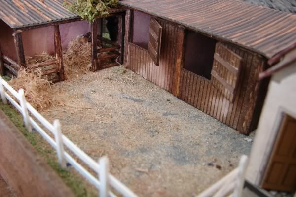

Here are the stables under construction. Comprising two buildings, one enclosed with stable doors and the other an open structure. The almost completed one is all of card while the one at the front has a rear and side walls of card while the framing is made of the large BBQ match sticks and toothpicks for the round side bars. The roofs, of corrugated card, are coloured and weathered as required.
Here are the two buildings assembled and in position with the card fencing added.

Here is the finished stable model complete with suitable livestock. They should be comfortable enough there as well as helping to fill the coffers of the Barchester Railway Preservation Society on open days.

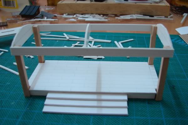

Here's the start of another card model, this time an open sided saw shed. Very simple to make but can be quite effective in the right place. This first photograph shows the base and the supporting posts for the walls and roof.

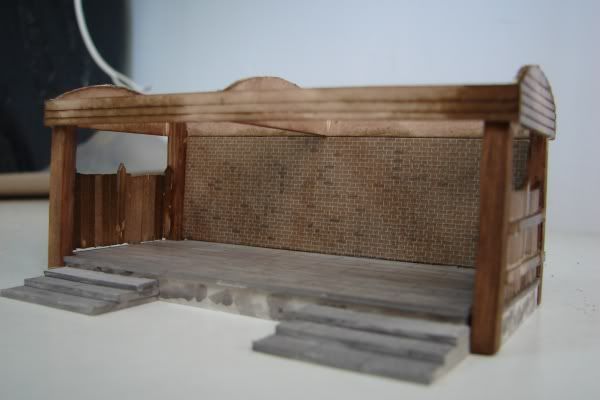

Hi keekster. With regard to the white building. On scribed walls I would always apply a thin coat of paint of the required colour as this accentuates the scribing as you are dealing with two different surfaces, the smooth uncut surface and the rougher finish inside the cut and this produces two different shades of your colour. If you are sure you don't want to do this then get a small off cut of card and scribe it the same as your model then get some white water colour paint with just a touch of black in it and wash it over the surface of the scribed card then quickly wipe it off with a soft piece of cloth. You may have to try it a couple of times till you get the wash right for your building. If this seems a bit drastic then get a very sharp hard pencil and lightly, very lightly, go over the scoring. Again try this on a piece of scrap card first. Finally I have to say it is not a good idea to leave a white card surface in the raw as it is so easily marked and almost impossible to clean without marking it further.
The brick paper is marked out over size, put on after the card is cut out and the surplus folded over the card edges. This also applies to door and window openings.

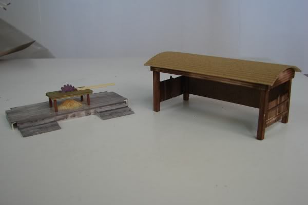

Here we have a photograph of the open sided saw shed in two halves. The base and then the walls and roof. It is much easier to build this type of thing in a modular form and then fix the sections together later on. The corrugated roof has been added, but not coloured yet and the base is almost complete. Apart from the roof supports, sawdust and the saw blade, all construction is from card.
