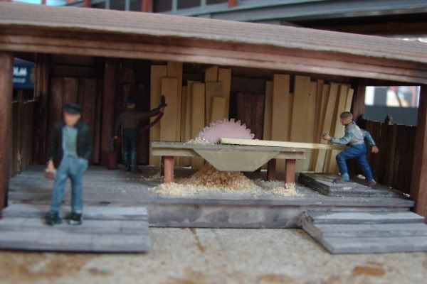

Here's the completed model, roof still waiting 'repair', notice the man at the back of the shed spraying preservative on the raw planks.
The figures come from Dapol and Airfix keekster.
Perhaps I should have put a couple of dabs of red paint in the saw dust pile under the table? Anyway, what's a couple of fingers or so to the stalwarts of Barchester? Nothing that a plate of pie and chips won't cure.

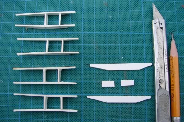

Well it's been a fair time since I reported on happenings at Barchester as most of my time has been taken up with web pages and refining operations on the layout but now I have a little time to spare. To fill this gap I have just started a much needed set of mechanical horses. They have been in the pipeline for ages but at last I have been able to make a start. As usual they will be of all card construction and at the lowest possible cost, in this case nothing, as they will be small enough to enable me to use old offcuts of card. It's been many years since I attempted anything this small, over 50 in fact, so bare with me as I get my aged fingers and eyes into gear.
I have accurate dimensions of the prototype and have scaled them down for 4mm to get a general feel of the thing. Also as usual I make no claim that the finished models will bare any resemblance to their prototype as they are being made as a unique contribution to Barchester, like everything else on the layout that has gone before in this thread.
Anyway I started off this morning using 1mm card for a rough representation of the chassis I am going to use, as shown in this picture.
Hi there David. Just in case there is anyone out there who is not familiar with the mechanical horse here is a link that will show what I am about. The Barchester versions will follow the first picture for prime mover and the trailers the second, except that my trailers will have 2 planks sides with a drop down rear end, hopefully. Please remember I am not modelling those prototypes but following the type.
http://homepage.ntlworld.com/malcolm.rusco...cal%20horse.htm
Fortunately I have been able to aquire good diagrams of the mechanical horse from another kind modeller so I have the general dimensions to work from. I have now started on the modelling and straight away have realised that it has been a long time since I attempted anything this small and that with my aged hands and eyes things are not going to be so easy. Anyway, enough of the excuses.
I have converted the main measurements for 4mm and will keep things as simple as possible using scrap pieces of card and any other bits I could find. I am going to make all five models at once and don't intend buying anything so this will be another real cheapo.
Had a spare hour this morning so made a start on the chassis of the prime movers using 1mm card. You can see the very simple component pieces and then four of the chassis glued together. My favourite white PVA is the adhesive used throughout..
Here's the next stage in the construction. The chassis now has it's front card support for cab and wheel while the cab parts are laid out after being cut from a thinner card than the chassis. We don't need such heavy material anymore. The chassis sides are now running parallel to each other.
