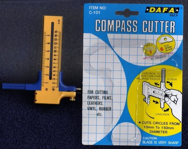

Seen one of these? Picked it up at an art suppliers in Perigeuex, for €6-95. Works very well, better if you do thick card from both sides. The packet says 'Beware, Blade very sharp!' What it should say is 'Silly old g^ts should not try it out resting on their desk using only two thin layers of card...'
Didn't know they existed, can't wait to try it out for real.

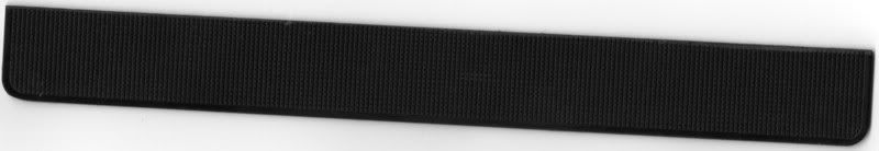

Hi Again, Cee Dee, and all who try to model with free/cheap materials, piccy below of piece of plastic cut from an old VHS video cassette, it's an acceptable sustitute for engineering brick or industrial surfaces if painted silver perhaps? I intend to cut a narrow strip to try and edge a bit of goods shed platform on which to mount a crane. It's about 7.5 inches long.
Now that is what I call a handy tool doofer. I will be on the lookout for that at all our local ferreterias. I wonder if they are sold online?
Just done a search on Google and they are available from Maplins at 2.99 sterling. Comes with six spare blades and two pencil leads. Brilliant.
http://www.maplin.co.uk/Module.aspx?Module...ompass%20Cutter
