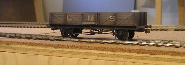

Double Bolster:
I'm pleased that, after all that bother, the bolt heads are actually visible. Lettering copied off a pic in Essery's LMS Wagons.

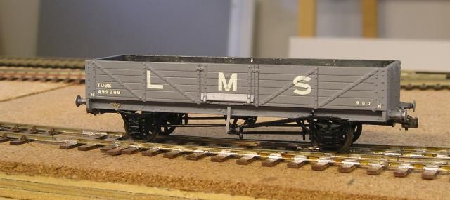

Tube Wagon:
Again, taken from a photo in Essery.

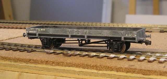

Finally, Long Low wagon:
Not sure about how my attempt to have unpainted sides turned out. This time there wasn't a photo in Essery of the wagon in LMS guise so this is a bit of a guess based on a similar wagon.

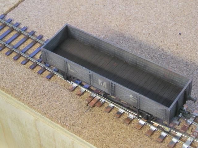

After fixing the long low's brake levers
, I turned my attention to weathering. After having the airbrush stop flowing twice, I got fed up and gave it good soak in lacquer thinner (horrid stuff
) - I found the body full of filth - this despite me cleaning it after every session. That done I carried on with airbrushing, followed by powder.
Double Bolster:
Tube:
Long Low:
I quite like how these came out.

The floors don't look at all bad I think, although they could be lighter:
