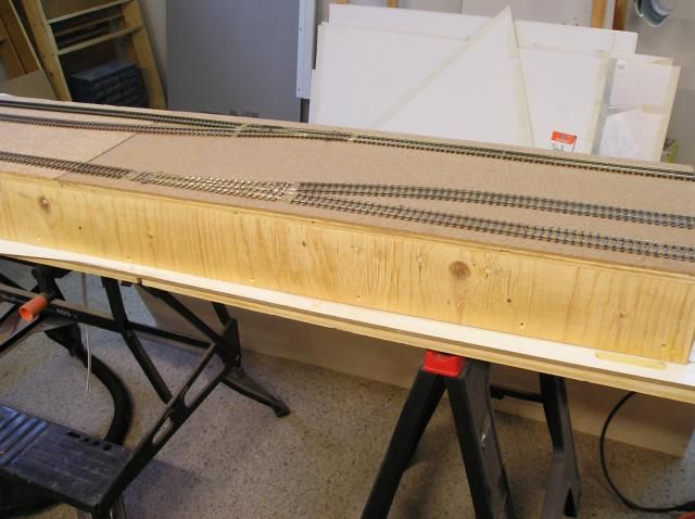

I just made a test track on a 1' x 4' board on which I have put a single point and siding in 00 and EM.
Sounds like you and I are on more or less the same wavelength Sean.
My test track is nothing to write home about:
Basically made from wood I had lying around, even the cork top is mismatched. Sides are 4" deep 1/2" crap both side ply. The track nearest the camera is EM, with a point I made from a SMP kit I had. I don't intend to use copper clad for the real layout, except maybe in the fiddle yard. The small Peco point is quite old and was insulfrog. I converted it to quasi electrofrog by excavating under the crossing and re wiring.
Track is loosely held down with pins (gasp!) for now. I will wire it another day.

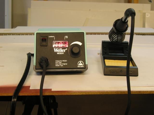

My soldering has become more enjoyable since I got myself a Weller soldering station:
A bit dear but, if you plan to do a lot of soldering, well worth it. This unit reads back tip temperature. Rule of thumb (Tony Wright I think) - tip temperature should be twice the melting point of the solder).

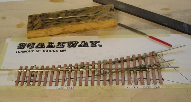

Making vees and blades is not that hard. I used a couple of pieces of PCB to make a jig for the point above:
I was surprised how quickly and easily I could make blades - always seemed a struggle in the past so maybe things are clicking.
You need a block of wood, big file with a dead edge and a small file for finishing. Use the big file to file the side of the rail in contact with the stock rail away from you while resting the rail on the wood - this removes material quickly. Turn the rail over and carefully file down the just the top flange of the rail - this is where the dead edge comes in since you want the bottom flange intact. Use the small file to sharpen.
