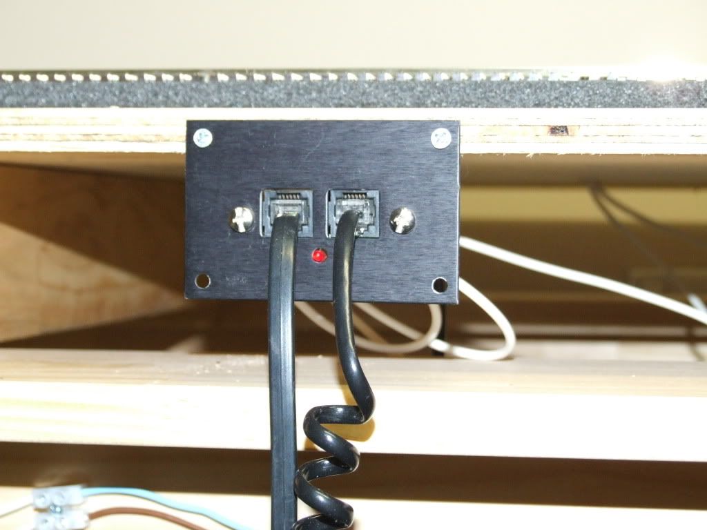

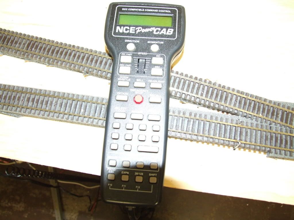

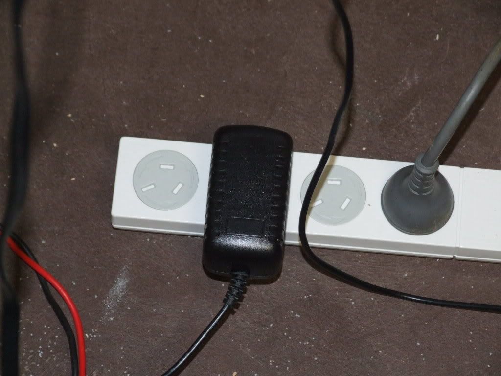

The NCE Power Cab is a complete DCC system contained within the hand set. The Power Cab throttle facisa is identical in layout to the Pro Cab throttle and the Power cab can function as Pro Cab on Pro Cab systems. The System comes with a UTP that is slightly different from the standard UTP by the addition of a mini stereo jack connection for the power supply and a two pin socket and plug for the layout connection. There is also a red LED fitted that illuminates when the Power Cab is powered up and functioning. The rest of the bits are a 2A power supply and two cables, one 4 wire curly phone cable and a six wire flat cable with RJ12 connectors. Set up is fairly simple first select where to mount the UTP then connect the layout connection via the two pin plug, then plug in the power supply to the mains and plug the mini stereo plug into the back of the UTP. Now plug the flat six wire cable into the Power Cab and then into the UTP. Now switch on the power supply. The Power Cab will boot up and show version number and a cab address. Select an loco and throttle up and nothing happens as your loco refuses to move. This is the first trick with a Power Cab only one socket of the UTP is stet up to power the throttle and this is what the six wire cable is for. Simply un plug the cable from socket and plug it into the other one. The Power will boot up again and this time the red LED will light indicating pwer is now going to the track. Call up that that loco again and it should now move. The other socket on the UTP is a normal 4 wire socket that can be used for a second throttle like a cab 04 or a Pro Cab. Other than the simplified wiring the Pwer Cab has mostly the same features as a Pro Cab but there are a couple of limitations. Firstly you can only have two cabs and only two cab addresses. The Power cab must have address 02 and the second cab address 03. Due to the power limitations about 6 non sound equipped locomotives or three sound equipped can be run at any one time. NCE in their literature quote " Number of similtaneous trains= 12" but I've found 6 to be about the limit. This will also depend on the current consuption of the motors in your locos. You can have more locos on the track but the more you have on limits the number you can run at any one time. I have had six sound equipped steam locos on the track but I have only been able to have two moving at the same time. Another limit is the number of recalls you can have. On the Power cab this is limited to two as opposed to six on the Pro Cab. The system supports on line programming and program track programming and this is another little trick the system has. Due to limit on size the Power cab has no seperate programming track connection just the two wire connection to the track. This in essence turns the whole layout into a programming track and can trap the unwary, those that don't read the manual first!!. To do this would result in all locos on the track being programmed to the same values which would be a royal pain. To solve this NCE have created a small device called the Auto S/W which when fitted senses when you are selecting programming track mode and basically cuts power to the main track and sends power only to the programming track. You could also solve this by wiring track connection through a double pole double throw switch.
One of the neat features is the track current readout. By selecting this the display will show the track current which is a boon as the more locos you put on track and run it will show current being used and when the system gets unstable you see how close you are to the 2A limit. My Power Cab shut down at 1.8A.

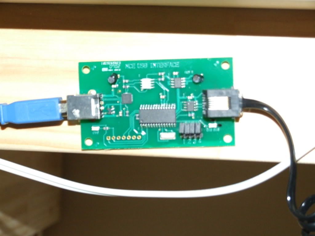

But this too has been solved by the addition of a USB adaptor. The adaptor allows Power cab users to interface a PC or laptop with NCE cab bus. This allows the use programs like JMRI "Decoder Pro " to be used for programming decoders. The USB adaptor also comes with an update IC that up grades the Power Cab to version 1.28C. After this IC is fitted when you power up the Power cab it will show version 1.3. If you get this it is important to ensure you download the latest drivers for your PC or laptop prior to connecting the adaptor to the PC or laptop. It is also wise to follow the instructions provided concerning the position of the jumpers on the USB adaptor. If like me you are running XP Pro ensure all the jumpers are off and the baud rate is set to 9,600baud. Strange things will happen if you try to set it any higher, basically it won't function and the display on your Power cab will have changed to either some form of gibberish or a series of black blocks. to sort this out up lug the cab and unplug the adaptor from the UTP. Then reset the baud rate back to 9600. Plug it all back in and things should be okay again.

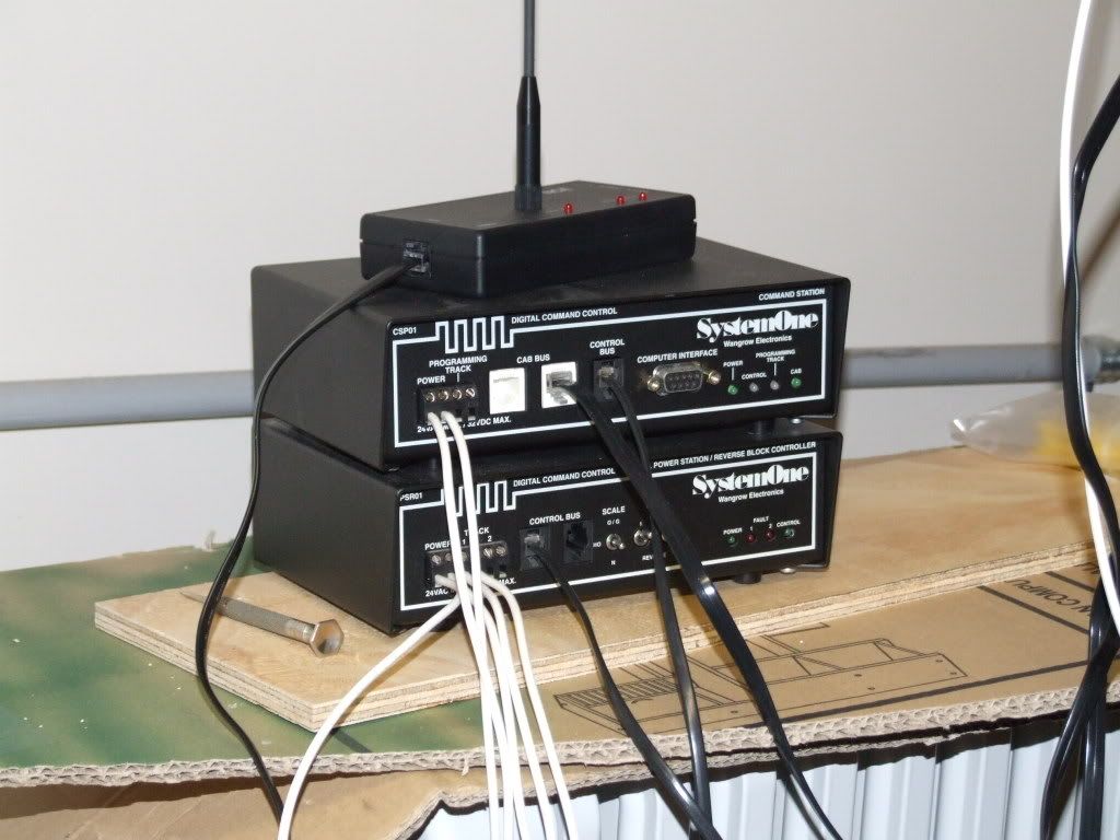

upgradable with the addition of an SB3 smart booster which allows more cabs and more power. For those with the Power Pro it can be used as a stand alone programming unit, this is what I use it for now, which negates the need for a separate PTB and you have an extra cab when friends call in. The one thing it can't do is radio. For radio you would have to go the full monty for Power Pro radio. I went the other way and resuurected my ols Wangrow System One from 1994 which looks very similar to Power pro but predates it. to this I added and RB02 radio base station and a couple of cab 04PR's to give full radio functionallity.

Power Cab, complete DCC in one little unit.
UTP, Note the red LED and the orientation of the cables.
USB adaptor. Curly cable from the UTP and the blue cable ( not supplied) to the PC/laptop
Power supply
My Old System One, 1994, set up with an RB02 to give me radio.

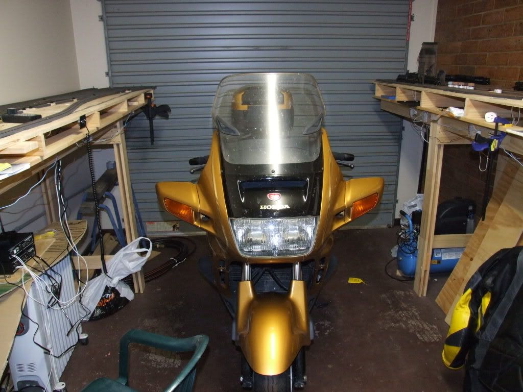

Neil, it does get cold out here in the bush. We often get frosts in winter and occainsonally it gets down to zero. Usually when that happens I change out of my ordinary thongs and put on the fur lined ones

QUOTE (neil_s_wood @ 24 Oct 2008, 15:30) <{POST_SNAPBACK}>I've got a heater just like yours in my garage too. The one to the left of the bike. I didn't think they had heating in Queensland.
