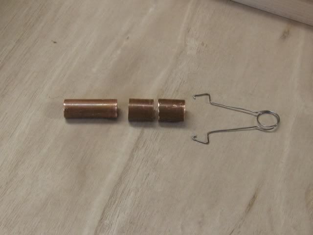

This could save you a few bob.................pieces of concentric copper pipe, the larger outer pieces roughened up, slid over the inner piece and hammered [soft faced hammer] through a tight fitting hole drilled through two adjacent baseboards. The bent wire clip stops the inner piece dropping out.
