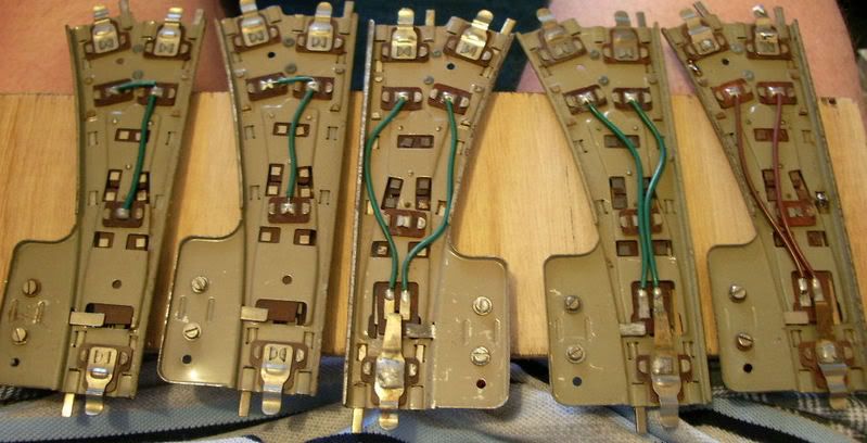

However, I must point out that tt was not even apparent to me that the RHS points in the pics were the isolating ones.

I confess to forgetting entirely about some little pieces of paper which fell out of the points boxes... these would be the insulators mentioned, and I do recall... now that you and Gary have stimulated the neurons... reading somewhere that they were to be employed in a fashion as described. I discounted them I think since I was using some self-adhesive green baize for the base... and it is of course electrically inert... but then of course so is a wooden board.

Each point has 3 connections in and 2 sets of 3 connections out. Lets call them RailA, RailB and RailC where RailC is the centre rail.
You have two types of point which have two different types of truth table. I can't see the connections for the two outside rails, so I don't have enough information to create the truth table for RailA and RailB but if I get the idea across, you can do that for yourself. I believe in the context of 3 rail it doesn't really matter since they carry the same polarity - is this correct??
The truth table for the permanently live points (That's the two on the left of your photo) is as
follows:-
Straight ahead: RailC (StraightAhead) = RailC (In); Rail C (Turnout) = RailC(in)
Turn out: RailC (StraightAhead) = RailC (In); Rail C (Turnout) = RailC(in)
The truth table for the isolating points (That's the three on the right of your photo) is as
follows:-
Straight ahead: RailC (StraightAhead) = RailC (In); Rail C(Turnout) = OFF, Nothing, Niet, Rien, Nada
Turn out: RailC (StraightAhead) = OFF ; Rail C(Turnout) = RailC (In)
Now pick a location on your middle loop and build a tree of the connections from that location. Each time you encounter a point, introduce a branch. Depending on the type of point used, apply the appropriate truth table. Once you have built the tree, you can work out what rails are powered for each combination of settings.
Having written all this out, I think you can make your layout work if you ensure that all your crossings have at least one isolating point in them. So that's locations (1,2); (2,3); (5,3); (4,1). Co-ordinates are x,y and reference the origin of the containing square.
