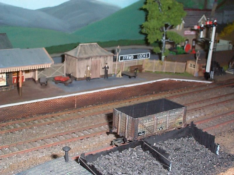

I humbly submit a few pictures of my Ffrwd Locks station.
Ffrwd Locks.
This layout is based on fact. The GWR had a line from Wrexham, up the Moss Valley to the Ffrwd Ironworks (also served by the LNER).
Ffrwd is a small village or hamlet North West of Wrexham, near Cefn-y-bedd.
The area was very industrial, with coal mines, brick works, iron works and quarries.
A canal (The Ellesmere Canal) was planned to run from a place on the River Mersey near Whitby, to near Shrewsbury on the River Severn. This canal would pass through Chester, pass very near to Wrexham (at Poolmouth), and pass by the industrial areas around Ruabon on its way south. A branch was to run from Poolmouth to a large reservoir at Coed Talon, via a flight of locks at Ffrwd.
This canal was not built as planned, largely due to the inflation in the economy after the Napolionic wars causing construction costs to increase substantially. What was built is now known as the Llangollen Canal, and part of the Shropshire Union Canal. (The place near Whitby is now known as Ellesmere Port.) A part of the branch was also built at Ffrwd, and remains can be found, despite part of the canal being built over by a railway, which is now also derelict and lifted. (The Great Central Railway Westminster Colliery Branch, which also served Ffrwd Ironworks.)
This is the inspiration for the Ffrwd Locks model railway.
For the purpose of the model, it is assumed that the Ellesmere Canal was completed as planned, and the settlement at Ffrwd grew large enough to warrant a passenger service (the GWR lines in the Moss Valley only had a passenger service as far up as Moss Crossing.) I have called the station "Ffrwd Locks" as the station at Ellesmere Port was originally known as "Whitby Locks".
The Ironworks prospered instead of Brymbo Works, and other industry has also had its "lifetime" extended into the early 1950s.
The GWR Moss valley line was extended to Coed Talon (Instead of the Brymbo Line) and was a joint line with the LMS from Ffrwd Locks Station (Instead of Brymbo) to Coed Talon.
So, the line from Wrexham (using the line of a former tramway) comes in under the LNER Mineral Railway bridge and the adjacent canal aqueduct into the station. The Coed Talon line leaves over the level crossing and head Northwards. There is a branch to Ffrwd Ironworks (Freight only) which leaves alongside the line from Wrexham, but soon curves sharply to the "left" and climbs to cross the canal on a swing bridge, and so into the works. There is a junction with the LNER branch here.
The Level crossing and the aqueduct/LNER bridge are the "scenic breaks".
This model has had a long existence, the first Ffrwd Locks was a collection of Superquick card models, but a permanent baseboard, etc. never happened. A batch of Ratio plastic kits was acquired, but except for reading the instructions, remained in their boxes until early 2008.
The current model has a board made from two pieces of plywood (about 6mm) on a softwood frame, with another piece of ply under the joint. The backscene boards are also plywood, as is the "box" which covers the model (A front and a lid.). All timber was recycled.
Cork has been stuck to the plywood (both Tiles and the Hornby Cork Roll.) The track has been laid using Gaugemaster Ballasted Underlay, and is all second hand Peco Streamline, with a mixture of live and "insulfrog" points. More ballast has been added using PVA glue, mainly between the underlay to fill in the gap.
Most buildings are Ratio and Wills kits, most from the batch that I had acquired earlier. Most have some modifications, to make them a bit different.
The station platform is softwood faced with Wills brick sheet, and surfaced with fine wet and dry ("Tarmac" areas) and Metcalfe paving slabs. The station building is on a "base" made from scribed 1mm plastic card. Fencing is Ratio Spear fencing. Name boards are by Coopercraft.
The coal bunkers are built from separate sleepers, and were made some time ago. I think they may be SMP parts.
The Aqueduct carrying the canal over the road and railway is made from "corn flake" packets, and is based on part of the Pontcysllte Aqueduct, at Trefor.
Some of the "groundworks" are "corn flake" packet card and more softwood strips.
What little greenery has appeared so far is Lichen, and various scatters, and PVA glue.
Rolling stock is mainly second hand, and the small collection from the first Ffrwd. Mainly GWR motive power, but with a J72 from the LNER (connection at Ffrwd Works with the LNER), and a 3f tank from the LMS (For model purposes, a joint GWR and LMS line runs from Ffrwd to Coed Talon, but at the moment is "out of use". The line to Coed Talon is "out of use" as there isn't enough room on the allocated board!)
GWR locos include 45XX tanks, 2721 Pannier tank, 57XX Pannier tanks, Dean Goods and Collet Goods 0-6-0 tender locos.
There is a collection of coaches, including "B" sets and an Autocoach, and a selection of wagons.
The model is still under construction, progress is slowed at present by the overhaul of several Hornby Dublo and Tri-ang locos and stock, etc, for our "other" railway (Which has no board as yet!)

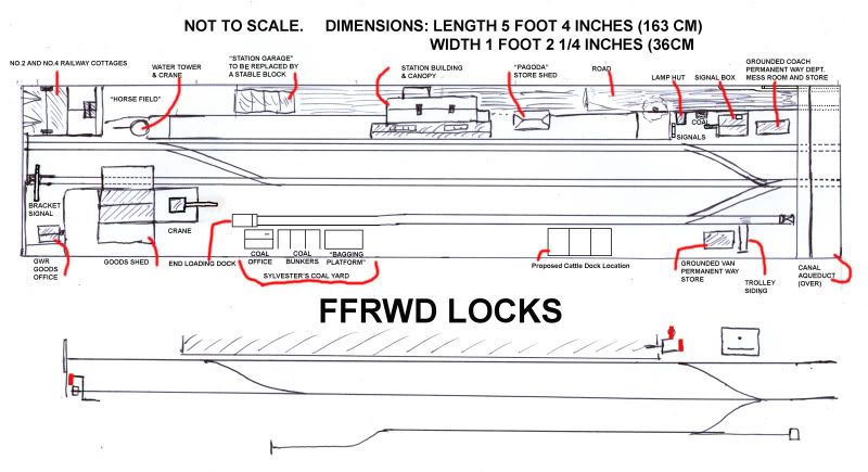

I am at present re-modelling the main goods siding at Ffrwd.
I had become aware of a serious limitation of having the Cattle Dock at the end of the siding with the Coal Merchant's facilities between the dock and the "main line".
The end of the siding would be out of use if there was a wagon being unloaded at the Coal Merchants.
(Though it seems that there was at least one place with a similar arrangement in "real life"!)
The original idea of installing a new point on the loop to serve a slewed connection to the Cattle Dock seemed a good idea, and I did cut the siding and loop tracks to install the point.
In the end it became only too clear that this wouldn't work.
I did install a PECO trap point at the Wrexham end of the loop though. The rest of the loop track was re-laid using some left over track and some pre-wired fishplates to provide some extra feeds.
The siding has been re-arranged to have the Coal Merchant at the far end of the siding, and a small Cattle Dock where the Coal Merchant was.
This has involved the demolition of the End Loading and Cattle Dock, and the Coal Merchants coal bins and office.
The siding has been legthened slightly with the removal of the End Loading Ramp, using some more left over track and some pre-wired fishplates to reinstate the feed.
A new Coal Order Office has been made from an old Airfix Coal Office. This has new windows, door, roof, and chimney. Mainly spare parts from the Wills Goods Yard Store Kit, with Wills Slate sheet for the roof. Signs have been made on the computer.
The Coal Bins have been re-built from the original parts. A new "bagging platform" has been constructed from the staging from the Wills Goods Yard Store Kit, with Wills Planking sheet from the Level Crossing kit for the platform, Evergreen Styrene strips for the roof supports and other planking walls, and Wills corrugated sheeting sheet for the roof. Bagged Coal is Merit/ PECO Modelscene Coal Bags. Spilled coal is shot blasting compound. Scales are scatch built, and various figures are in use (Langley and Merit/ PECO Modelscene /Slater's.)

Here is the revised track plan.
