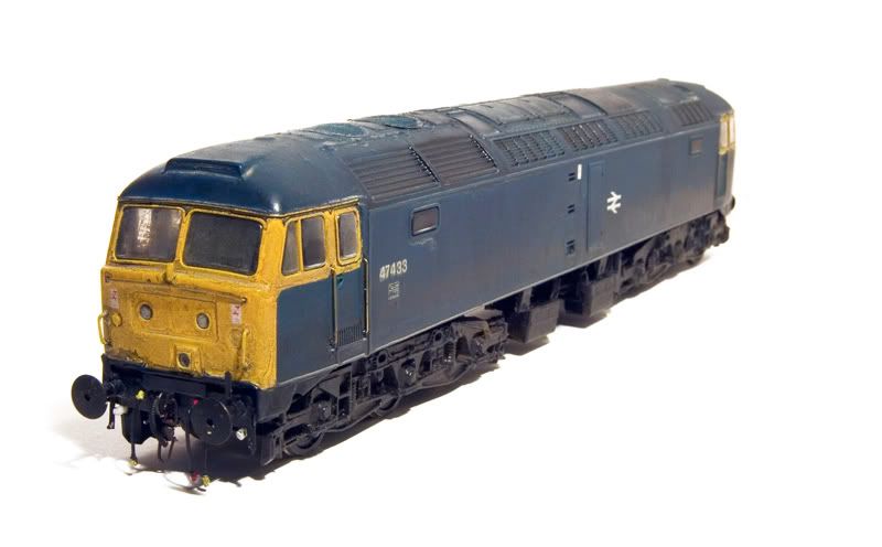

there was an article in a magazine a year or two ago about weathering using makeup which is completely removable or another way of doing semi removable weathering is with weathering powders. I have yet to attempt weathering at the moment i don't have the time to attempt anything but have been reading up about it the general consensus seems to be less is more and to build up the effect a little at a time
Lots of great advice here! I think everyone needs to find their comfort level. For me the airbrush works well with acrylic paint. For weathering I start with a light coat of dark earth to tone down the toylike sheen on most models then overspray with black or soot - this seems to bring out the detail. None of it too heavy. I then play around with powders to get the streaks and so on. Powders don't work too well on bare plastic or gloss.
By the way you can get powdered paint pigment from art stores which is a whole lot cheaper than the weathering powders offered by the model trade.
Airbrushed acrylic paint and powders can be washed off with Windex.

Hiya
For me weathering is not about putting dirt on but about cleaning it off. The following 2 pictures I hope show what i mean.
Stage 1 using very thinned paint I apply a wash of sludgy black brown - more towards the black side than the brown. While this is still wet I blend in other colours such as black onto the roof and grills, referring to a photograph. I then leave it to dry for 24 hours.
Then I clean all of it off again using thinners and cotton buds/brushes. This method is dead simple and gives the washed on dirty look I favour over the dusty look some people like. In my opinion the British climate tends towards this effect while dryer climates such as in the US tend toward the dusty look. Plus - no airbrush! Its pretty rare I use an airbrush for weathering these days.
Hope that helps.
Jim

Good on you for trying, its a start and with all the helpful advice you have being given I am sure you will perfect it over time. Now you did mention adding lights. Will I have done it and I will say it is very difficult to get directional lights. Easy to drill holes cut slots for LED's but putting it all back together is difficult. Actually it just about drove me up the wall.
You will need to do big mods to the drivers cab to get it all to fit. It is just that their is no clearance under the drivers shell. I used a 0.5mm spot drill and from there drilled it out. 2mm tower red/yellow LED's, I got them from DCC Concepts. It would be far easier just to rip out the drivers shell...something to think about. Last thing dont forget to paint the LED's white then black.
Use a function only decoder for the last car. Makes life much easier and you dont have all that wiring running between the DMU.

Yeah looking good there. One bit of advice, Perhaps just thin the paints out a bit more so it doesn't look too splodgy
