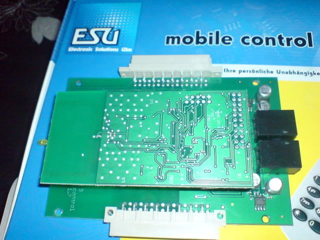

I wish to connect it to my ECoS. From reading the web it seems I remove the top board as shown below and insert it into my ECoS after using my lokprogrammer to change the software.
Is this my only option or can it be connected straight to the sniffer port?
I have noticed a lot of chat around which is better, the new or the old software but can't find too much info in English about the differences.
Also, when I power it on all I get is "netzsuche" which I gather means searching for network or something similar. I guess I have to connect it up before I can go any further.

Congratulations Rob, I paid a lot more than that for mine.
You can put it through the ECoSniffer without the software update I believe.
You can change the language on it but you have to get it communicating with your ECoS first. It will stay in "searching" for eternity until it communicates with your ECoS. Be aware the batteries are running down while this happens.
The circuit board on top does seem to look the same as the one that comes with the Mobile control for ECoS.
Does it have a series of pins in single line underneath?
It's a great extension to the ECoS and I have found that I use it a lot. I did a review of it here which may contain some helpful information. I had to translate the manual from German as there is not an English one available for the Mobile Control for ECoS.
What software update are you on Rob as you need at least 1.1.0 I think to have the software for the Mobile Control for ECoS to operate.
