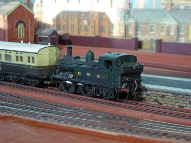

I retrofitted mine with a Comet chassis.
This was a lot of years ago but I recall it being one of my favourites. It ran very well but as has been noted, didn't have much tractive effort. Then again it only had to pull an autocoach and sometimes a fish van. I sold it some time ago.
