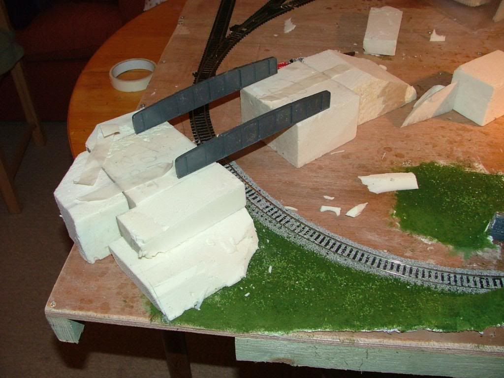

To make Hills, Cuttings, & any Features I have been using only 3 products.
1. Kingspan.
2. Mod rock.
3. Lightweight Filler.
The above products can be found at you local builders merchants & craft shops.
Kingspan is an insulating product for the house building market, this is easily glued & cut to shape with minimal mess.
Mod rock, you know what this is.
Lightweight filler, this just like icing a cake !
Easy, quick drying & cheap.
Or I am a fool !
Enjoy........................
