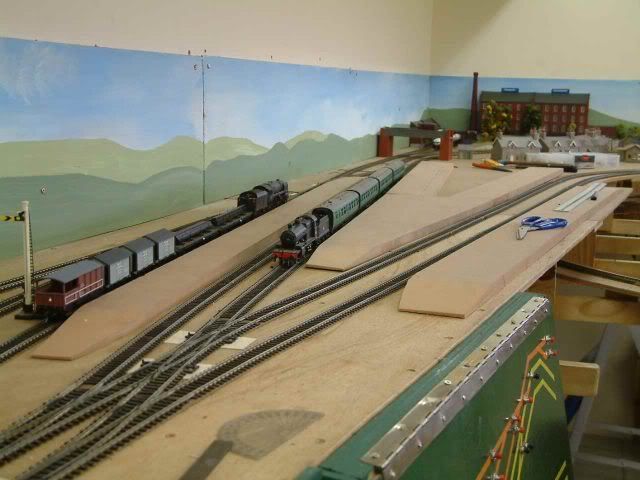

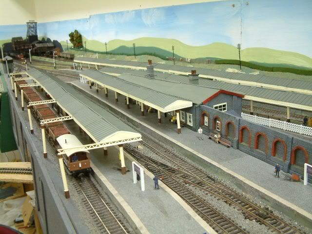

They cover the development of my attempt to model Mangotsfield Junction located between Bath and Bristol.
This is a photo as the junction was developed

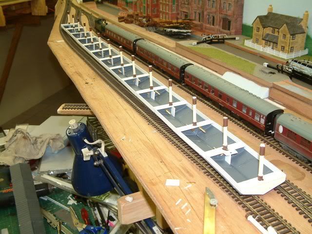

This was my method of building the station Canopies which were very long

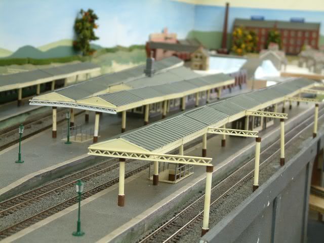

This view shows the station building which I could onld guess at due to the lack of good photo's
This is the canpoies from another angle
Another station view

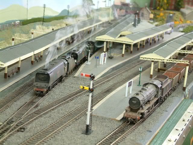

Main line action sound and steam

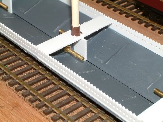

Here DwD you can clearly see the method of construction, basically Wills canopy bodies glued and bolted together because of the length. Plastcic tube used for the supporting poles with the same sized bolts expoxied into the platforms to support them.

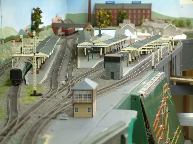

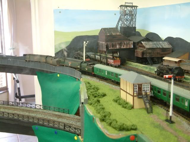

Afew more pictures of the same subject. Ced Dee will be pleased to know I even constructed a carboard mock up of the scratch built station building.
This is the mine complex on the other side of the station
My impression of the Chocolate factory
Just to show I replaced the signal Colombo

The coal mine is just a bashed around Faller kit. I learn since that there's and brass etch for the head gear and that the winding drums are available as well, it would certainly give a more British feel.
Modelling Aspects of the coal industry/ further aspected of the coal industry are to books I use as reference.
Rob Johnson.
Wright Scale Burnside, Adoyne, Aberdeenshire AB34 5ES 013398 86494
[email protected]
for details. It's lovely stuff if you don't mind scratch building the rest of the pit. I don't imagine the brass etches are cheap, but you would end up with something really special.
