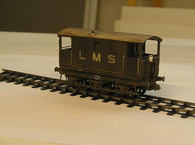

Last night I weathered it:
There is a small change. A friend of mine suggested that there might not be a bodyside number and that it might have had just a solebar ID plate. This is consistent with the only picture of the LMS version I could find (Modellers BackTrack Vol 2, #2) where the solebar plate is quite prominent. I therefore used Powerpoint to create the tiny plate you see in the picture.

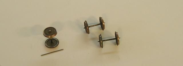

The wheels, while quite nice are 12mm dia so not suitable. I found some Gibson wheels.
I will use Bill Bedford W irons:

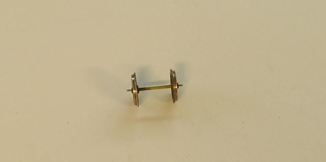

Something Bill said on another forum the other day got me thinking. He was talking about how the real thing copes with the center axle, which is to allow it to move from side to side. I have encountered many complicated ways to do this but his solution is very simple. Mount the wheels on a tube 22mm long for EM & P4 and insert a 26mm long steel rod. The rod goes in the pinpoint bearing.
It just so happens that the Gibson wheels have 1.5mm axles and, in my scrap box I had some brass tube that is a smidge over that. I also have some 0.032" steel wire (used for Tortoise actuators), which by a remarkable coincidence fits very nicely inside the tube.
Here's the wheelset with the steel rod inserted. What a good do.
