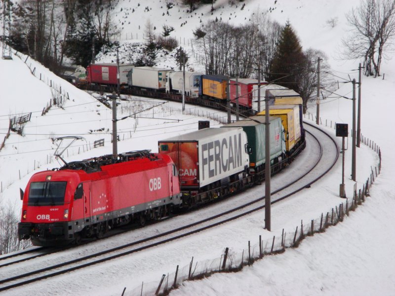

Hello all,
Snow is a significant form of precipitation on any Alpine railway and so as a modeller of the Austrian and Swiss national railways then I would love to have a section of my layout representing winter.
Has anyone tried modelling snow and can they recommend a technique? Have they seen it really well done on an exhibition layout anywhere, or on someones website?
One advantage of snow is that it covers everything uniformly so once you find a convincing way of doing it then modelling a large area of wintery terrain becomes quite simple - just place all the trees, cars, black paint for paint roads, houses, streetlamps and anything else you want to see poking out of the snow...and then blanket the whole lot by your preferred method!
