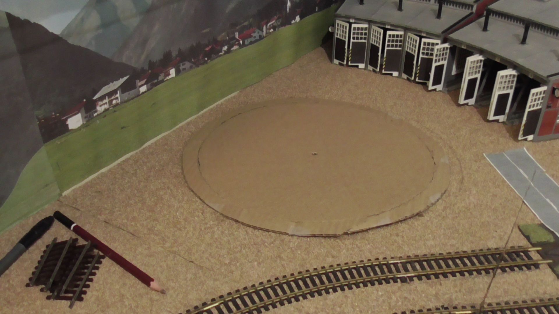

A few weeks ago, as mentioned in an earlier post, I decided to re-install my old Fleischmann 6052 turntable that was used previously on my layout.
After retrieving it from the storage area of the loft I discovered it had too large a diameter (38.5cm) to go where I wanted to site it (the only place really if I wanted to re-use the Fleischmann 6476 loco sheds, which I did) I did look at alternative roundhouses, but all the kits that would give me 6 engine sheds were a lot wider overall than the 2 x Fleischmann 6476 sheds and again, I didn't have the space to fit them :(
So I looked into alternative (smaller) roundhouses and found that the Roco 42615 was a fair bit smaller at 30.8cm overall diameter which was more suitable for the space I had available.
So it was off to MSL site to order one.
The obvious compromise is the track bed length, which will accommodate locos up to 250mm wheelbase.
Also, it has code 83 track, so some transition pieces from my code 100 Fleischmann brass Model track will be required.
Decided to get one of theses too.
This will allow me to control it through the Z21 and Train Controller Software (once I figure out how to configure a turntable in that :rolleyes:)
Back soon

I decided to get some Rocoline code 83 track so that the outgoing tracks to the sheds would be more straightforward to install, and got a pack of Peco SL-116 code 100 to 83 transition track for the entry rail.
First job was to set out the positions of the turntable and round house to achieve the correct exit track angles and positions, for this I used a cardboard template.
Once I was happy with the position, I cut out the circle in the baseboard using a combination of a Dremel with a 678 Line and Circle cutting attachment.
and a Bosch Keo small cordless jigsaw.
Once that was finalized, I could go back to my existing track layout and plan a route to the turntable which would give me access to the main lines, and branch line via the goods depot and on to Schwarzburg station and another platform access.
As with the rest of this extension to the original layout, I have used Peco PL-80 wired track joiners for the droppers, at this stage (due to the hour and not wanting to make too much noise), still to be drilled down through the baseboard. I have also got some Peco PL-81 wired track joiners for the code 83 tracks on the shed side of the turntable.
Tomorrow I will fix the track permanently in place and complete the droppers.
