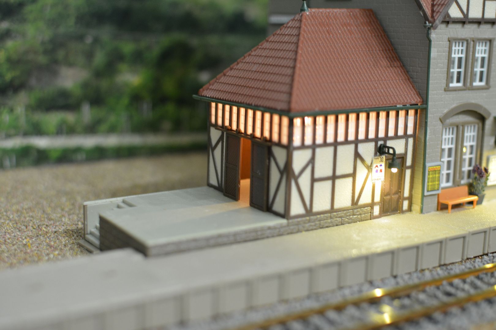

I have completed Schwarzburg station (apart from additional figures and paraphernalia), got it in final position, and finalized platform positions.
The platform sections , apart from the pieces connected directly to the building, are just laid loosely in place for the moment as I still need to fit lighting, canopy's, kiosks ect.
I have ordered some Viessmann 6109's which are the Barden Barden, platform lamp posts, which I may or may not paint green. This is not Barden Barden but I am using its platform extension kits as already mentioned, and they are a nice looking lamp.
Once I have those, I can work out how I'm going to position them in relation to other parts, then I'll be able to fix down and join together the platform parts to make it look neater.

Hi Alan I have to say it looks fantastic. I know these kits are not cheap But they sure are worth it. The lighting you have done is very effective indeed. Nice One. Babs
The platform looks good and well worth the effort of having a consistent design.

Thanks Babs and David for your comments. Faller do make lovely kits although I have added to mine a bit. The kit did supply 6 empty flower pots to position outside the open waiting room, but I added some Noch flowers in pots in those positions and elsewhere on the station as I did with Waldbrunn station.
David, yeah I'm very pleased with the way the platform conversion has come out, and as said, once I get all the sections properly joined together it will look a lot better.

The external lanterns on the station are Viessmann 6087, which I painted green. Internal lights are Faller 180671, as mentioned in the kit. I already had several of these so I used them, but they might do a LED version now.
