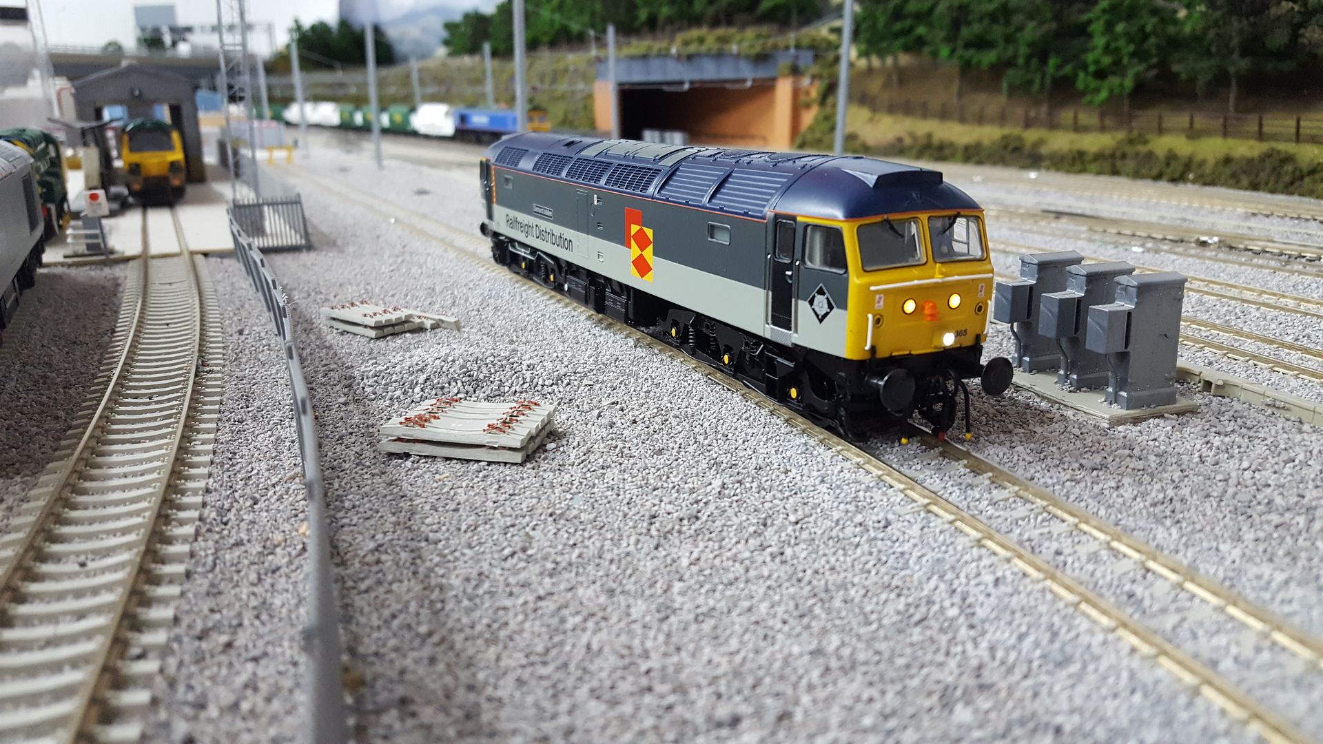

So spent a few hours putting locos etc away as i am planning on doing a bit more scenery detail this weekend and found an 8 pin sound chip with class 47 sounds on it so I thought I would put it in this ..
However this is a Bachmann and it's 21 pin ... so had a dig around and found these two Heljan 47's ...
So I put the sound chip in Rebecca with two sugar cube speakers.
And put one of my std DCC Concepts chips in Demelza

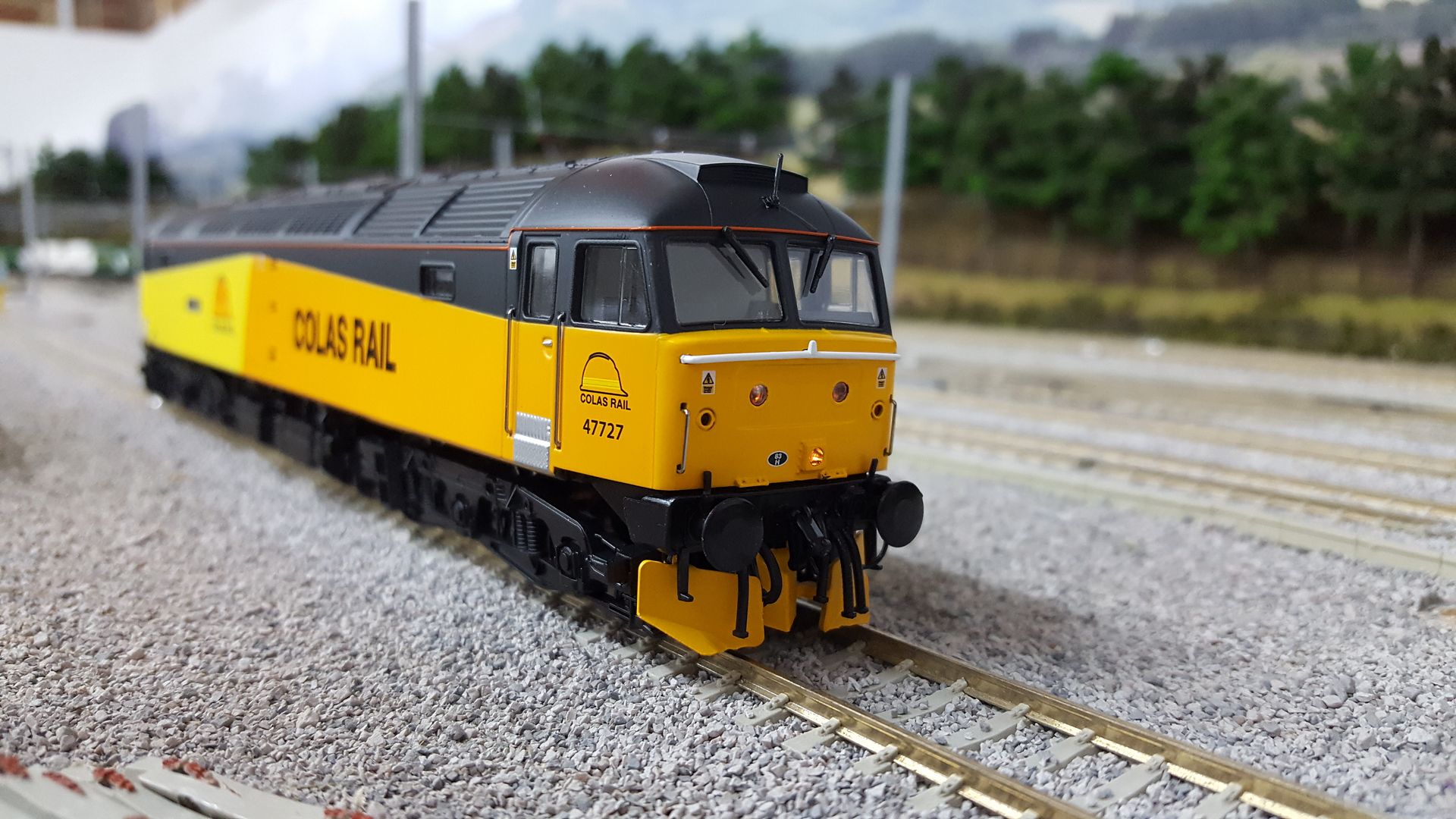

Discussion Starter · #842 ·
QUOTE (reddo @ 29 Apr 2017, 05:24) <{POST_SNAPBACK}>Very nice. Those COLAS are a great pair.I did a quick check and amazingly I have them also...like you, somewhere :)
Liveries like Colas are one of the reasons I like modern locos as having lots of colour just looks better then a field of just green
Although i do like steam

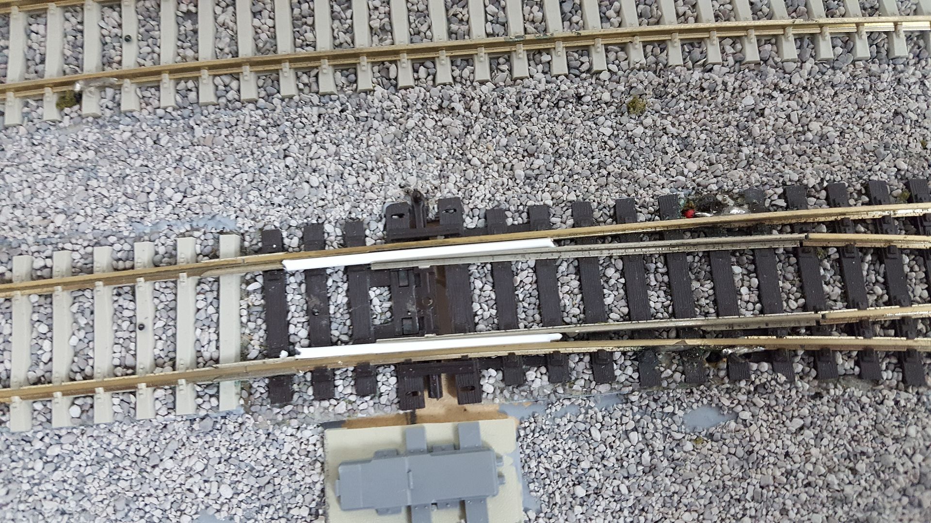

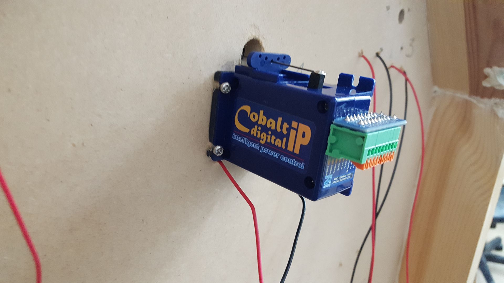

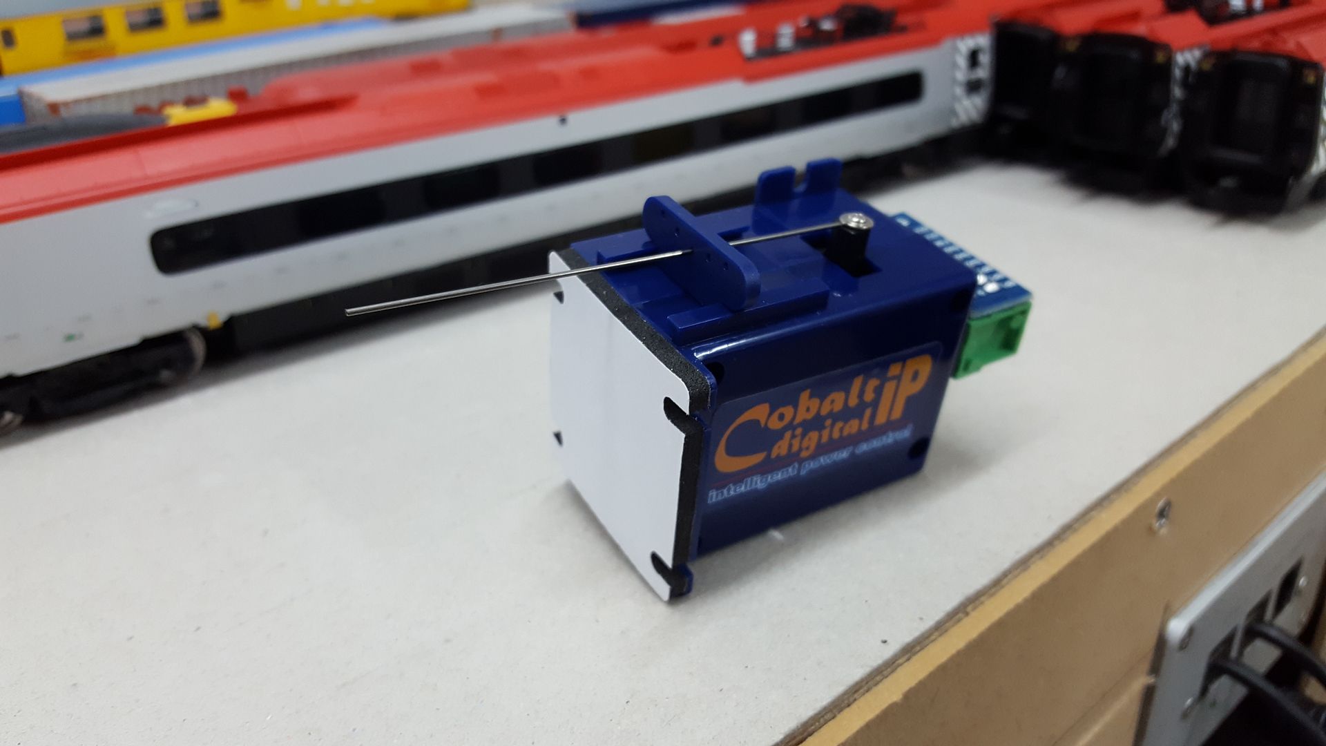

I have had a few messages about installation of the Cobalt point motors ... i have a few photos of the installation steps and i will record a small video of setting a point motor up on my ECoS and on my Alpha control panel.

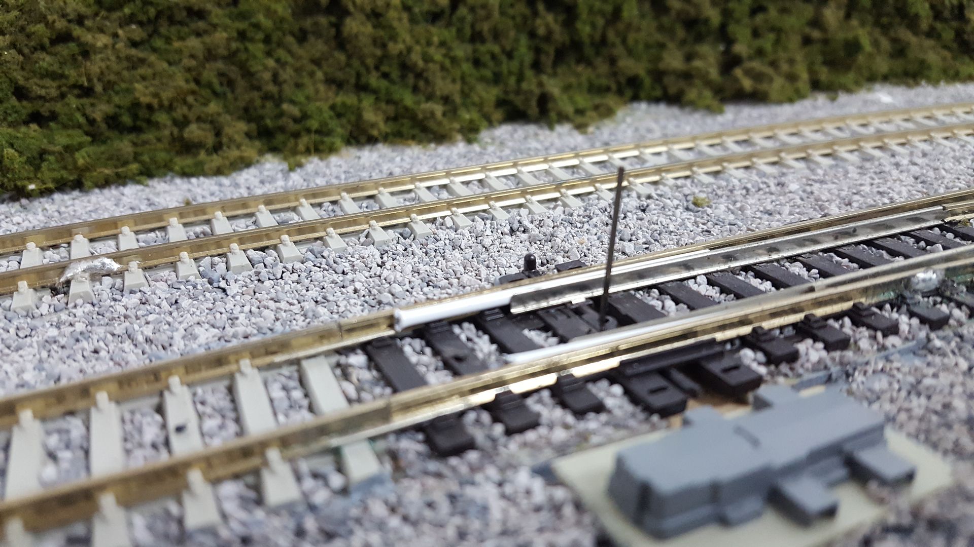

The first thing you need to do is centre your point .. i just use two small bits of plastic
Once you have done this you need to set up the motor itself. .. add the adhesive pad and install the wire to the motor

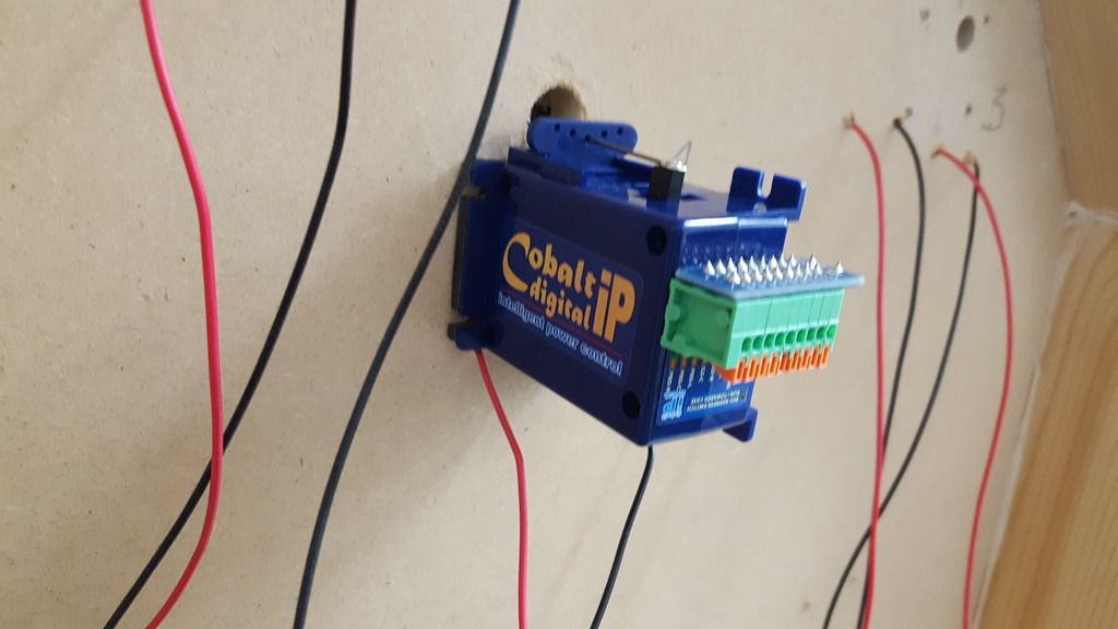

The next step requires you to stick the point motor to the center line of the hole under the point itself making sure you insert the point motor wire through the hole in the point tie bar.
I have drilled 8mm holes directly below the point tie bar ( i drilled these holes when i was laying my track ) once you have your point motors in the correct position then add the four supplied screws .... Remember not to over tighten these screws as this could pull the motor out of shape and affect the operation of the Cobalt.
Do not cut the point motor wire arm until you have completed the point motor setup as they are supplied centered and if you cut it to close to the tie bar hole this may affect the operation of the point.

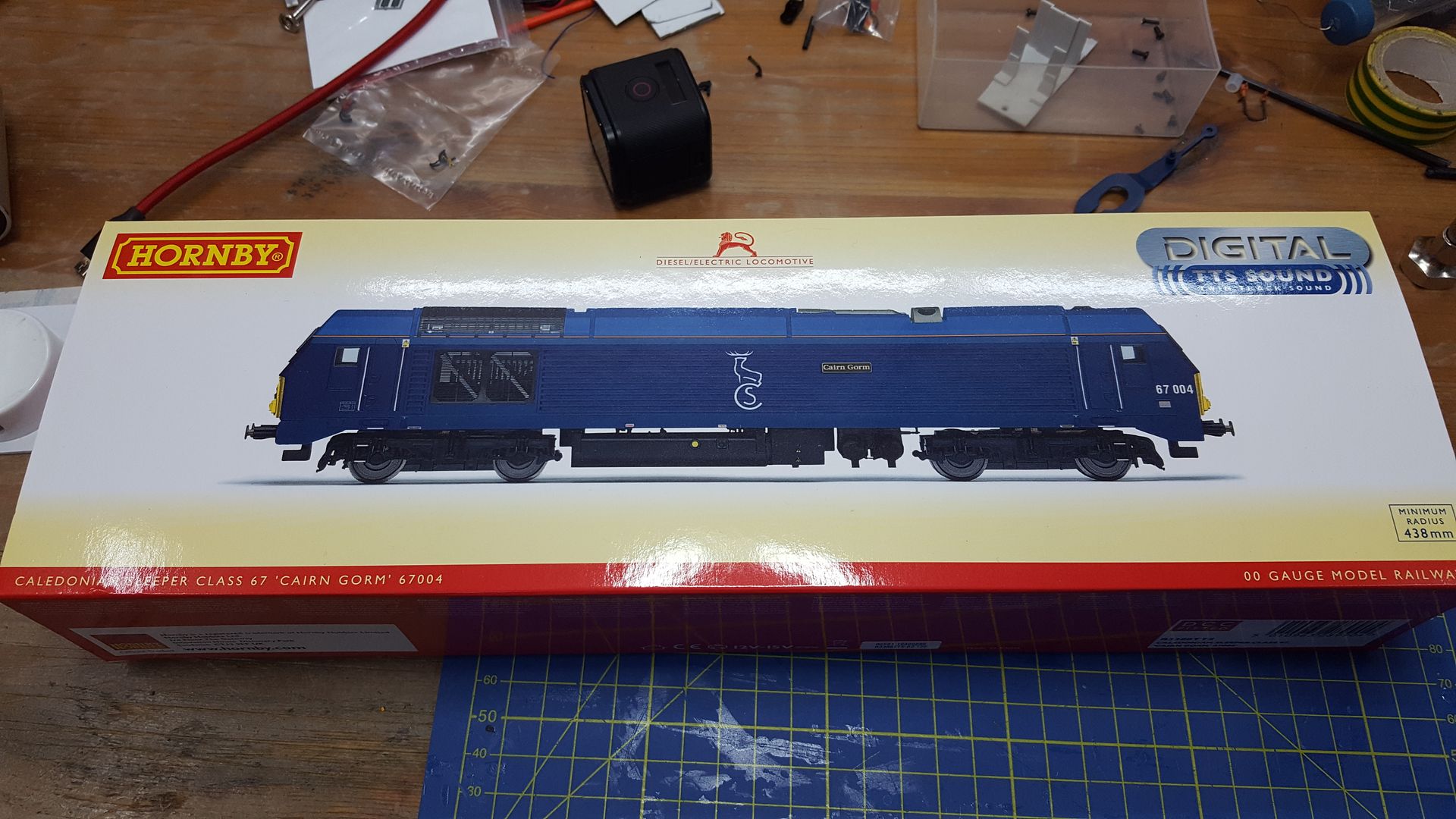

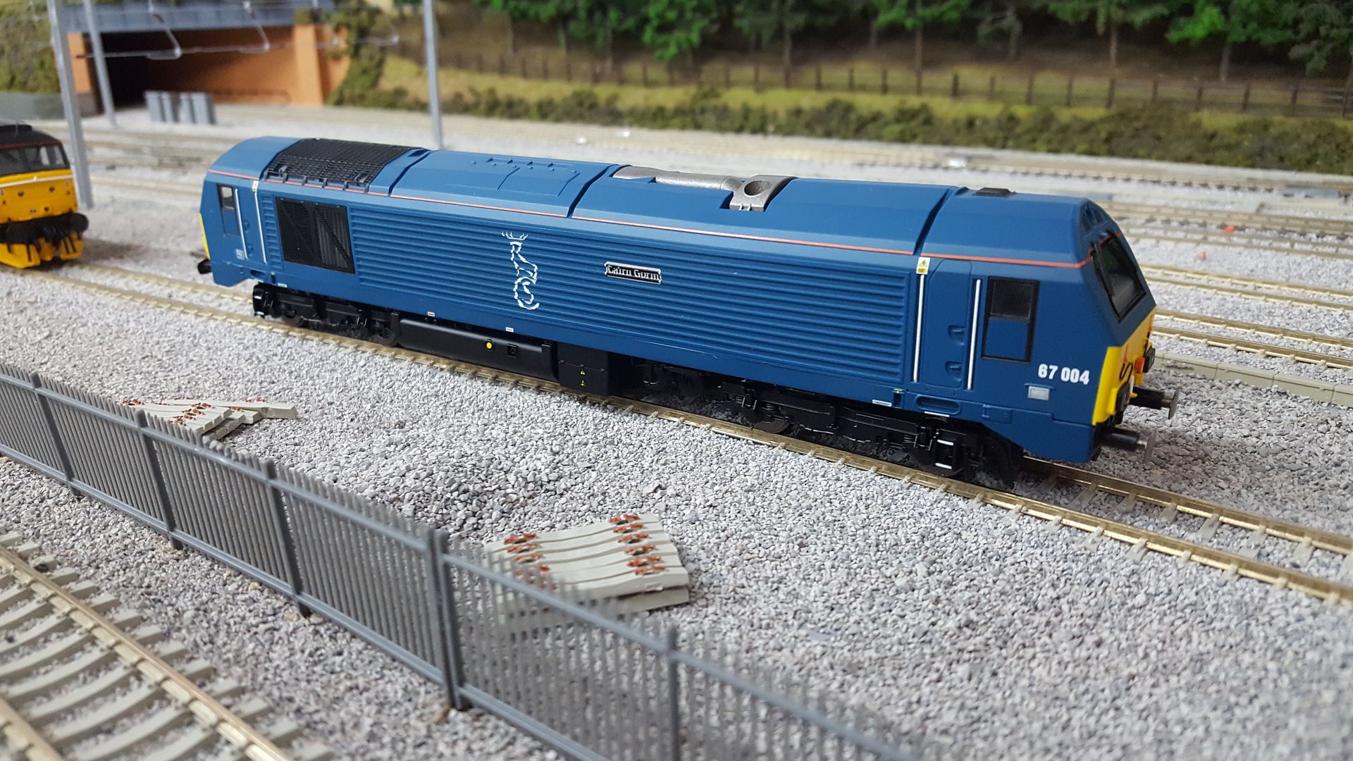

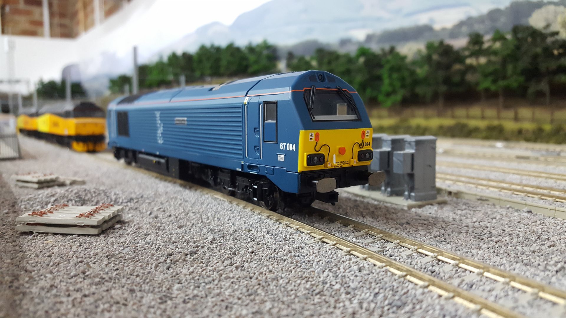

I decided to treat myself to a new class 67 with TTS sound to see what they are like and as they are only £100 atm i thought that was a good price ..
Very nice livery and a nice heavy loco ... i do have a few of the class 67's in EWS and DB livery and i do like them.
The sound on the loco is not bad at all im quite impressed if anything i think its just a little high pitch so maybe a base reflex speaker might help im not sure as the unfortunate problem is the loco does not run at all .... so its being replaced all fuss free by the supplier so no issues with that.
But in short TTS sound is very good for the price and i do recommend it.
