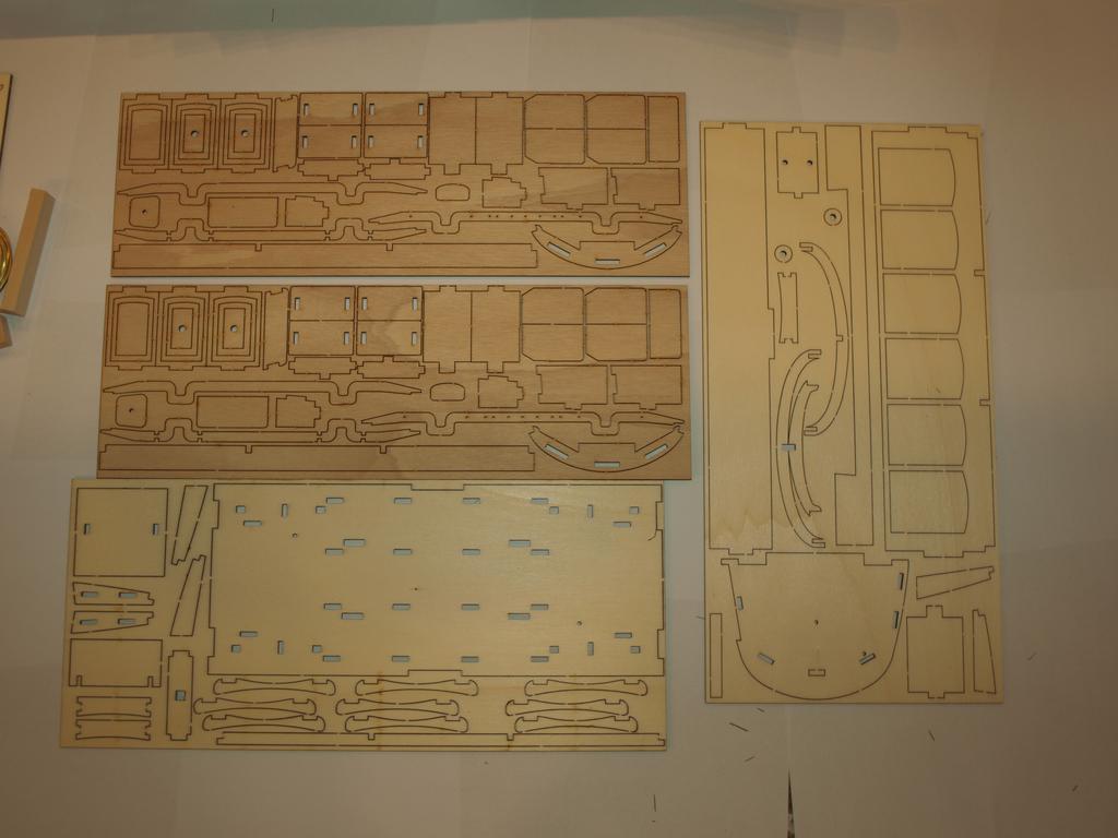

Kit taken in my country from Kreativity World shop, here specifications and measures..
https://www.kreativity-world.com/it/prodott...ccre-53005.html
Kit box content:

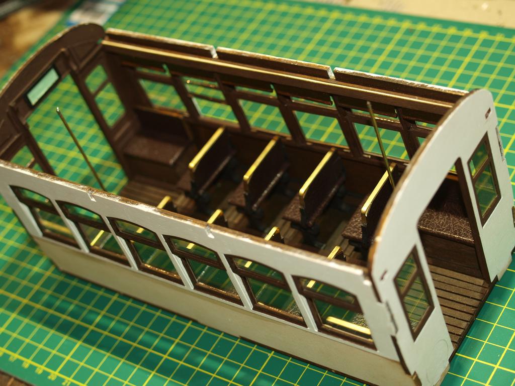

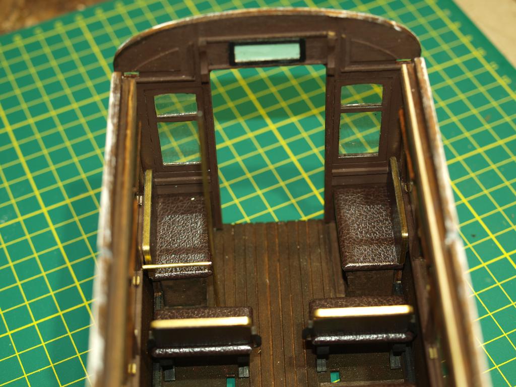

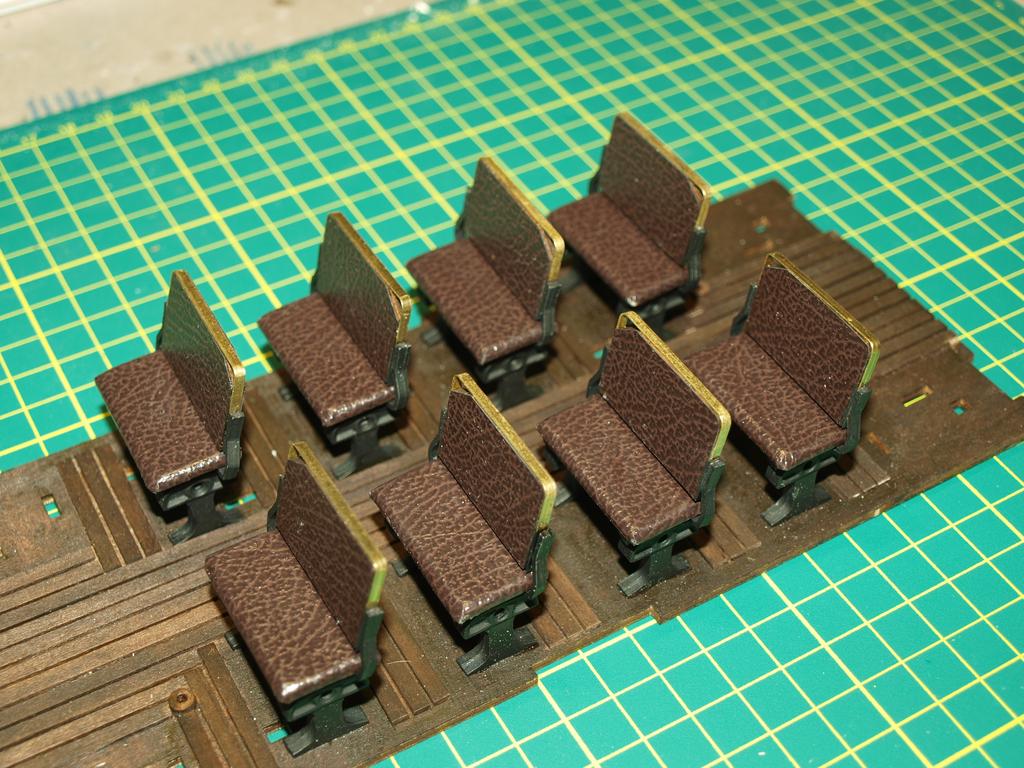

Build log start from floor and seats

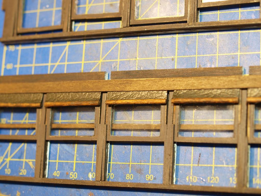

I use real 1.mm glass to make windows, is a box of microscope slides.
I prepared a frame to cut the glass.

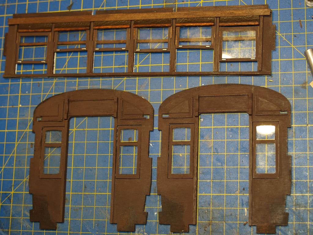

I have adjusted microscope glass with a thin wood strip as to fit inside frames, casually my glass microscope slides have one side 1mm less than frames, I chose to fill it.
OcCre Kit windows are basically glued, I have tried to make it openable.
I also add some details to walls
34 Posts

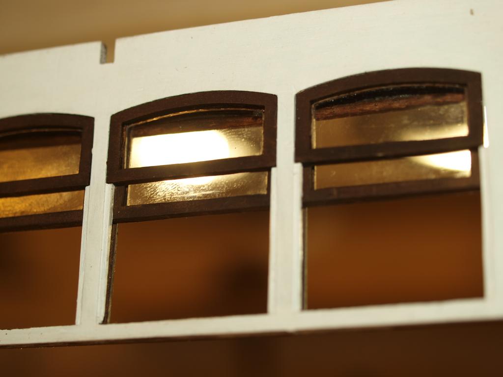

Inside roof and Led lights
light made with a washer and a brass ring
The front panel have 3 Led lights
