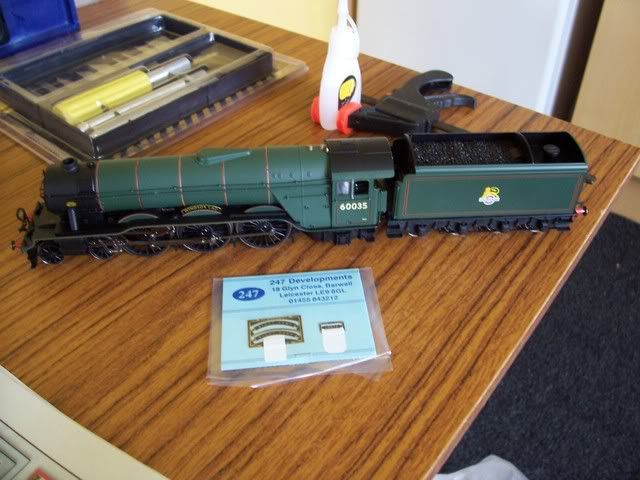

The Postie came a knocking yesterday and left me this
Nice loco shame about the name (for me that is)
So already having picked out a name I like better and having already purchased the nameplates I set about renaming her today.
On closer inspection I noticed that the smokebox dart was missing so I've replaced it with an Alan Gibbson that I had in stock.
The renumbered loco
And with one of her stable mates
who's also had a name change a familiar number to all of us here
