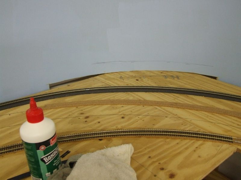

I didn't get so much done this trip as other things got in the way, house repairs and other stuff. I did however manage to get into the shed and put up some more woodwork and trial fit the curve onto the embankment which will lead into the yard area.
This curve is laid at 48" radius with roughly 60" easements at each end. I may have to tighten these easements up to 54" as I want to add an extra turnout for a helper siding at the top of the grade.

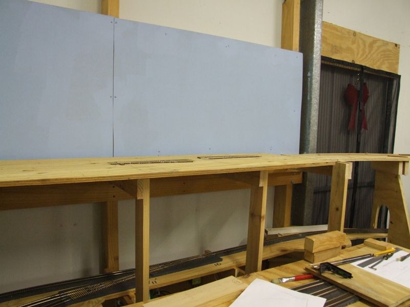

These will support the enrtance to the yard throat. I'm thinking of raising the main line about 6 inches or so on a elevated trestle so the main line doesen't interfere with switching operations in the yard. Yard will connect with the main line at either end.

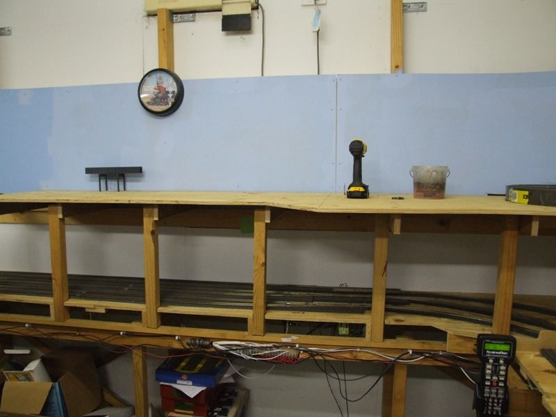

Upper deck supports. As the lower staging will for the most part be in darkness I'm going to fit LED strip lighting along the front edge of the upper deck. I'll face off the lower staging in a shadow box effect.
Well that's as far as I got so that's it for another 6weeks. More plywood should arrive before I get back so I can make a start on sheeting the upper deck. Now I have to start and make turnouts

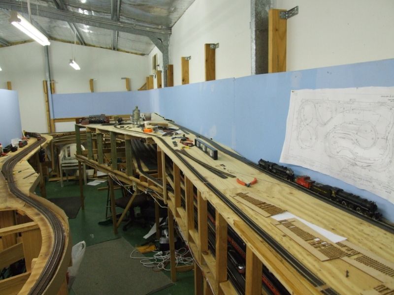

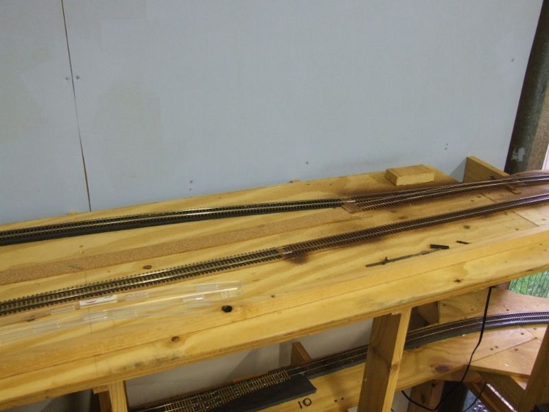

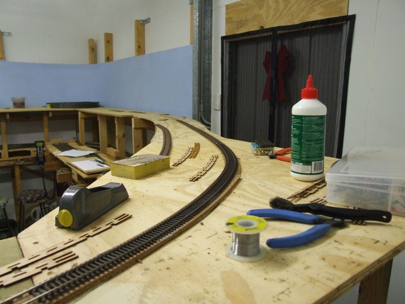

A little more work done in the last couple of trips but not as much as I had hoped for. I managed to extend the previous effort around onto what will be the station/yard area and lay a bit of track and add some LEDs to give turnout indication. I should have used bi-colour LEDs but it's easy to change.
Where the plastic bridge section is shows how high the running main will be elevated along the backscene board. This will run for most of that wall, 30ft.
it's taken about 3yrs to put a piece of track on to the back of this turnout. The extra 2m's allows me to run around a train
With this extra 2m in place I reckon another 156m should finish it off. When that will happen I have no idea.

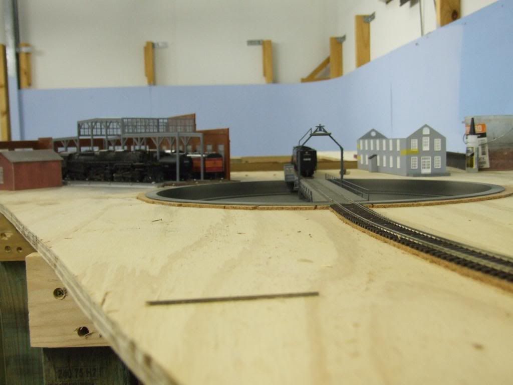

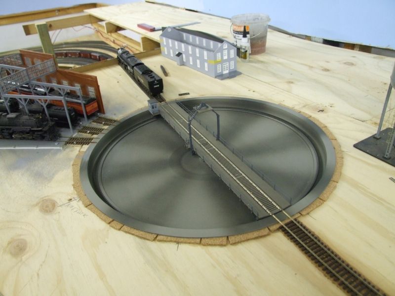

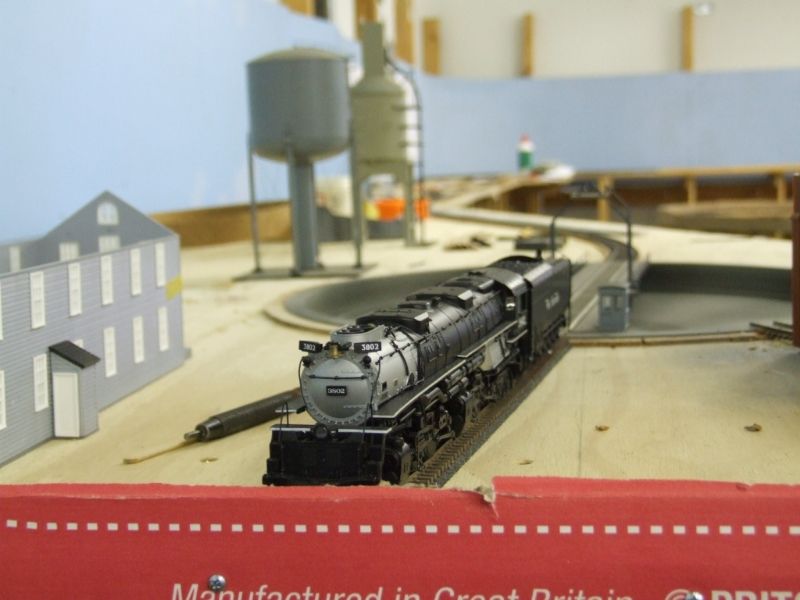

Okay, I finally got some more work done. Big job was installing a Walther's 130ft turntable, needs to big for the Alleghenies and the Big Boy. This should have been fitted the easy way by cutting the hole when the base board was still on the ground. But no I had to do it after I fitted the base board to the bench work which is 5ft high.
That made it tricky to reach so to sum up I cut the hole not only in the wrong spot but slightly to large as well. Luckily I had a sheet of 1/8th ply which I used for a gap filler. The turntable is fully digitalized and indexed so with the push of a couple of buttons locos can go for a ride. Next I had to lay some track temporarily so I could run a loco on to the turntable.
Then I had to position the roundhouse which of course was not where it was planned so it's only 3 stalls instead of the 6 I had planned for. So to make up for it I'll make space for some house/ready tracks off the turntable. Of course one little error puts everything else out so the buildings in the pictures are only posed. The roundhouse is fixed in place.

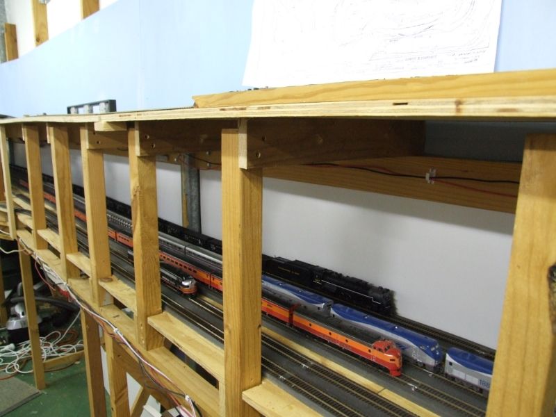

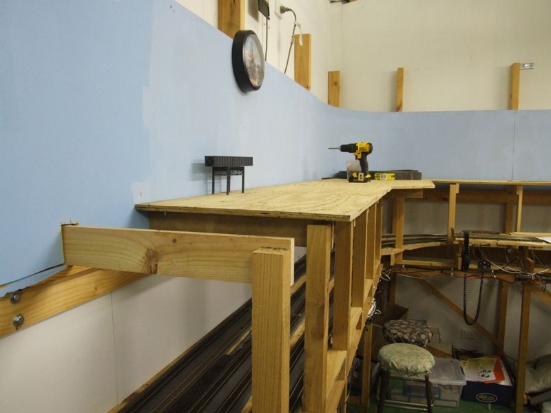

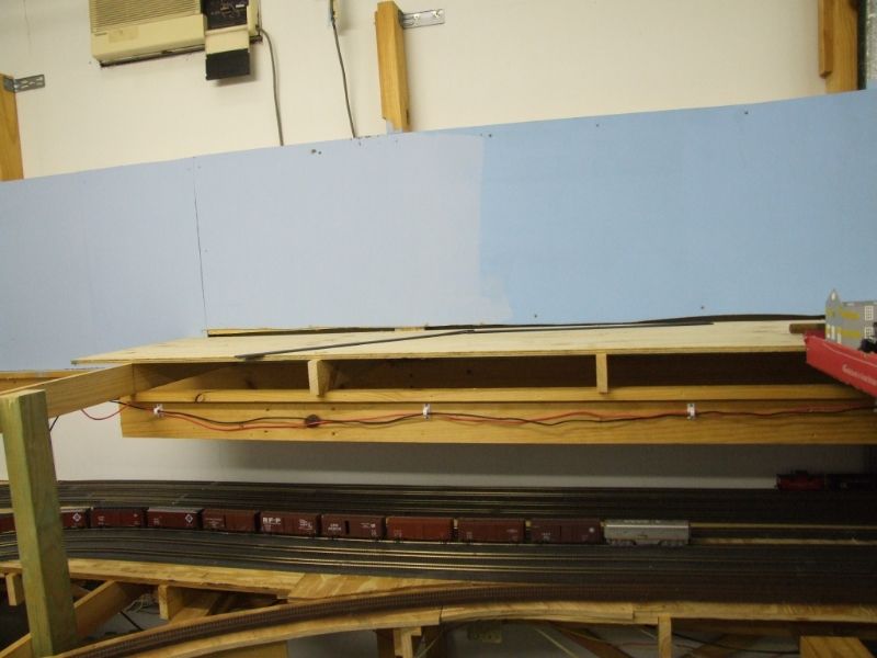

This is the staging tracks underneath. I'm not happy with the 2x2inch posts so I'm going to make wooden C channel out of a piece of 3x2 and two 4x1's. Should be strong enough to hold the upper deck up with minimal bracing.
One Walthers 130ft turntable. As it's digital I power it off the accessory bus.
Other buildings positioned just for show.The grey building will be the enginemens bunkhouse. Seemingly they were run by the YMCA in the past.
Athearn D&RGW Challenger sitting on the turntable run off track.

Neil,thanks for the comments. When I go back next time I should be making turnouts but I haven't decided whether to go with a No6 or a No5 in the yard. It depends on the big steamers as to how easy they navigate a tighter turnout. If I'm still thinking about that I may lay a bity more wood work, get rid of the 2x2's and fit the "C" channel.
