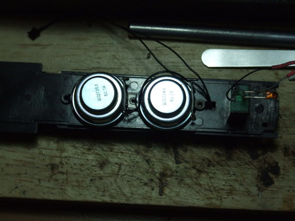

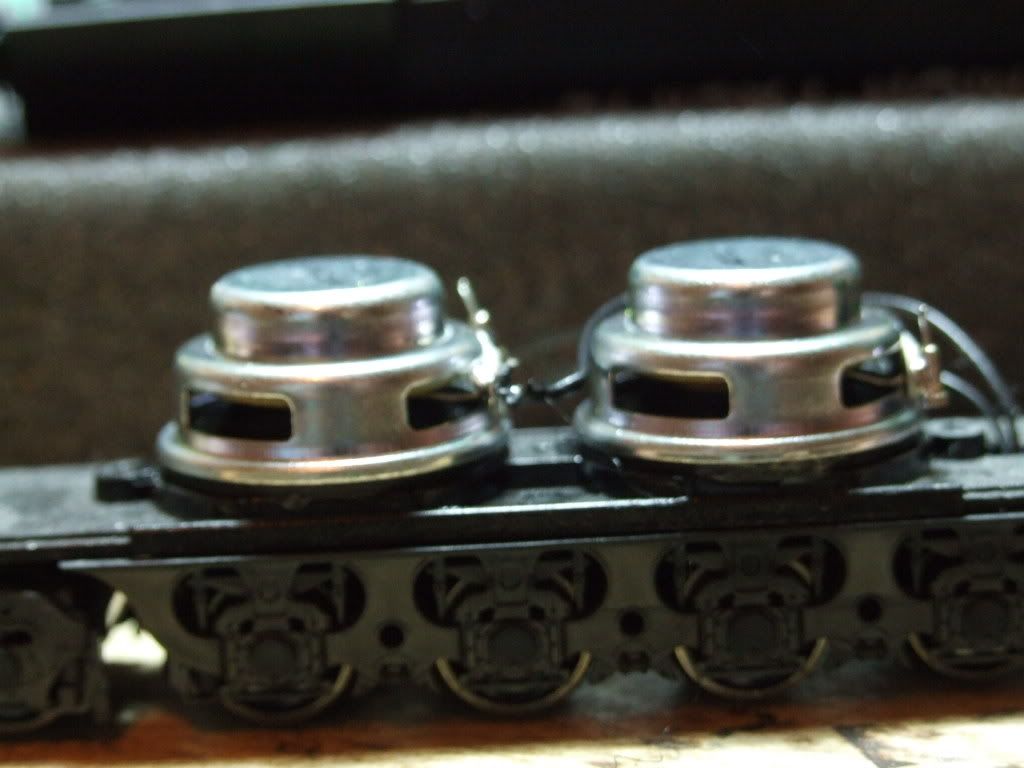

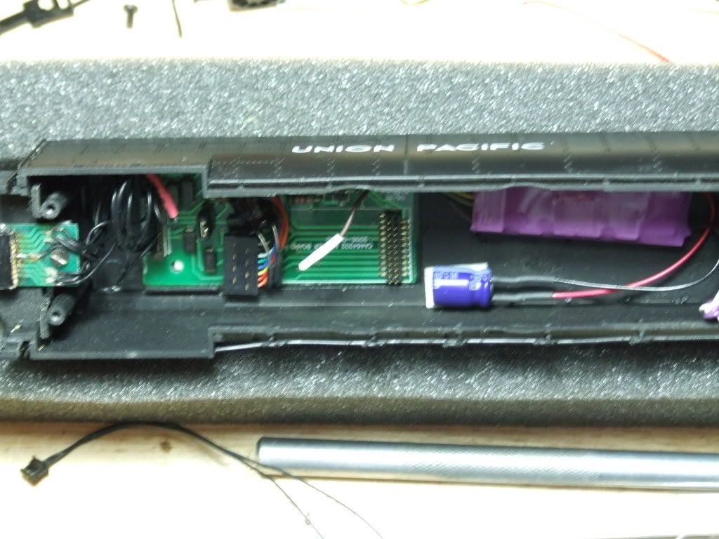

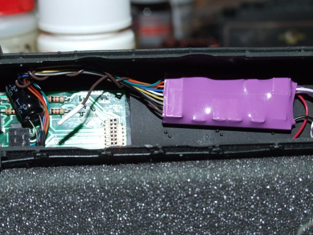

A friend had a PCM Big Boy that he was never happy with the sound or the smoke unit so I removed both and retrofitted a pair of QSI High Bass speakers and a Soundtraxx heavy steam Tsunami. The speakers are 1.1" in diameter and at the front have a seal ring that projects out about a 1/64th of inch. I smoothed off the seal ring by lightly dressing it off and this just fits on the raised rings cast on the floor of the tender. I would have used larger speakers but as the big boy tender has a curve at the bottom of the tender that restricts fitting anything wider than 1.25". You could use larger speakers but they would have to fitted inside the tender using some sort of mounting and some sort of seal between them and tender floor. The QSI high Bass speakers are an excellent speaker with much greater dynamic range than the standard mylar speaker. This doesn't mean they are any louder but it is the clarity of sound they produce that make the difference. Unfortunately they are only available in a round format in the smaller sizes at the moment. I have fitted a 1.57" into a Bachmann On30 2-8-0 and th owner was more thany happy with the result.

John, that depends on what you really want. The Tsunami is probably a bit more work than the Loksound. I have tried a Loksound 3.5 but I didn't like the sound although I was perfectly happy with the motion control. The Tsunami requires more effort in the tuning department to get the sound right but as with all sound that's more on how you percieve the sound to be but I consider the polyphonic sound of the Tsunami to be superior. Control wise the Loksound possibly has the edge out of the box. The Tsunami again requires more effort in the tuning department to get it right but again it's what you percieve to be right. I took me about 4hrs to "tune" the sound and motion using "Decoder Pro" to get it where I was happy. Big Boys were designed to operate up to 80mph but rarely ever acheived those sorts of speeds, drag freights were more the order of the day so I've tuned this loco to operate more in 30 to 45mph band. Challenger class 4-6-6-4's were more of a high speed loco and were reguarly clocked in the 60mph range in the flatlands.
