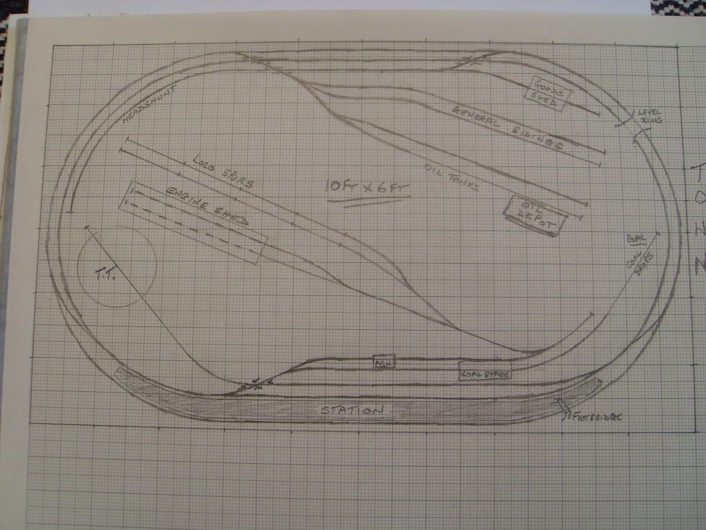

Well as I am going on holiday for 3 weeks, I thought I would commit myself into building a new layout on my return. My last effort was a 9ft x 4ft point to point with continuous run, but the curves were too tight and lots of locos can't run properly on it. So it will be ripped up in the near future and a new continuous run 10ft x 5ft (or 10ft x 6ft if I can squeeze it in) will be built in my garage.
The new plan will be a purely fictitious station, MPD and goods yard somewhere on the North Wales Coast line.
This is an 8ft x 4ft version designed by S. Jay that I will slightly modify.
There are several reasons for choosing the North Wales location (even though you won't glimpse the sea on this layout!).
First I am a LMS man even though I was born in GWR country (Hereford)
There was a large amount of traffic on the line, freight and passenger, especially with summer holiday traffic. Crack expresses like the Irish Mail and small local trains, it's all there!
I can run just about everything the LMS used from small tank to pacific and still be prototypical (except perhaps for the Coronation Scot - I have no record of that - but it won't stop me!)
There was some interesting architecture to be seen on the line.
In BR days, some unusual visitors were seen including B1's and even the Gas Turbine GT3.
I have a large loco stock so I wanted to include a MPD, just to have a few on display and operational.
The design is interesting enough to operate three trains (2 passenger and one goods), with plenty of scope for exchange of engines and also some shunting.
So that is the plan. I will take this thread all the way from baseboard construction, to track laying, wiring (DC not DCC) and scenics (mainly urban).
I will try to salvage some stuff from my old layout but there will be a new LNWR station building, Bangor style footbridge and other interesting bits and pieces. Other bits, like Engine Shed and Signal Boxes, I have already prepared (see Ray's Building Site thread below).
That's all for the moment, will continue in May, all being well.

Ray , Know the North Wales lines well , used to stay there at weekends as a teenager . We could see the trains from the "bungalow" in the dunes . (Bungalow made from old Victorian carriages , complete with fittings from old passenger ships , and a proper cooking "range" , even had Victorian oil-lamps , All Bulldozed in the early 70's when the 99 yr lease ran out . Now a massive caravan park !
Nearly forgot - The line on your plan needs to be a twin track - I do have pics of Loco depots etc in the area if you want any
Graham
QUOTE (Capt Jango @ 6 Apr 2012, 12:09) <{POST_SNAPBACK}>Ray , Know the North Wales lines well , used to stay there at weekends as a teenager . We could see the trains from the "bungalow" in the dunes . (Bungalow made from old Victorian carriages , complete with fittings from old passenger ships , and a proper cooking "range" , even had Victorian oil-lamps , All Bulldozed in the early 70's when the 99 yr lease ran out . Now a massive caravan park !
Graham

I will see if I can squeeze in a double track, but I could also do with a couple of storage loops. If I can make the width 6ft it will ease things a lot, including tight curves.
There will be a short "urban" tunnel to disguise the continuous run a bit and also a level crossing by the goods yard. The loco coaling area will also change slightly to allow a Bachmann LNWR type coal/water shed plus my ash plant.

Not sure about the Turntable/Loco Shed arrangement though which is not prototypical as locos would be trapped 'On Shed' if the turntable broke down.

Unfortunately, I don't think I can change the turntable arrangement easily. May be able to remove the diesel shed and change the approach. Will have a think!

Looking again at the MPD, the extra length will alow me to make the turntable single line and remove all other outlets. Then take a feed off the r/h coal and water siding to an angled engine shed. Ditch the diesel shed and just have sectioned sidings.
Sound better??
Yep. That sounds better
OK Guys.
I had a quick redraw based on suggestions.
REVISED PLAN (10ft x 6ft)
There are four double-slip crossings! (the X's)
Let me know what you think ! (No rush - you've got 3 weeks!)

Love the new plan mate. Love the idea based on North Wales coastline! Me and my best mate used to ride behind 37's (of course) in the late nineties and my new 'large shed layout' is loosely based on that aswell.
Looking forward to your progress pics etc.

Hi RAY I like your plan how long are your longest trains going to be 4/5/6 coaches and are you going to put your gantry signal box on your layout?As you know i'm starting my layout soon so i be followings your progress with interest and no doubt plenty of questions.Hope your holiday goes well not all work, history is a great subject and one that interest me all though i don't think i'll be doing a degree. Swmbo has one and says keeping your essay under 2000 words will be the hard part but anyway good luck with that and enjoy your time out! Cheers Jim
Hi Jim, about 5 - 6 coaches I am hoping. Yes the gantry box will go at the top and the tall box by the station. Retaining walls at the top.
