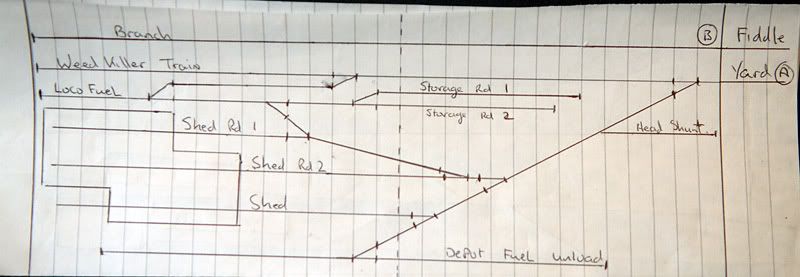

Hopefully a rough track plan of my layout is attached?
I`ll descibe the basic operation and you can then tell me which bits are ok, possible and rubbish!
Movement 1
DMU enters layout (10x 2 ft) via track C off fiddle yard traversa (6ft conected to track C +
and crossed over points 1&2 to exit layout via track A or it stops, then exits layout via track B.
Same for light engine.
Movement 2
Top and tailed 3 coach train enters from fiddle yard over track C runs into Track D. It later then returns to fiddle yard the same way it came in.
Movement 3
Frieght train enters from fiddle yard via track C and runs into track D, stopping between points (4) and (20). It the runs round via point (4) onto track E then crosses to onto F. Stops, then backs onto the rear of the train on track D via points (21)+(20)
Movement 4
Light engine comes onto layout via track C enters Depot via point (3) and runs onto track G . From here it can either run onto Track H which is the re-fueling road and then it can be stabled on the depot somewhere, or if it does not need fuel / sand it can enter the depiot via track K or use point (7) to enter the depot.
Movement5
Fuel train.
Loco and occasionaly a stores van (when Bachman bring it out!) plus 2-3 TTA enter layout via track C and moves onto track G. It then backs the TTa into the tank road, track J and then backs the stores van onto track K. The stroes van is picked up by the depot 08 and moved to the stroes road, track M. The loco goes for fuel if needed or just finds a road to wait in.
To leave, the 08 take the stores van and TTa's onto track G where a loco attaches to the front and then leaves via point (5)+ (D1)+ (3) onto track C and fiddle yard.
There is a lot of track on my layout, but it was initially designed for use at home, and this is where it is used most weeks. I can quite understand someone saying there is too much track squeezed onto the boards, but then I like to see empty tacks! Sometimes they are full granted, but as all Locos have sound not everything is running.
Track S is supposed to be access for road transport
Track Q is an old inspection pit at the back of Shed road 1, the idea being it was left over from the sheds steam days, just incase its needed.
Track R is a small holding road that sometimes one of two snowploughs occupies.
Tracks T,U,V are holding roads, perhaps for locos that dont move much.
Track M is either used for a loco to sit in, or on the odd accasion a stores van enters the depot this is where the toilet roll is unloaded!
Track H is the fuel and sand road, locos can enter and exit from either direction though only one can re-fuel at a time, a second loco can sit in the road awaiting its turn.
Track J is where 2-3 TTA unload.
Track I is a short road, just long enough for 1 TTa or the 08 to wait in.
So whats missing (catch points) whats rubbish ( i dont mind you saying everthing ) whats nearly there and what seems ok?

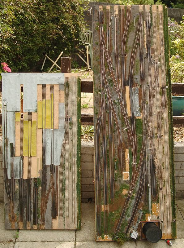

Rimenough mk 3 was scrapped yesterday!
See pics below, just got a couple of yard lights, buildings and whatever track can be salvaged to come off. Had to take it down as i wanted to do a bit more on Olivers Road over the next week.
Will have to start "New rimenough" ( 2 x 5 x 2 foot boards )next week though as the layout is booked to go out in October.
Will have a slighlty different track plan than old Rimenough, will be changing some buildings etc as well to give it something different again.

This is the mk 4 track plan, well at least for today! You know how it is, you find another point, change this, that, then the layout has changed completley, well thats whats been happeneing.
Got 12 points and only wanted 10! Still, better than 18!
Decided this is 99% how it will stay though as it gives plenty of operation and a change from Rimenough mk 1-3.
The "Branch" line is totally seperate from the main depot now. The idea of the depot is that is supplies top + tailed class 37 for a Rhynmney style service. As such, top + tailed 37 will enter from fiddle yard, idle for a bit while the road to the valley lines is cleared and then depart at speed with thrash (at least as far as the Fddle yard!)
A class 67 + pcv train may well also operate on this line or perhaps a 158.
The reason behind sepereating it was (less points) and it can be controlled by a second operator at will with out interupting the depot action.
"Weedkiller train."
Top + tailed 37 on a wedkiller train (TTA x 2 + GUV circa 2002/3) can be seen coming into depot from fiddle yard and then departing as and when the need arrises.
This line may also see a snow plough train on a test run.

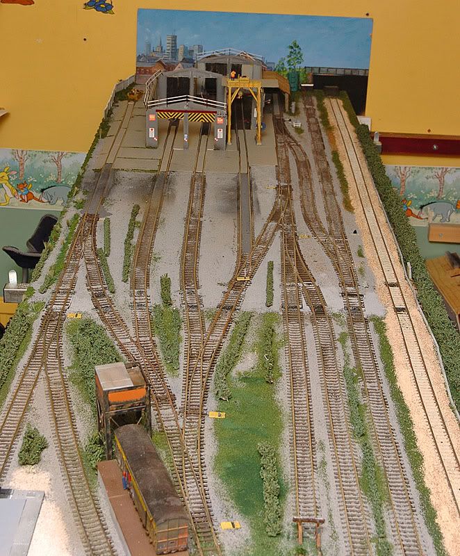

General depot view.

The story so far: Old rimenough Mk 3 scrapped in july?
Oct 2nd
Right, this is the track plan, well at least for today! You know how it is, you find another point, change this, that, then the layout has changed completley, well thats whats been happeneing.
Got 11 points and only wanted 10! can have another though??
The "Branch" line is totally seperate from the main depot now. The idea of the depot is that is supplies to + tailed class 37 for a Rhynmney style service. As such, top + tailed 37 will enter from fiddle yard, idle for a bit while the road to the valley lines is cleared and then depart at speed with thrash (at least as far as the Fddle yard!)
The reason behind sepereating it was (less points) and it can be controlled bu a second operator at will with out interupting the depot action.
Weedkiller train. Top + tailed 37 on a wedkiller train (TTA x 2 + GUV circa 2002/3) can be seen coming into depot from fiddle yard and then departing as and when the need arrises.
Depot Fuel Unload. - a short(3-4) TTA train hauled by whatever is handy enters from fiddle yard, pull up along side of shed rd 3 and then reverses into unloading road. I forgot to draw the storage tanks and building in that (lower right) area of the baseboards. As there is no run around, once unloaded the TTA are pulled forward again alongside the shed, then another loco takes up lead coming from one of the shed roads and departs.
Light engine. - Loco arrives from fiddle yard and can either enter shed road 1, 2 or 3. The Shed is two peco two road engine sheds that have been bashed into a tree road shed, fancied a change from the 4 raod shed of rimenough mk 1-3!
Loco can also go along side the shed (rd 1) and re-fuel. If not going to be in service for a while it can be stored on storage roads 1 or 2
Loco's can obviusly move around the depot from shed roads to storage, fuel etc at will.
Once a loco is re-fuled, it can leave via the "weedkiller" road and again give a bit of thrash as it departs.
Hopefully the above operations will provide enough to keep the public entertained as well as keep operators interseted in the variuos tasks to be done, may have some sort of card system so the routine is mixed up each time?

3 road depot
General depot view.

Right, did a bit more over the last two days after finishing the power and point wiring /programing last week between Weddings and Mx!
Started the scenery boards early yesterday and finished late last night Just got the deatails to add now and weather theborad down, then its the left board witht he sheds on. Should all be done by Wednesday!
This is the fuel discharge road (right) and the stores road on the left.
The crew sign on at this end of the layout, then have the short walk to the other end to pick up a loco!
