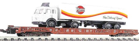

I'm putting together an ÖBB "Rollende Landstraße" train which should look perfect on my Swiss/Austrian layout in the mountain valleys around Innsbruck because the prototype operates between Vienna and Feldkirch (near the Swiss border) and so crosses the whole of Austria:
using the Fleischmann waggons 8270 A1 (end low loader) and 8271 A1 (middle low loader):
but I don't like the feeble articulated trucks that come with the Fleischmann DB version of the rolling road:
Can I therefore ask for opinions from fellow modellers on which articulated lorries I should use, in terms of not only accuracy and suitability for Austria but more importantly in terms of which manufacturers produce the most detailed / reasonably priced / widest selection of models etc. because I'm not really sure who the manufacturers are?
I know lots about the 1:160 train manufacturers (but it seems only Roco used to make N scale lorries?) but nothing at all about 1:160 vehicle manufacturers! The lorries must be to scale because I imagine 1:148 or 1:150 could be a bit of a squeeze to put on the rolling road waggons! (And would snag on the catenary, if I ever get round to making some!)

He recommended Herpa 1:160 trucks very strongly. Whether there are Austrian designs as well he didn´t know by heart, from his recollection, he said yes there are.
The latest release was a chrome-plated tank truck, with a few add-on parts (German style
) to be placed on the truck by the buyer.
I´m not sure whether I´m allowed to do so, but since Goedel speaks German, there´s a German forum dedicated specifically to N gauge at www.1zu160.net. If I´m not supposed to name this link, would the webmaster please feel free to remove this part of the post. However, N guage vehicles had been discussed at nauseam there (according to my gf´s dad, anyway).
I can't answer your question but just want to say that my wife rather likes the lorry trains we have seen passing through Spiez and Thun on their way to and from the Loetschberg tunnel in the Bernese Oberland. I guess one day there will be one running on my OO 1950's steam west Yorkshire layout, but only if she's buying....
Hi Goedel,
As ME 26-06 says Herpa do some N scale road vehicles, as do Wiking, Busch and I believe AMW and Rietze, Its a shame you don't need HO ones as I could easily supply a few of them.

QUOTE (ME 26-06)He recommended Herpa 1:160 trucks very strongly. Whether there are Austrian designs as well he didn´t know by heart, from his recollection, he said yes there are.
QUOTE (BRITHO)As ME 26-06 says Herpa do some N scale road vehicles, as do Wiking, Busch and I believe AMW and Rietze, Its a shame you don't need HO ones as I could easily supply a few of them.

At, last they have arrived! Here is an example picture of what may be achieved with Herpa trucks:
Looks good even when unweathered and I should soon have a rake of 10 to rola with...
...Herpa please release more truck designs in N scale! They're great but I need more designs, or at least a bulk load of the blank ones so that I can decorate them myself...

QUOTE (ebaykal @ 22 Jun 2007, 21:07) <{POST_SNAPBACK}>
Thanks for that picture Baykal - I thought all the Fleischmann DB versions came with feeble Wiking trucks but that Hoffmann truck is definitely Herpa - I'll have to buy it for the truck and then sell the DB RoLa wagon!!
They do couple quite closely as you say, with the special clip that can be seen on the left of the picture. The wagons don't have a kinematic close coupling mechanism because there isn't any room - the wagons are so low down in order to fit the top of the trucks safely under the catenary.
It seems that Fleischmann have re-released the same DB RoLa wagons with some new wagons to replace the more old fashoned trucks used before. So far I have found these Herpa truck ones:
Fleischmann 8272 available 2007-
Fleischmann 8277 available 2003-5
Fleischmann 8279 available 2005-7 (same as above)
If anyone spots other Herpa trucks uniquely available via Fleischmann then please do post them here! The more the merrier, and the more prototypical...
