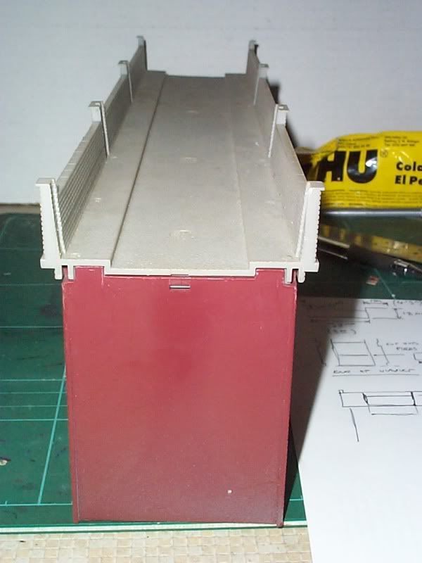

Tri-ang Hornby Viaduct...
More another time....
Hi Sarah,
That hornby viaduct was really a great fit for the canal, & cornflakes box does an ideal job. Looking really good. What are you thinking of modelling the water in / with ?

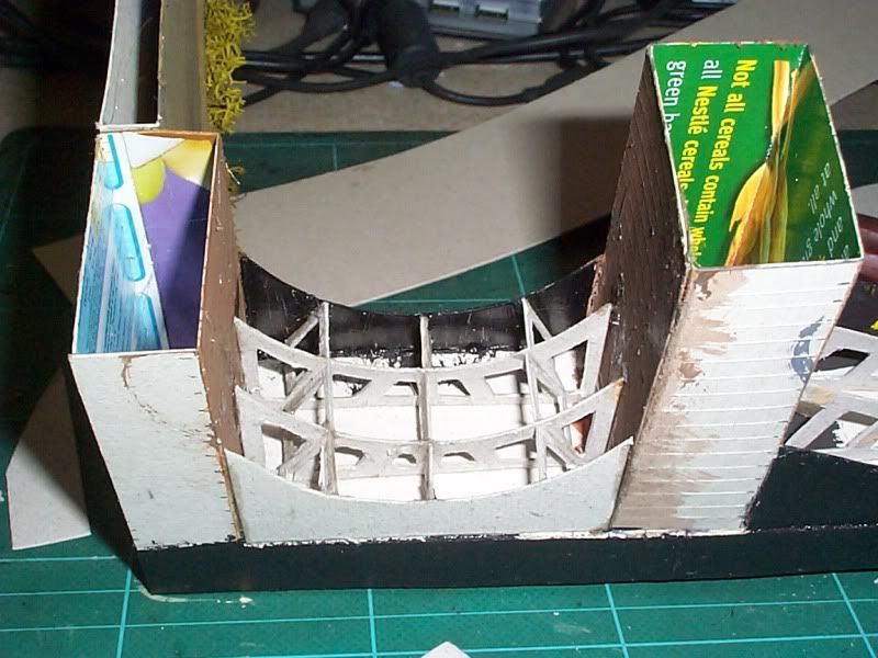

I have now added a couple of test bits of timber as toepaths on each side of the central waterway, at the moment given the 100mm overall width of the kit, I just through the size of the timber have split it into a 40mm channel with two 30mm toe paths. But think I may reduce one toe path by 15mm or so & add this to the channel / canal width - would this stack up dims wise to the real thing ? As a model I think in my un educated waterways mind, it would not look too bad LOL !! A wip pic below;

The Aqueduct at Ffrwd (The model one!) is basically one span of the Pontcysllte Aqueduct (45 Feet Span) with a shorter span over the road.
All this talk of Aqueducts has inspired me to at long last put the rest of the girderwork in place on the Ffrwd Aqueduct.
The Trough is 11Feet wide, with the Towpath built on top of a "girder" structure. The result is that the flow of water tends to pull the boat towards the towpath.
There are holes in the top flange of the "outside". These were for the "missing" hand-rail, which was not fitted to save some money it seems.
Chirk was originally just an Iron Base Plate, but at some point Iron Sides were added to make a trough. There isn't as much space for the water flow, and boats are slower going up towards the tunnel and Trefor.

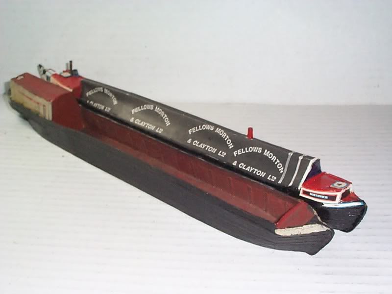

The Narrow Boat model is a detailed and customised "Craftline Models" Balsa Wood kit. It has been around for a while, but I have only very recently dug out the box with some canal bits in.
This boat represents one of the Motor Boats of Fellows, Morton & Clayton Ltd., in the "later" colour scheme. (The full size boat was built in the 1930s.)
FMC were independant traders, and lasted until the Waterways were nationalised. That year they made their first trading loss, and sold out to the BTC, Docks and Inland Waterways Executive, known better as British Waterways. The FMC boats were slowly intergrated and re-painted into BW livery. This model boat must be due for a re-paint soon...
The "end of the Aqueduct" has yet to be constructed, but it will have to be "cut off" at the board edge.

I also have done a bit of searching for narrow boats / canal boats & othe suitable craft; & at the moment am leaning towards the Langley kits (* but they are white metal - would be a new venture for me !!!!!) for all ie Viaduct / Aqueduct & a couple of different models inc. maybe a tug in the basin; but these without covers to be being loaded, or that sort of thing in the basin, or the Mountford Covered Barge for the Aqueduct - which looks similar to your FM&C boat. So I think a plan is coming together, thanks in the main part to your boundless knowledge - which again is very much appreciated.
Anyway enough of my ramblings, I still think your "Iron Bridge" model (* with the cornflake boxes - of course I didn't spot them - LF&T LOL !!!!), was another great example of your scratch building skills. Are you intending to find a home for the latest hornby viaduct / aqueduct on your layout - hope so ?

"Tugs" were never that common on the Canals. They were mainly used in areas with long lengths with no locks, so that they could tow "trains" of un-powered boats. Most common on the Birmingham Canal Navigations, or BCN, where they towed trains of boats from the collieries to power stations and steelworks. amongst other traffics.
Most Tugs were shorter than the full length narrow boats, 50 and 60 feet not being uncommon, and usually had a back cabin, and a large engine room (Housing a large engine! Some were large lorry engines.), with the rest of the length being secked over.
The Tri-ang Aqueduct is an experimental model....
