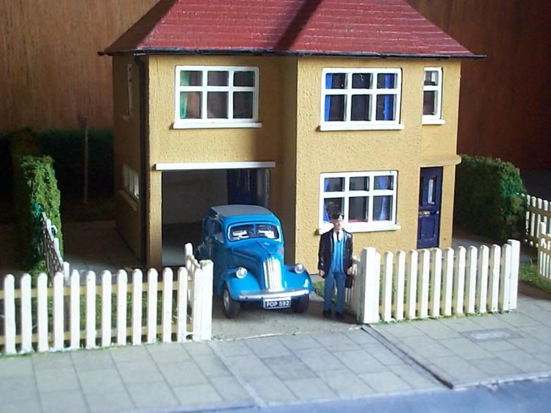

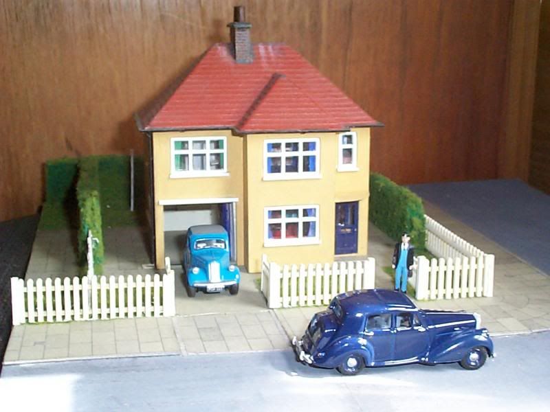

The Dapol House Build Continues...

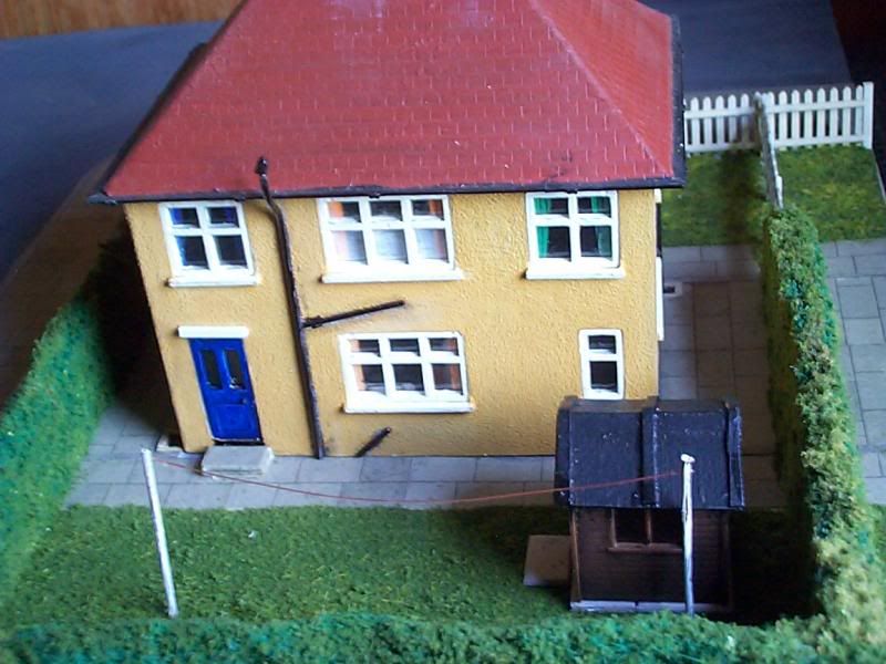

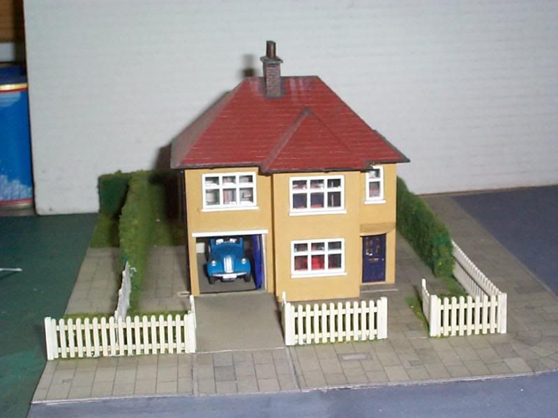

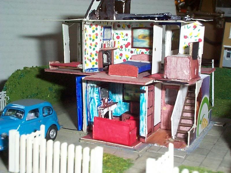

I have "completed" the interior on both floors. Well, I have put in all that I can for now.
The fold back garage door is in place.
The drain pipes for the kitchen sink and the WC and Bath/ wash basin soil pipe are in place.
The garden shed, on a foundation of paving slabs is in position.
Some small details awaiting, such as road name plate, house number, and....TV aerial.
I have actually now added a house number. An easy one...No.1. (But only after these pics were taken...)
Now I need to think up and print out two road names for the corner.
And add the bins, and a coal bunker....etc. etc.
Piccy Time...
The Interior...
Ground Floor...
Almost all made from various cardboard, paper, parts of some railway posters I had printed ages ago, and various marker/ Felt Tip/ etc. pens.
Both Floors...
The complete house without curtains...
And with curtains...
The Garden Shed.
Basically a shortened Wills Garden Shed (2 in the kit, but they are a bit long. Ideal railway sheds in fact!
) with a card and paper replacement roof.
With a bike...
From the Wills Cycle Shed Kit...
The drains in place, and the shed, etc...

Love the house - it really does look very Wrexham.
And that Bentley passing by - wasn't that a very famous photographer of the old Somerset and Dorset?
LF&T
QUOTE (Long funnel & tiresome @ 27 Jul 2013, 13:57) <{POST_SNAPBACK}>Love the house - it really does look very Wrexham.
LF&T
Thanks...
And, well spotted. Ivo called in for a cup of tea with the Loco Driver and his family.....
Neat. I like the garage doors for some reason. And were the rear drains moulded into the plastic or added by you. Cheers
Hi Reddo...
The drains are plastic rod, added by me.
Thanks.
The garage doors are based on some I saw in Bedford...
Evening Sarah,
Thanks for updates,in' pics...........
Have not seen a pic., with the garage doors in the closed, pose, or have you glued them in the open pose,,,...s'pose

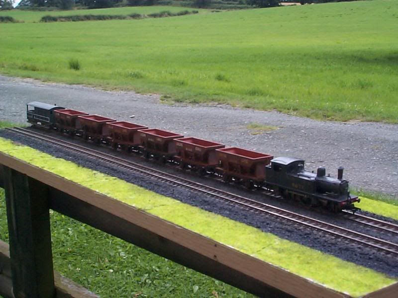

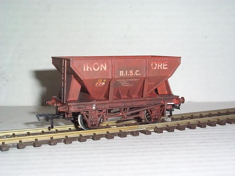

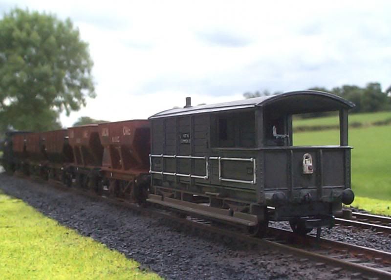

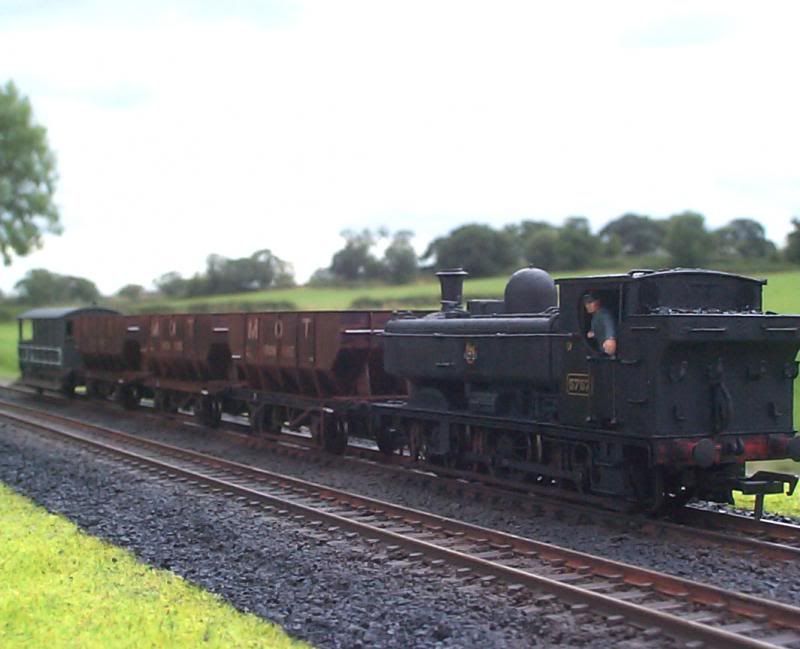

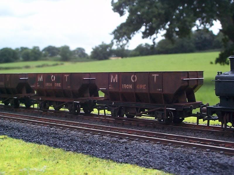

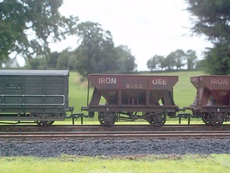

Well, I have, for a change, been doing some work on the wagon fleet for Ffrwd Locks.
The Iron Ore Hoppers
There is a batch of 6 British Iron and Steel Corporation (B.I.S.C.) hoppers. 3 are the original Mainline models, but fitted with the later Bachmann Chassis with the brakes in line with the wheels, the other 3 are the Bachmann issued version.
All have been weathered, and tiebars added between the axle boxes. The numbers have also been changed, except for two, one Mainline and one Bachmann, as these had different numbers...
Also "done" is a batch of 4 B.R. Grey Iron Ore Hoppers (The same type as the B.I.S.C. Hoppers). These are all recent Bachmann models, including the 3-pack from Modelzone. The fourth was a later type, but the lettering has been changed to an earlier style.
These have also been weathered, and tiebars added between the axle boxes. (More weathering in the case of the Modelzone wagons...)
Finally, there is a batch of 3 Ministry of Transport (M.O.T.) Iron Ore Hoppers. These are the Long Wheel Base "21 Ton" L.N.E.R. type. All three are the original Mainline models, with the numbers changed on 2 (bodged) and weathering.
Weathering consited of Humbrol and Revell paints (Tan, Leather, and Matt black paints) and Humbrol weathering powders. (Iron Oxide, Smoke, and Dark Earth). Also used on one wagon was some ground up red oxide coloured artist's pastel.
Oh...and all the wheelsets are now the later all metal (insulated) types, spoked for the B.I.S.C., and disk fort he M.O.T. wagons. (The B.R. Wagons already had metal disk wheelsets...
