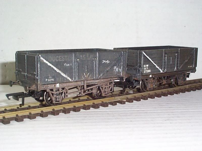

A few more pics...
The few more pics:

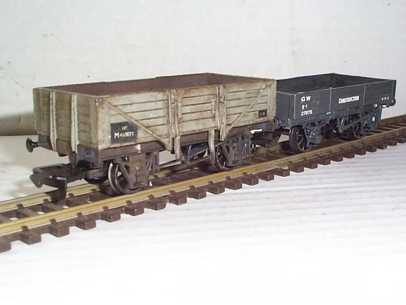

Hi Sarah,
The outdoor pics of the excellent weathered Ore Wagons - are just "Stunning"; a real pleasure to view.
Many thanks,
Norm
PS. I would not fancy taking the same pics on a windy day - plank balancing & all that LOL !!!!!
Hi Norm...
In fact it was a bit breezy when I was taking those piccys....If I hadn't had a loco attached, the wagons would have blown off the end of the tracks!
I need to make some brackets to hold the plank shelf more securely. Then I could put it in some different locations on the fence...
I have been working on a few more wagons and vans, including replacing some chassis (Mainline) with better ones with the brakes nearer the wheels (Airfix/ Dapol/ Bachmann) and some transfers, varnish, weathering etc.

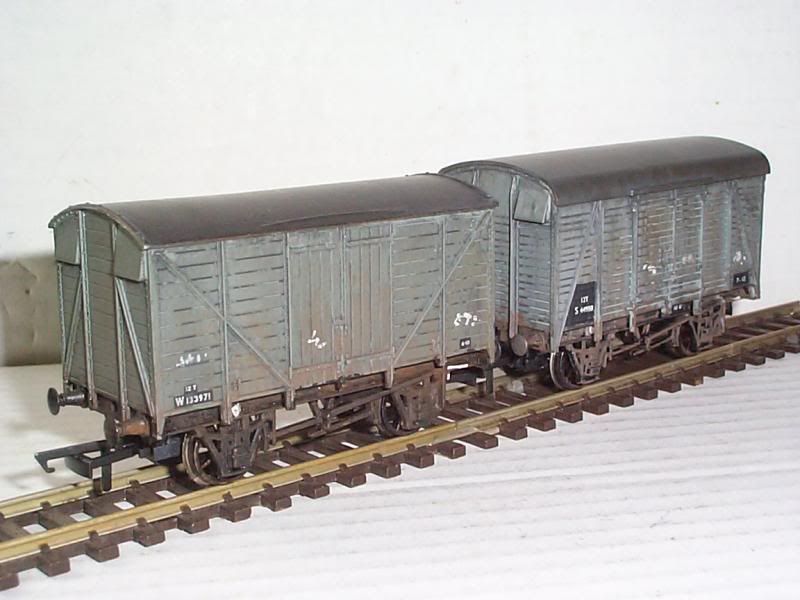

Some recently worked on wagons for Ffrwd Locks...
Click the links to go to the photos....
Ex. SR Unfitted Van 1
Ex. SR Unfitted Van 2
GWR P.Way Dept Wagon 1
GWR P.Way Dept Wagon 2
Ex. Gloucester P.O. Wagon 1
Ex. Gloucester P.O. Wagon 2

Very nice work there Sarah,
Delightful light touch, as suits the scale .....
I was bit concerned to note that there were a couple of dirty little waggons left next to each other .......
You're not thinking of developing into N gauge are you .........
