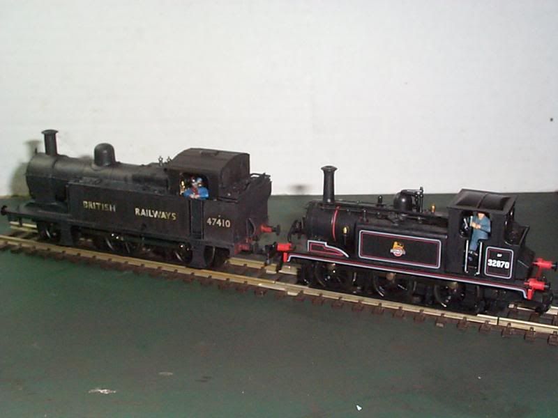

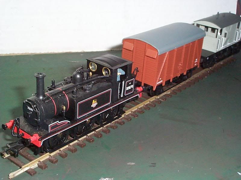

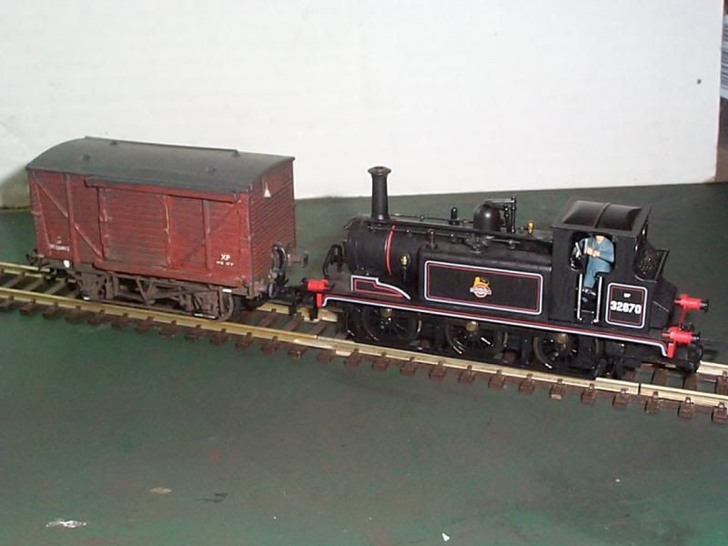

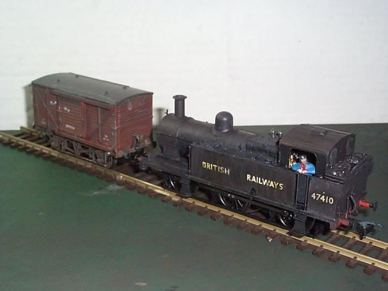

The Bachmann 3f "Jinty" 0-6-0T now just about finished...in BRITISH RAILWAYS livery...
A couple of vans...
A couple of Ex GWR Toads...
And a fitted example...(Ex Airfix GMR grey one..)
Bachmann SR Queen Mary...

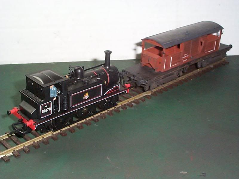

Hornby Terrier and Bachmann "Pill Box" Brake Van
etc..

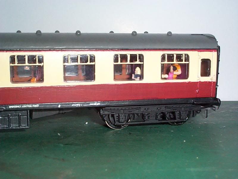

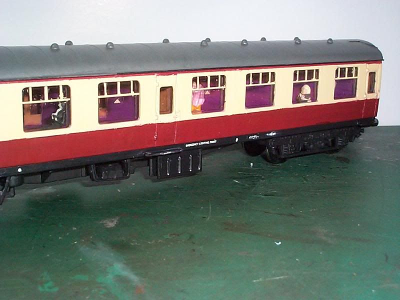

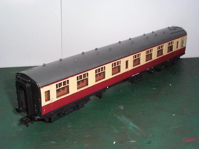

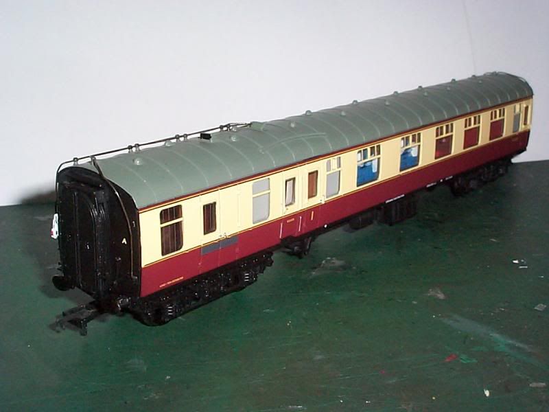

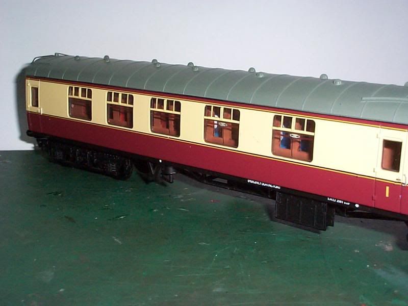

No prizes for guessing the origin of this BR Mk1 SK....
Re-painted, metal wheels fitted, and a few passengers added...
http://img.photobucket.com/albums/v489/sarahagain/Ffrwd
/DCP17734_zps97e1c930.jpg

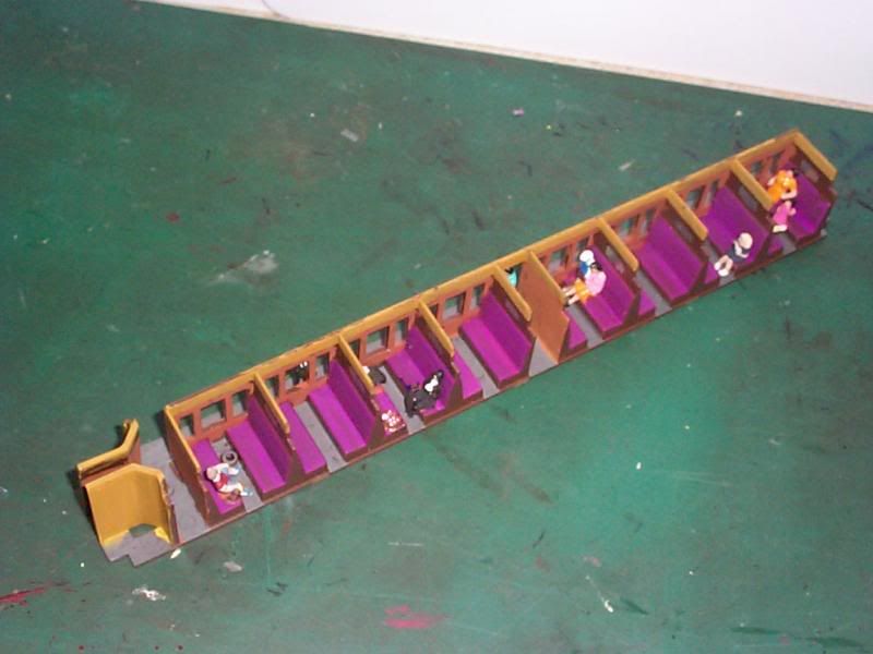

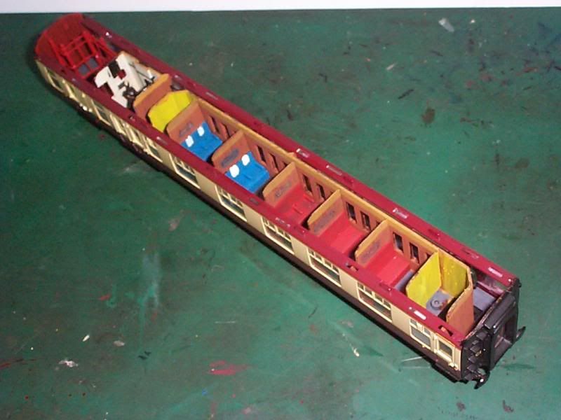

The interior...

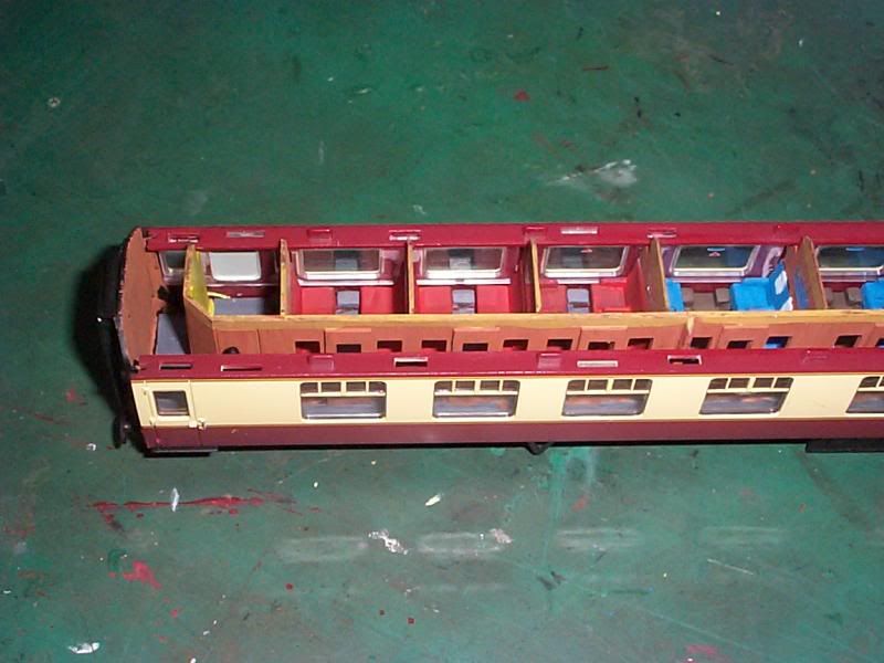

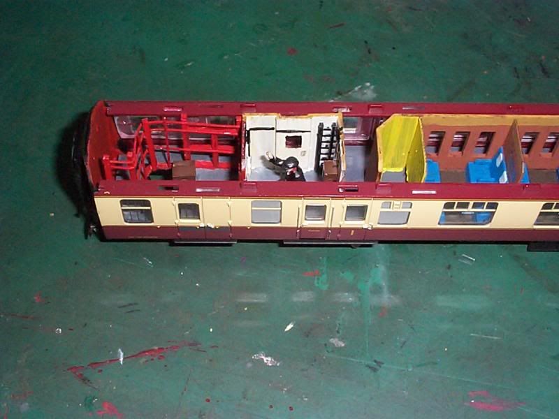

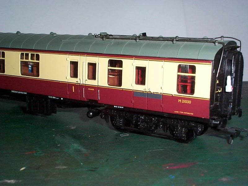

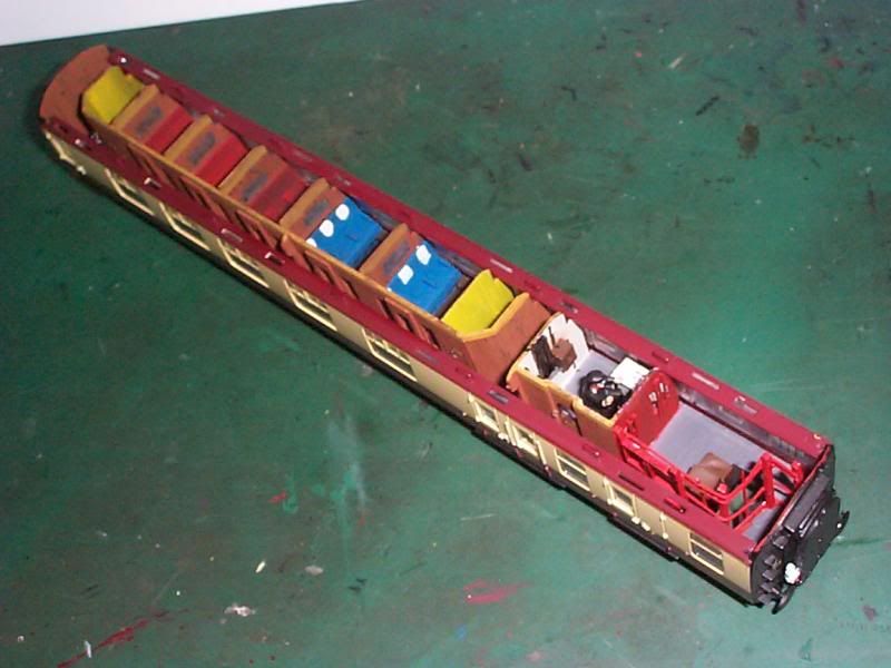

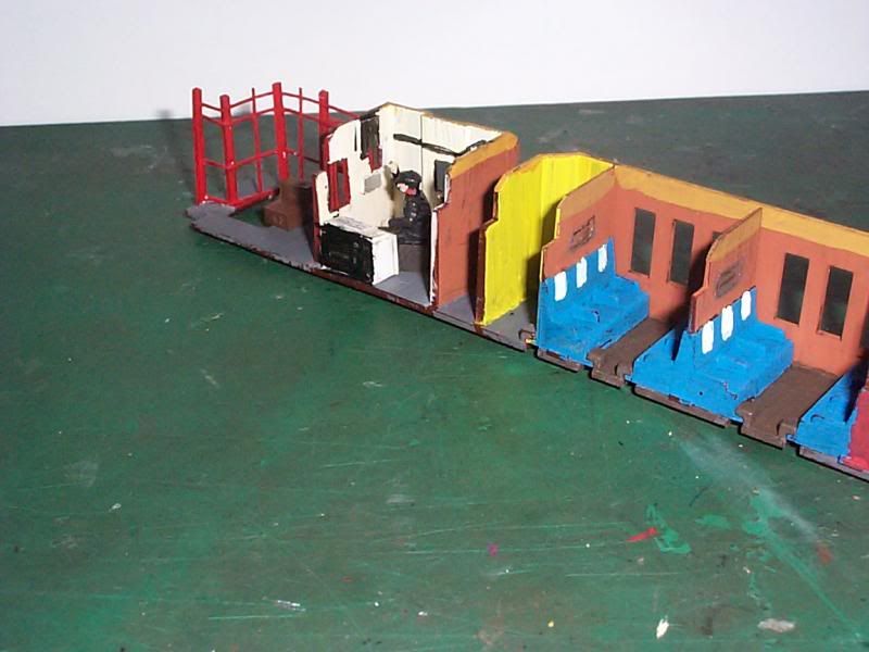

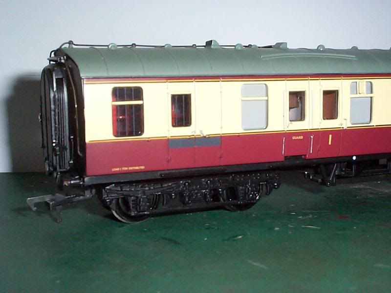

To go with the "Partwork" coach from Hatchette I needed a Brake coach.
This Bachmann BCK was second hand, and needed a buffer and a little TLC...but got a bit more, including a re-worked "cage" in the brake part.

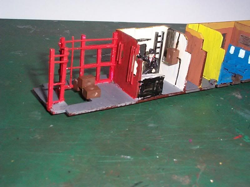

Inspiration for the interior of these two coaches comes from the PECO interior kits made for the old Kitmaster Mk1 kits...
The guard is a Tri-ang Railways Driver!
The "cage" that was removed. Solid!

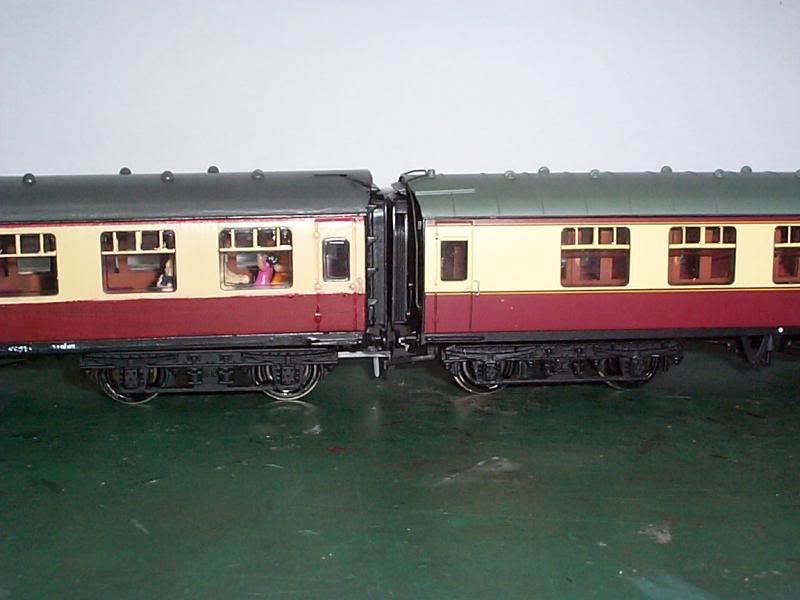

The two coaches together...

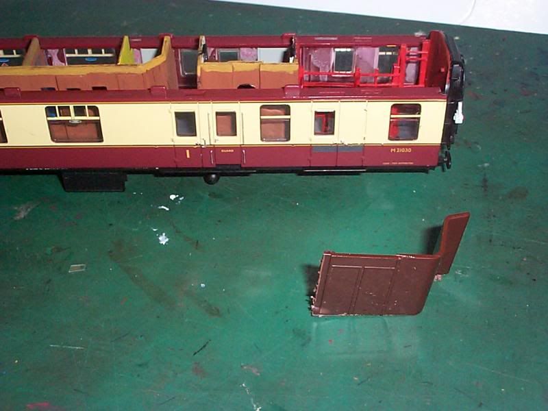

The Hatchette Mk 1 SK dismantled...
(Most of these photos were taken after the re-paint work...)
The bogies are "clip fit" like old Hornby coaches. The clips can be fragile, so proceed to lever them off with care!
The Bogies removed...
The close coupling system revealed after carefully prising off the clip in bogie...
Carefully moving the close coupler to one side reveals one of the three fixing screws, that hold the body in place...There is also one in the middle of the coach, and of course another under the other bogie...(Posed photo, the body is off in these pics!)
The screw hole with the screw removed..
The underside shewing the middle screw, and one end screw (Close coupling unit removed.)
The underside. all 3 screws removed. (Close coupling units removed.)
The bogies shewing the clips...Replacement Hornby Metal wheelsets installed. (The bearing holes may need easing slightly. A job for a special tool, or a small hand drill...)
After removing the 3 screws, which screw into the interior unit, the body can be carefully removed from the chassis. I have marked the "Lav" end of the chassis, so it goes back the right way around... Note the metal weight.
The body with the roof removed. (clip fit.)
The roof...above and below...
The body sides, outside and inside...
The roof and body sides shewing the locating clips...
The interior unit...
The chassis underside with the body removed.
For the re-paint, I removed the glazing. This is pegged and glued in place, but the glue joints can be broken by carefully prising the glazing away, a bit at a time...
[img[http://www.rmweb.co.uk/community/uploads/gallery/album_2911/gallery_12119_2911_129094.jpg[/img]
The window ventilators are moulded into the glazing unit, and can be painted carefully before re-fitting the glazing...
The almost finished (Requires numbering...) coach...
