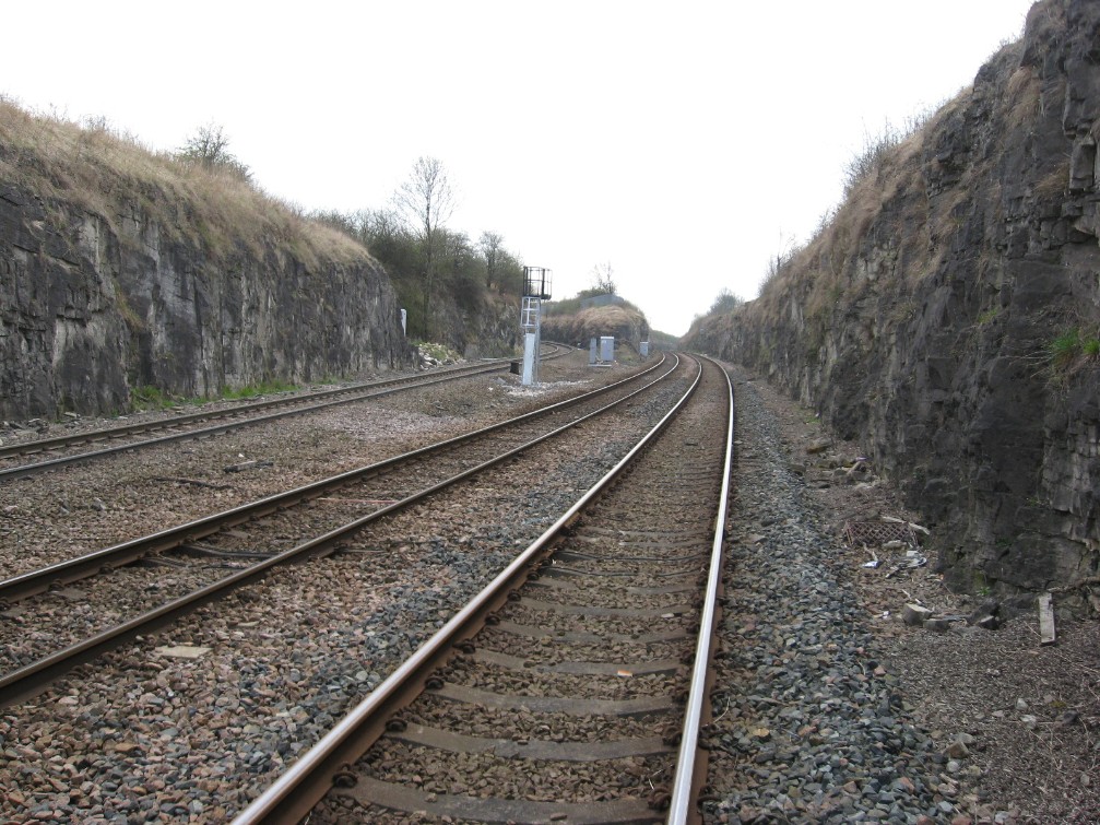

The only rusty coloured rails (in the diesel and electric era) were those that were hardly ever used. Predominantly, on electric lines the rust tended to be overcome by brake dust giving a rich more brownish colour (at least on southern lines close to things which slowed trains down like signals and stations) whilst tracks which were used by diesels had oil deposits with dirt attached. (The space in between the rails was also stained black; quite often unevenly to one side but I'm not sure why this happened.)
If modelling the third rail conductor then these were often black or dark grey in colour - I suppose from carbon build up.
I don't remember steam days to well - but I doubt they were an even track colour that we see applied to some layouts given how steam trains leaked water oil and coal.
Unfortunately, most colour photographs concentrate on the trains and the surrounding infrastructure - not very good when we need track details.

The only "real" way of successfully weathering track in my completely biased opinion is to do a little at a time. The appearance of track is extremely complex close up: I have the scars to prove how close up I have been at times. (I broke a couple of ribs at Crewe and bashed them back into place near Northwich a week later
. This was a bit too close).
From a moderate distance (say an ordinary height overbridge looking down on the track at about 30 degrees) the whole lot tends to blend together.
One thing to be decided therefore is whether one wants the detailed or the blended look?
There is a whole host of questions in addition to era. Location, season, traffic and even recent weather are three broad areas. Drainage - good, indifferent and/or bad is another factor that I'm always on about.
Location is the big issue. Where is the track? Industrial, urban, suburban, rural. Even rural brings up some surprises. The track can be very green if wind blows seed onto the ballast and humidity allows it to germinate. Salt (usually along coastal tracks) is another factor. One place I knew in Cornwall as a kid had weird desert specialist plants happily growing in the 4foot. The micro climate of a particular cutting was just right for them. How they got there is anyone's guess.
One thing that I am increasingly inclined to do is to mute the colours added over the basic ballast colourS. Up close diesel/oil spill can be pretty black but the way that light refracts tends to edge it into greys. Water on top of oil-fouled ballast can actually reflect a bright blue sky... That should be fun to model!

Bear makes some very valid points which highlight the fact that rail colour is part of the wider topic of weathering and the environment.
The first point to correct though, is that rails are only rusty when they are not used. This normally starts occuring on the rail head first and progressively works on the sides.
Rails which are in use are a combination of the environment colour, grease and brake dust - mostly the latter.
In my opinion, most people paint rails with far too much 'orange' when in fact, it is more of a brown/grey tone and it does vary depending on the location (countryside, city, urban etc) and the country - it's a very different colour here in Aus to what it is in the UK. It also varies depending on the train braking systems used - different types of brake blocks and pads produce different debris. Traditional brakes blocks of the type used in the UK in the 60's used to produce a lot of highly 'magnetically sticky' ferrous dust which gave rails their appearance. I believe that modern brake pads have been based on asbestos (progressively moved to equivalent products for health reasons) and therefore produce completely different dust and less of it.
I don't find any of the commercial paints to give suitable colours for rails, therefore, I make my own. I use a completely unscientific mix of Humbrol 113 (Matt rust) and Humbrol 33 (Matt Black) which is about 4 metric parts 113 and 1 part 33. Probably best to show a picture of the resulting tone:
http://www.mrol.com.au/Articles/Weathering/Weathering5.aspx
The key factor is that subsequent mixes have slightly different variations in tone - consistent with Bear's 'little at a time' approach.
