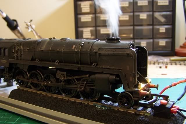

A couple of weeks ago I discovered the smoke unit in my Brawa BR 19 wasn't working so I installed a brand new one. It worked perfectly as you can see from the photo below. At the weekend we were having a bit of running session round at my mates house so I took it along to show the guys as they hadn't seen as smoke unit before. My mate has a NCE powercab system and the loco seemed to function fine sound, motion and light wise although when I pressed f4 for the smoke generator to work nothing happened. I spent some time faffing around with it and notice when I injected the smoke fluid in there would be a very tiny whisp of smoke but not the continuous stream of thick smoke that I normally get when I use it on my ECoS system.
I thought maybe a connection had come loose so when I got back home I was ready to take it apart to check and see what needed to be done. I fired up my ECoS first to check that it wasn't working on my system too and lo and behold it worked perfectly straight away.
Does anyone have any ideas why a smoke generator would work on an ECoS powered system and not on an NCE powercab?
I'm baffled. My best guess is that the voltage on the Powercab maybe too low at 15v but this is just my speculation. I am interested as I can't see why it would work on one system and not another.
