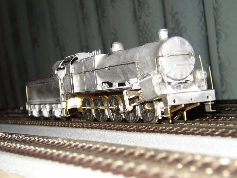

Thanks, I've still got a few things to add, like valve gear, buffers and couplings. The DJH valve gear is supposed to be riveted but I'm having trouble with the solid rivets supplied and iIve run out of hollow ones so I'm using 16BA screws with the heads thinned down. The buffers supplied are shockers so I'm going to try and get a sprung set when I'm in Sydney next week same for the couplings. Apart from that I'll sort out the pickups and add the beading round the top of the tender and fit some new steps to the back of the tender as it doesen't have enough for BR days and fit the head light The Garrett uses etched brass brake gear and it's little finicky to fit and from time to time it touches so it's on the bench to have it all removed and remounted and hopefully it'll stop shorting out.
A front end shot of Big Bertha,

QUOTE (Makemineadouble @ 9 Nov 2006, 21:40) <{POST_SNAPBACK}>I'm impressed with the Lickey Banker (Big Bertha) the Garret too photo's add a lot of intrest
