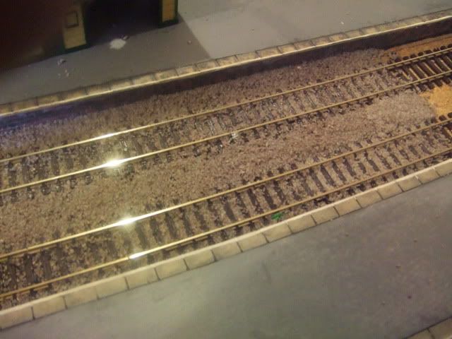

Tonight I decided to do a little test area to see what it was like. I did it all by the book 50/50 pva/water and a dash of squeezy. A little syringe to apply the mixture and a little brush to push the gravel into the right position. I also used a wooden tea stirrer from a certain fast food company to tamp it down.
I found that when I applied the pva it still sat on the top (surface tension I believe) but if I dabbed it with the brush it mixed into the gravel quite well but then I found I had to re-position the gravel as it began to clump. I'm definitely a novice at this one. However I do believe that I got it right eventually. I will take a pic and post in the morning when the pva has dried and cleared (I hope).
So yes the novelty has worn off already. This is one job I'm not enjoying.

*** Try it this way. Its really no big deal and can be relaxing if you take your time and put on a bit of good music. It takes hours to do a whole layout of course but they don't need to be unpleasant if you use the method below.
The glue:
mix 1 part glue with 2~3 parts water, then add about 2~3 parts meths and shake really well. 50/50 is often mentioned but its plain wrong... It is far too much glue / like making concrete!
DO add and mix in the water before the meths and if its really cold, wait until it isn't to ballast (or warm up the trackage / room for a couple of hourrs and warm the water mixed into the glue as well). Leave the heater on for at tlast 3 hours after spreading glue too.
Spread and tidy the ballast. stay 2 sleepers away from point tie bars (we can do that bit later). Tidy up the edges too. if you tidy up as well as you can the edge still looks "prototypically ragged" but if you don't it looks like a disaster.
Rather than too much, apply ballast steadily and sparingly a soup spoon at a time and spread with the fingers. When spread properly, tap the rail gently with the back of spoon (just letting it fall uner its own weight when held between two fingers and it'll bounce particles away from the rail and settle the ballast between the sleepers.
Be fussy - 2 added minutes per foot to make it tidy is worth the effort. Don't use a brush - it always flicks ballast everywhere!.
squeeze a cotton bud really flat with pliers and put a wee bit of vaseline (onloy a wee bit) on it. rub that between the point blades and the stock rails for the last 30mm of the point blades. That will stop stray glue sticking them and can be left or wiped off later.
when its ready put meths in a window cleaning spray bottle and from far enough away to no blow the ballast give it a goot wetting wit the meths. Just do a few feet at a time... don't try to do too much at once!
re-shake the glue (in a plastic sauce bottle with a small cut nozzle is good) drip on the glue. not too much is needed. It goes a long way and flows surprisingly far.
Most will just soak in to the "meths wet" ballast immediately!
when glue is spread, the re-mist with the meths - the rest will soak in.
Now, get a bit of pine offcut and dip the end into a bit of meths. rub along the rail tops and this will remove the worst of any glue accidentally dropped there. be careful but press down slightly as you do it
Now.... walk away and don't touch until dry, even if you see a misplaced bit here and there... Be patient! It will dry quickly because of the meths, will not clump and will be nicely matt in look - and firmly held too.
When dry, run a fingernail along the inside of each rail and then rub any mischievous bits off sleepers or anywhere it shouldn't be.
quietly and carefully vacuum up the excess.
Now. those last bits by the point tie bars. Get a stiffish fine brush. dip in neat PVA and paint the area between those sleepers. Not too much!! Now add a pinck of ballast and tap it down into the glue. wait several hours and vacuum off excess...
Job done.
Give the rails a bit of a clean and play trains
kind regards
Richard.

I ditto what Richard has said on ballasting.Once you practice and get used to it, it even becomes enjoyable. I never used brushes. Its a pain. Catapults all the tiny pieces all around. Instead its the forefinger, gently taping. What ever you do, however you go by the books that surface tension will always be there and small bits of ballast will end up either on the sleepers or rail tips.Then again your forefinger comes into the play again.Since the ballast is wet now any loose bits and pieces sticks on the tip of your finger, a good way to get rid of them , just like a magnet so to speak.
...and by the way use fine ballast, never medium and be sure its granule some sort of rock or stone.They tend to be heavier and resists the tension while others like Woodland, Noch love to float.

Thanks guys for the comments and the advice. I did indeed end up using the forefinger as you say Erkut but surprisingly I found the thin wooden tea stirrer to be a great tool as well. It was good for tamping down and scraping bits away. I was also amazed at how much got into my mouth. I wouldn't say I was particularly messy with it, but I found myself grinding my teeth on a couple of bits a few hours later. I felt like I had a sandwich at the beach.
I will look for some Meths today, although I don't know how available it is in the UK any more as I have not bought such a product in an extremely long time. I'm going to Braehead shopping Centre today, there's a Boots there. I'll check it out. I'll probably have to sign something. I'll also add more water to the mix. But just to be sure I'm getting this right. Do I add the meths to the Pva or just meths to water separately to wet the ballast before gluing?
You're most likely to find meths in any decent hardware store, or if your lucky, in outdoor shops

Sorry for the long wait for the update but life caught up again. Still been doing things though and the ballasting is coming along at an amazing snail's pace. My idea was to pre mix the ballast in a tub with the pva and spread it like plaster. This idea actually works not too bad in the larger areas and is a little speedier. But it isn't very good between the sleepers. I've found that if I drip spots of glue between the sleepers then sprinkle the ballast it tends to soak better. Of course once dry I take a small flat blade screwdriver and chip off any bits that are on the sleepers or stuck to the rails. A bit of an arse for elbow method but it's working and I'm not complaining. Here's the pic:-
