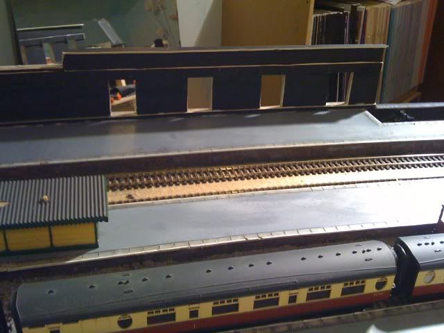

Just a wee update on the station. I have begun cutting & scribing the mounting card and glue some in place this time with good ol' PVA. As you can see by the pictures I'm starting the relief features of the wall and trying out ideas for the paint effects.
The cladding in place!
A closer view! Showing the beginning of the relief detail!
Practising my paint effects on a scrap piece!

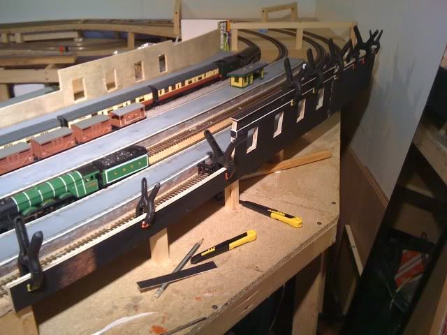

I'm happy to report some progress, I'm managing at least an hour per day at the moment and things are rolling along at a Pug's pace. Here are some more photos showing different views and progress.
I thought I would show a view from the other side!
A straight on view! Notice the leaning wall which I will fix later!
Notice the curved capping on the wall beside the track!
This was taken through the window from the front workshop showing a work in progress!

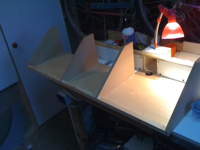

No I've not been idle again, just wanted to wait until I had something substantial to show.
The problem with a model railway is that there are so many jobs need doing and prioritising is extremely difficult. However that being said, my grandchildren have been visiting the shed a lot and causing merry mayhem, partly because they are a little energetic and partly because there are things which are not completely nailed down. Namely the Control & point switches, and the main controllers. They have landed on the floor more than a few times no matter how careful I have been.
So with that in mind I decided to house everything within one unit and it will be clamped to the layout. Having lots of scrap wood in the shed from previous projects I decided that it would cost nothing to build a Control Panel from the bits I had lying around. The size of the pieces of scrap wood also dictated the dimensions of the Control Panel. I must admit I'm rather pleased with the results, it looks a bit retro and even though it's almost a metre in length it's not too imposing in the railway room.
Anyway here are the pics for your perusal. As you can see there are still parts to be completed but the modular style in which it is built will allow it to evolve or change completely in line with the layout.
The Basic Shell
Getting some Skin
Starting to Look The Part
Some Trim To Make It Look A Little More Attractive
An Alternate View !

Thanks for the comments Guys, as to what's going in the other spaces, the small one will be getting another gaugemaster controller maybe one with inertia control and the big space is for the points and control of the station area as the other side is the points and switches for the hidden sidings in the Lower section.
Beautiful piece of construction and finish Alan but how are you going to make all the wiring connections in situ, and any retro-connections/fault finding. Maybe could hinge the panel along the bottom using piano hinge so it tilts towards you?
Hey Reddo, how're you doing? Thanks for that!
Getting into the box is fairly simple from the front as the panels will all lift off. I don't know if you saw my previous Control panel made out of an old computer keyboard for the case, well the switch panel on the left of the new one is directly lifted from that and had 2 "D" connectors fitted so basically it was a form of Plug and Play to refit this into the new panel. I still have some connections left in one of the "D" connectors but before I fit it into the layout I will install at least another one or maybe two connectors. Therefore the wiring will be already in place and I just need to connect the right wire with the right switch and no pulling out of the Control Panel should be necessary.
A cunning plan well thought through. I am well impressed with yr LH points setting panel - will be using that as a guide for mine as I prefer that system rather than DCC route setting and the expense, though the operation is DCC/Sound. I bought a micro panel from DCC Concepts at a show last year and several dpdt switches so have some of the ingredients...
