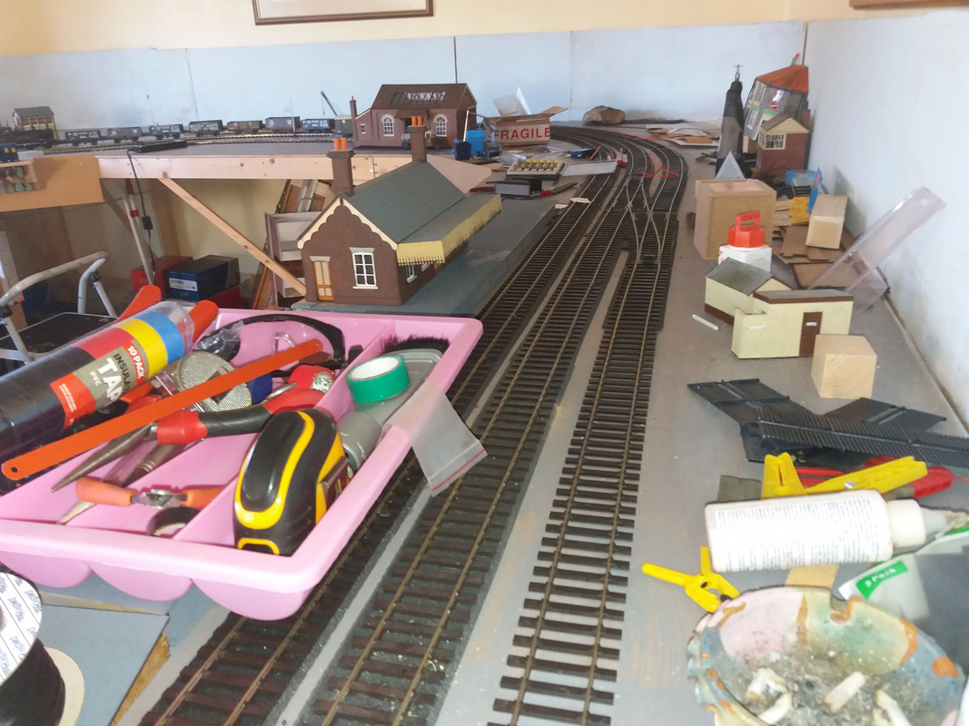

things are changing on my O gauge layout. Watery bottom is Upton Downs
I set my self of building a long retaining wall over bridge, and proper station.
the over bridge & retaining wall is build from foamex faced with embossed printed brick paper. Foamex is a lovely material to work with. Strong but easy to cut with a sharp blade.
this one shows the start of the retaining wall and station development. In O gauage even the steps up to the station building have had to be scratch built.
the retaining wall is now in place and development of the town now awaits. Although my next task will be to build some colliery buildings.
