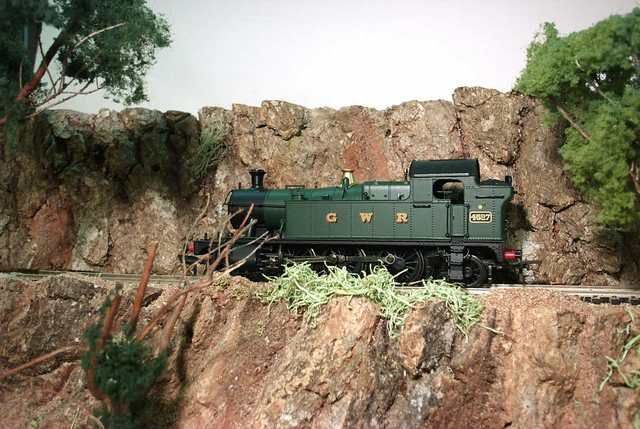

Mike's on the right track there. I've noticed that greenery in chalk is small, and tends to follow vertical cracks where the water supply is regular. I think chalk cliffs are the hardest to do, why I stick to non -chalk, it's easier with natural products such as real bark!! (such as below, really easy to do!!
