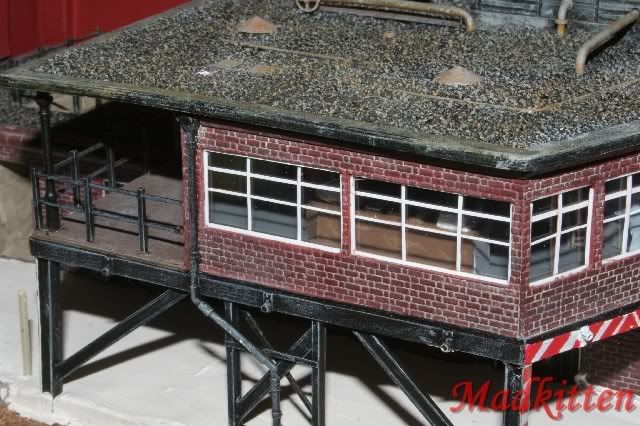

To manage to acheive a really deep colour on your brickwork i suggest repainting the entire building. First undercoat the building with halfords grey primer then paint the building in acrylic terracotta red. Then when that has dreid ( leave for about 2 hours start your washes using black first, paint over the entire building with very very watered down black acrylic. do this a few times leaving each wash to dry first. This will make the building look quite dark. Then get a creamy white / mortar colour and paint on thick into the cracks between the bricks. Only do this in small areas each time. Then immediatly get a peice of toilet paper and wipe of heavily. This will leave the mortar gaps filled in correctly and lighten the dark bricks to there correct colour. experiment with it a little and you should find it relativly easy to master!!
some weathered brickwork i have done....
Stone work using the same method and different colours...
