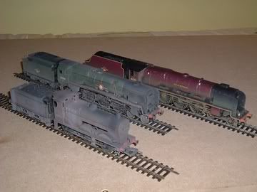

City of Nottingham (factory light weathering by Hornby)
Fowler 4F heavy weathering (by Making Tracks inc.change to late crest)
35008 Orient Line (converted,super detailed and medium weathering by Making Tracks)
My awful photography shows them as lighter than they are in real life, I personally like everything weathered,my only non weathered loco at the moment is MN Bibby Line which looks like a toy next to Orient Line !.
