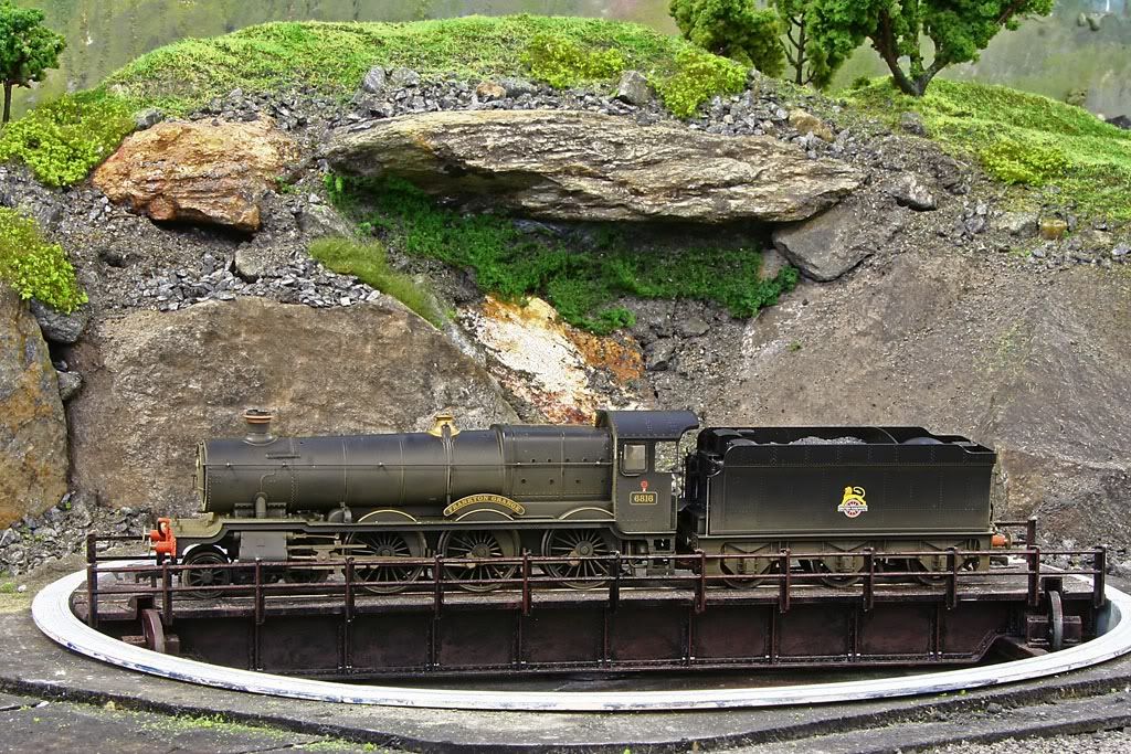

I was thinking of buying the above and wondered what other forum members' experiences have been. Does it come with electrical contacts and how easy is it to motorise?

Harping back to the original post. I used a 1/4" (6mm) right angled stereo jack plug and socket from Maplins to pivot my Dapol TT and get the power onto the bridge rails.
You can use a mono one if you just need track power and don't need any indicator leds on the bridge.
Picture here shows the jack mounted on a proof of concept aluminium bridge - http://www.rmweb.co.uk/community/index.php...able-jack-plug/

The Dapol turntable is based on the hand operated GWR designed over-girder version and thus common to that region. It's a nice static model but I would not waste your time trying to automate it. I prefer the well style turntable as it's far more typical throughout the UK and makes for a more interesting scene in my opinion. The Peco kit has contacts and has been successfully automated which I am trying to replicate.

I have the PECO turntable myself - easily motorised using a 'clearbox'motor. Also have a Heljan turntable - ready motorised. Dapol one (the old Airfix 3/- kit) is very flimsy and will take a lot of effort to motorise. I have seen them done using Meccano gearing or even old record player drives - but a lot of work involved...................
#3 ·
The Dapol turntable is really best suited to a static display and requires a significant expenditure of time and effort to make a working model (like the loco kits). I built one and fabricated some contacts from brass strip. I put it in a well made by SE Finecast. I couldn't get it to work smoothly and eventually gave up. I much prefer the Peco turntable kit that I'm using at present. Although the Dapol kit is cheaper out of the box, it's not a good savings in my experience.
